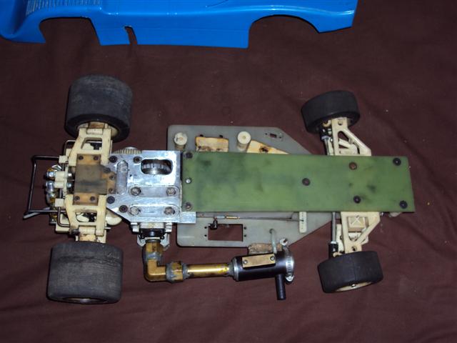

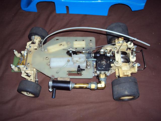

just picked this up.
team associated rc500, 2wd, chain drive, engine is a HB .21 Grand Prix.
the rest of the pics at at http://lowclasscc.net/2009/09/team-associated-rc500-2wd/

Nice pick up there, unique plumbed exhaust I might add.

ya its different from the pretty tuned pipes i see today. the jb weld has cracked but still cool lol

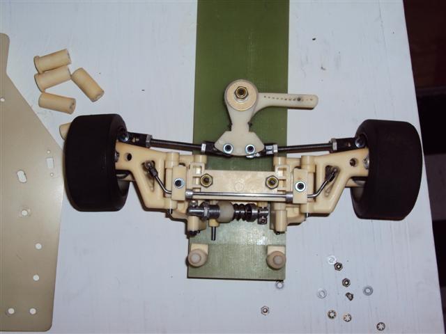

thanks for all the comments. i have the car currently torn down for cleaning. i'm surprised at how well everything is cleaning up on her. so far i have not found any noticeable scratches on the bottom. one thing i couldn't believe was how heavy this car actually is. maybe its cause i'm a 1/10 scale electric guy but damn this thing is a tank. they certainly focused on durability and not at all on weight back then. i will post pics when i have a little more done on the car.
**update**
just a quick update on the car. i am currently working on cleaning her up and doing it little by little so i can get everything perfect. the current work is on the front end. after cleaning one side and getting it back together i noticed the steering is binding very bad. i head down and check out the manual and everything looks right but i finally notice the front axle carriers have offset screw holes, thus making the right and left different. now since i have only tore down and cleaned one side so far ad the other side is still put together i know i didn't make this mistake myself. who knows how long this car has been like this but this will be something i will be correcting on the car. how bad the steering binds on this i dont see how anybody drove this thing. pics will be up at some point tonight of the progress.
**update**

- chassis plates cleaned
fuel tank cleaned
all front hinge pins polished
all front end parts cleaned
one of the shocks have been rebuilt (ran outta time)
replaced needed washers and nuts
