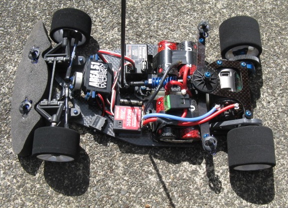

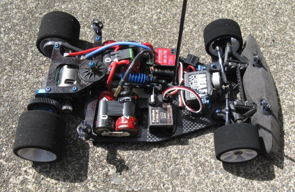

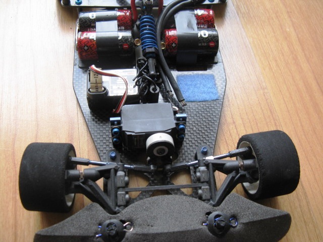

Here's an update on my little 12L4.
Went with a Futaba MC601C ESC,only $49 from Tower,nice and compact,has the ability to be programmed and data logged with a PC and handles down to 9 turn motors on 6 cells.
It fit real nice and runs my Reedy KR 10x2 with ease.
Found some Du-Bro 1/4" x 0.20" shims I had in stock and they worked perfect to space the rear wheels out.
Came 4th in my first 1/12th scale carpet race,too! :D
All The Way Alive
