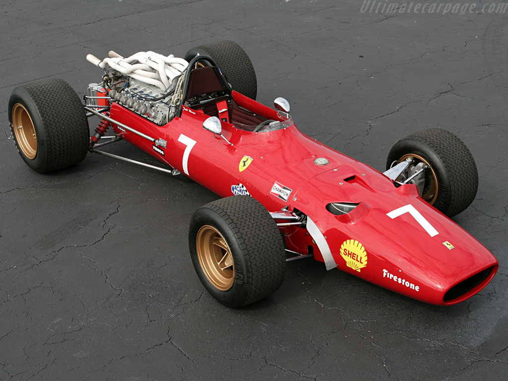

My dream RC is a 1966 Lotus 49 F1 car nitro powered but fat chance so I decided to hack together a "stand off scale" car not a replica but something that reminded me of a vintage F1 that I could bash around. Photos are of the Lotus for inspiration, the first step in the process, and the extended chassis. I bolted together two GT chassis for a wheelbase that matched the SC8 (just in case I got cold feet I could always throw an SC8 body on it.) The extra battery tray is in case I need to move weight forward for steering. Step two will be to lower the front tower and shocks. As for the body I have some skills so it will just be a matter of finding time. Wish me luck.
