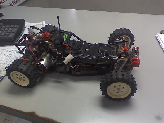

Well I've been caught up with other projects, parts cleaning and re-builds. I havent had a chance to go over the HotShot yet but thought Id post some pics of it on the day I got it:
I've torn it apart and it's all in it's own little box now. I think I got a good deal on it. Came with the LRP runner ESC, Traxxas receiver and Futaba servo. I think I got my moneys worth just in electronics. I'll keep posting my progress... It might be a slow build though.
