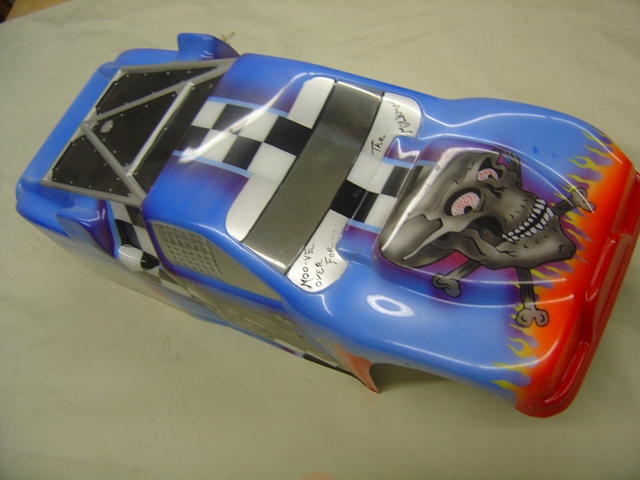

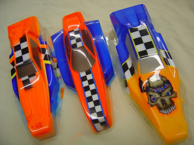

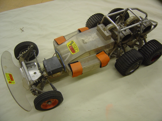

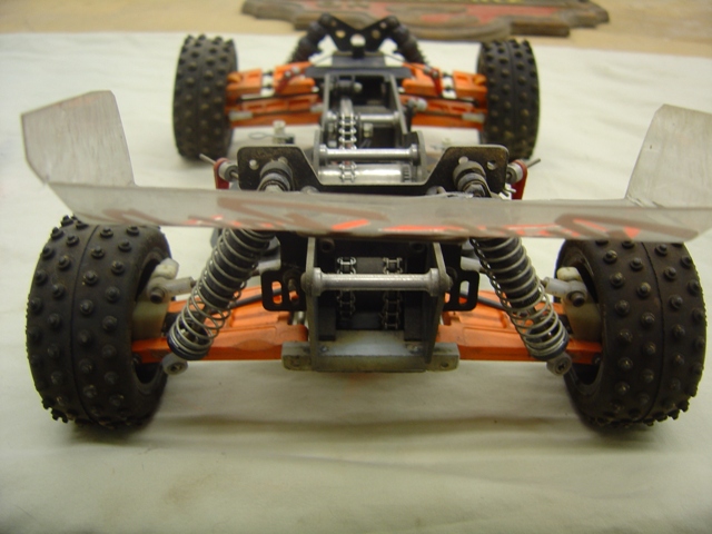

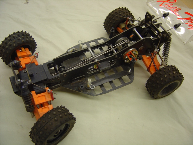

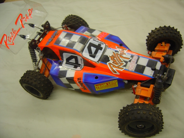

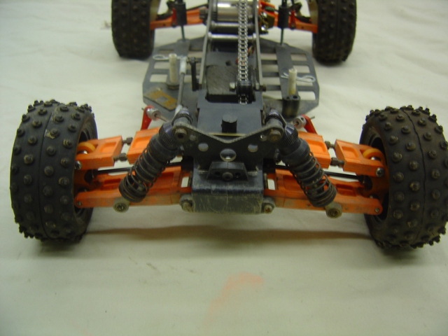

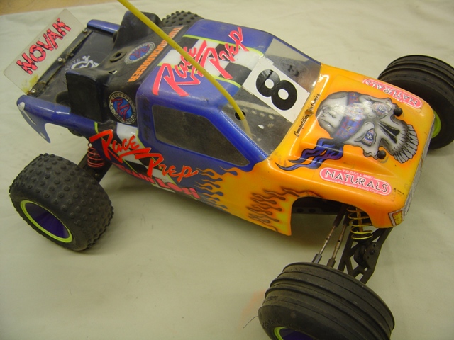

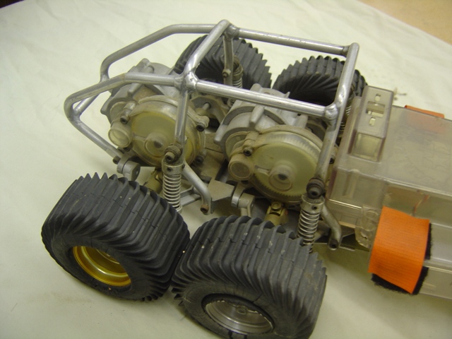

For those who wanted pictures from Mike, here ya go......

I think I finally know what to do with my box'otrash tamiya pot-metal pieces! That's just SICK!!! I wanna take that thing and drive it through Shodog's garage o' parts and polish! Any chance that'll end up on the BST Forum...(half) kidding :wink: :D

Wow! Some great pics up here yet again! Finaly a closer look at the Boost bodied Pro Radiant that I've Bern searching for. Please extend a big thankyou to Mike also.

prp
Posts: 665
Joined: Sun Dec 10, 2006 4:27 pm
Location: Lyon FRANCE
Been thanked: 13 times
Re: If you could ask Race Prep's Mike Dunn......
Post by prp »
Nice :mrgreen: :mrgreen: :mrgreen:
On the rear of the Mike Pro Radiant, he use the RC10 hub carrier and Wheels and a hand made toe in part...
Why the RC10 wheel and hub , and the hand made toe in is better than the washers with alloy post on the rear ?
Thanks for the pics :D

Jeff, I can't remember if you and I talked about this in our email exchange, but do you have access to either a new or used Pro Radiant body?

I'll take that pro radiant body in the middle :D looks sweet

prp wrote:Nice :mrgreen: :mrgreen: :mrgreen:
The hub carrier allowed for more "dogbone scrub" which basically gives more suspension control to throttle input. Makes the rear suspension more stable specially on smoother tracks.
The rear toe block was made that way just to tie things together better. Bottom chassis to side chassis. You may have also noticed the carbon fiber angle pieces that tie the bottom to side chassis eliminating the bottom chain guide.
