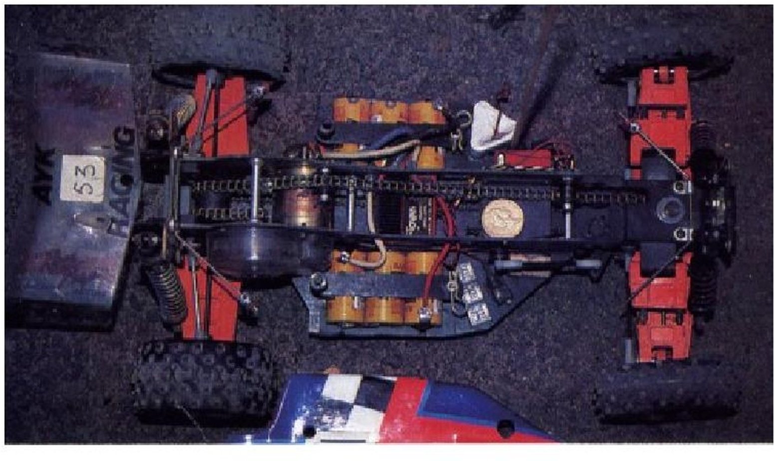

I see the "rocker" on the PRO , but on the world car, I see 2 screen on the lower shock tower ...it's the same car ,sure?
Different wing, chassis 6 cells...
Mike can make a pic below the car and how many toe in on the white rear part ?

Look at the picture of Mike's car from the '89 worlds on page 3 of this thread. Note the single screw in the center of the front tower which allowed for the rocking action.
There are pictures of Mike's cars from both the '87 and '89 worlds out there. Could the picture you posted be from the '87 worlds?
I will ask about the rear toe for the '89 car.

The pic above is the 89 world car ,take on the race in French RC magazine...and the shock tower is in front of the support and not on the rear like on the Mike pic !
Maybe he make the rocker after the Worlds

Mike can make a pic below the car and how many toe in on the white rear part ?[/quote]
back then I think it was zero

Hi Jeff , you say the white nylon part is used like chain guide ? can you explain ,
and the chain is free in the middle of the car !!!
Thanks PRP.
Thanks PRP.

In which picture? The picture a few posts above shows a chain tensioner in the standard position. I'm not sure I follow you or completely understand your question. Can you point out which post you are talking about so I can get the answer you need.

Mike says: "The rear toe block was made that way just to tie things together better. Bottom chassis to side chassis. You may have also noticed the carbon fiber angle pieces that tie the bottom to side chassis eliminating the bottom chain guide???
Mike don't use the black central chain guide from AYK, the chain is free in the middle of the chassis ???
Or the white Toe in is a new chain guide ?
Thanks
