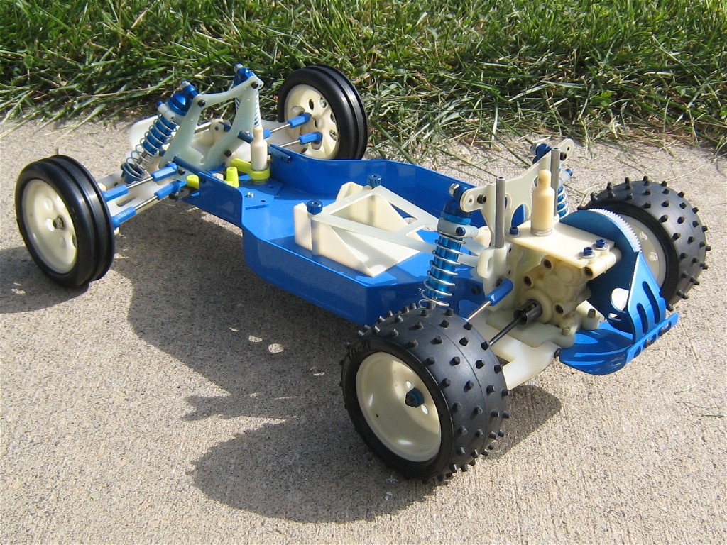

Very cool man. At first i was wandering if you painted the blue car you had.
looking good. :D

m_vice wrote:At first i was wandering if you painted the blue car you had.
oh no, that one's still in the basement. good thing too, since i needed to look at it to remember how i did that one. :lol:
