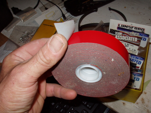

servo tape is my choice i use this stuff from home depot amazing grip and leaves no residue once removed when i want to remove it i wedge a piece of cedar between the servo and the pan and leave it for an hour it prys it up nice

x2, I think all my cars have this under either the esc of receiver or bothtreehugger wrote:servo tape is my choice i use this stuff from home depot amazing grip and leaves no residue once removed when i want to remove it i wedge a piece of cedar between the servo and the pan and leave it for an hour it prys it up nice

What is the tape called and where is it located?
