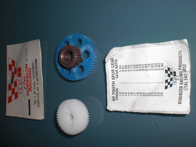

Hi Guys,
Are these any good or are they the ones that are a problem ?
If they are any good I have some you can use in various sizes Charles.

i could use 2 pending on the price

The Robinson parts are hit and miss. The concentricity of the parts can vary greatly from batch to batch. I have seen parts like this go from binding on one side of the rotation, to barelly engaging on the other side. If you get a good set, then they are great. But you might have to go through a few sets to find a good pair. I used to have a box full of these gears. Eventually, what I started doing was to use molded 48 pitch spurs from 12th scale cars, and with a little modification, you can make them fit as a replacement on the "cluster gear". -Jeff

I will check them out, i'm an engineer so will be able to set them up and clock their concentricity. I also have a load of NIP spurs for them anyway , will report back.

Same here, but my main issue for me is the white gear; because I the only gear I have one of those. And of course that one is off-center too.Jay Dub wrote:The Robinson parts are hit and miss. The concentricity of the parts can vary greatly from batch to batch. I have seen parts like this go from binding on one side of the rotation, to barelly engaging on the other side. If you get a good set, then they are great. But you might have to go through a few sets to find a good pair. I used to have a box full of these gears. Eventually, what I started doing was to use molded 48 pitch spurs from 12th scale cars, and with a little modification, you can make them fit as a replacement on the "cluster gear". -Jeff

What I wanna know: How did these get passed quality control? I've never run across a set that worked properly.
