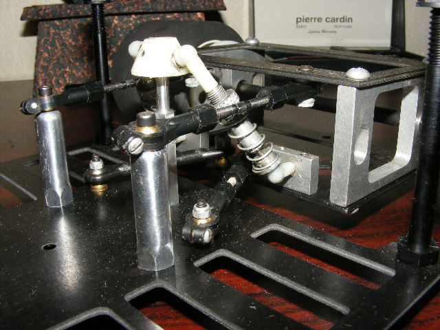

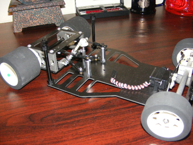

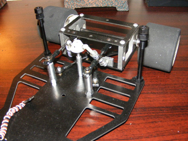

87 88 hey! wish someone had a pic of what parts i need for the rear end? it certainly cant be much
the alxe has a pro diff which is 64dp that cant be correct either can it? what brand is the yellow front steering arm?

The axle is pretty close. Most likely steel. After about 1990 they all had the longer diff. side hub like the 10l's. I feel bad because I can't remember what shock or spring the predator had on the rear. I think it was just a spring set up like the older rc12L's had. I'm pretty sure there was no shock, though. We were using 64 pitch gears back then, but with graphite axles. Bolink had steel axles mostly and I bet that's what you have since you also have the Bolink wheels. I think you are just missing the front steering blocks and a good body and then you can show off an awesome part of 1/10 scale on-road history. Composite Craft was the king of graphite back then.
