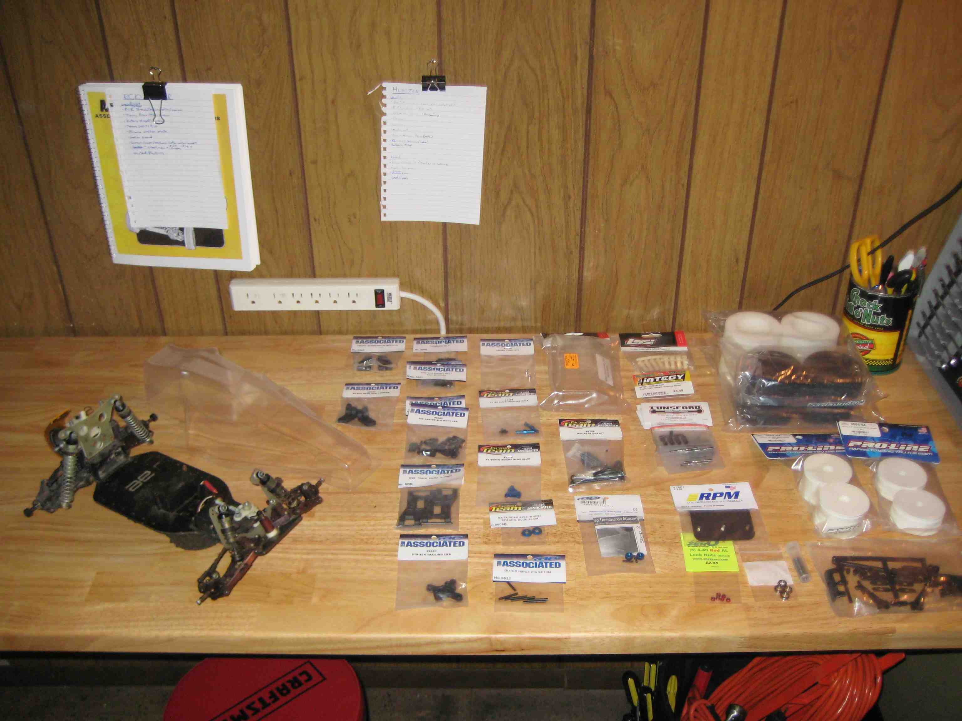

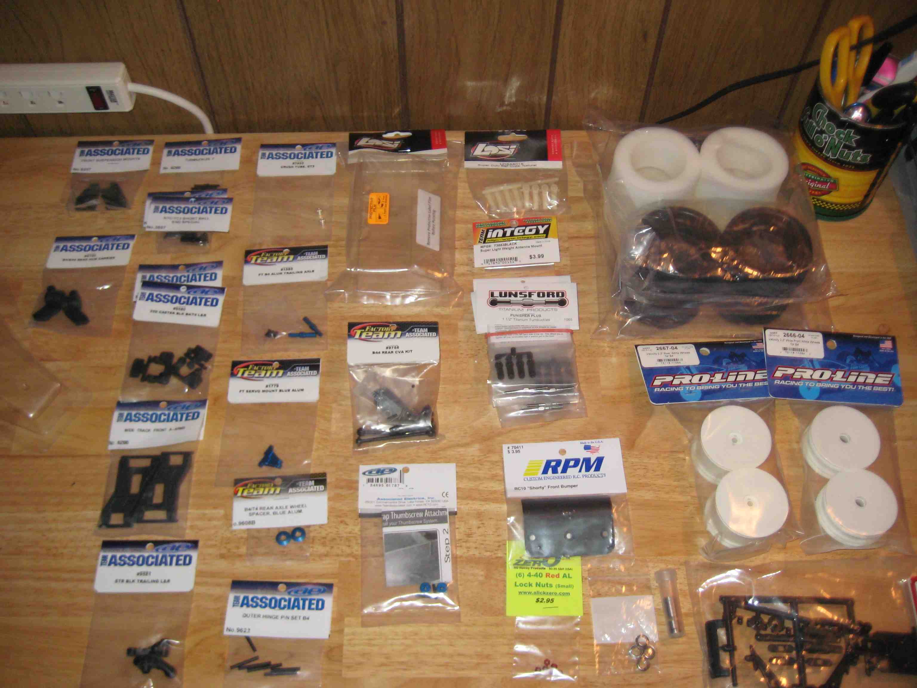

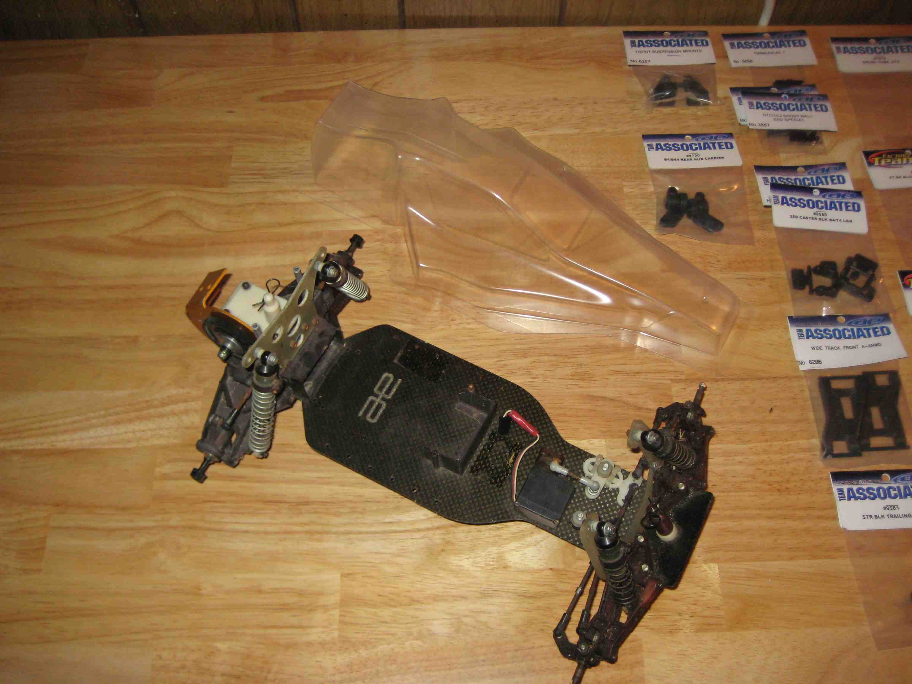

While my Hunter project may come from the heart (and provides some interesting challenges), this is the build that I have been really focused on and am most excited about.
I picked up a graphite car some months ago, with the intent on just restoring it to run around with my kids' cars, and then I discovered this site and the sweet new/old cars that a bunch of you guys have built, and it immediately expanded my horizons (while deflating my wallet :lol: ).
SInce then, I've been gathering and planning, and while I'm still waiting for a few pieces, and have to order up a set of Atlas' towers, I'm ready to get started with the parts cleaning/stripping/dyeing. I'm not really planning on breaking any new ground with this build, as I want to get more experience under my belt before I start messing with what clearly works. The plan is to stick with the stock wide arm suspension, and go the B4 hub/B44 cvd approach to fit modern wheels. It will run a stealth, with slipper update for brushless, and I decided on a B3 body, as I just like it.
So before all of that gets started, here are some pics of my donor car, and all of the fun pieces that I have to go on it.

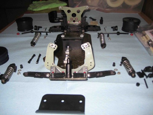

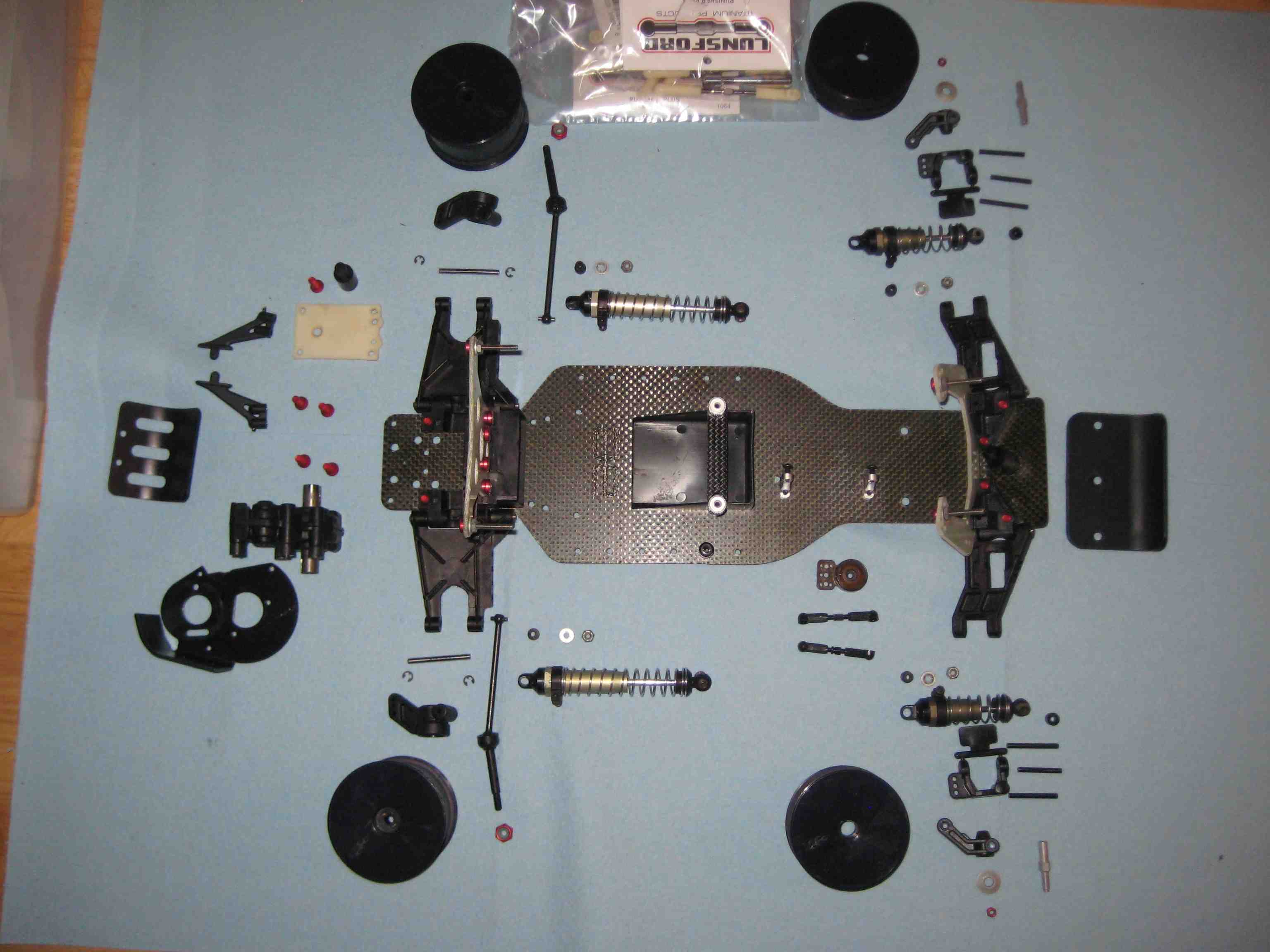

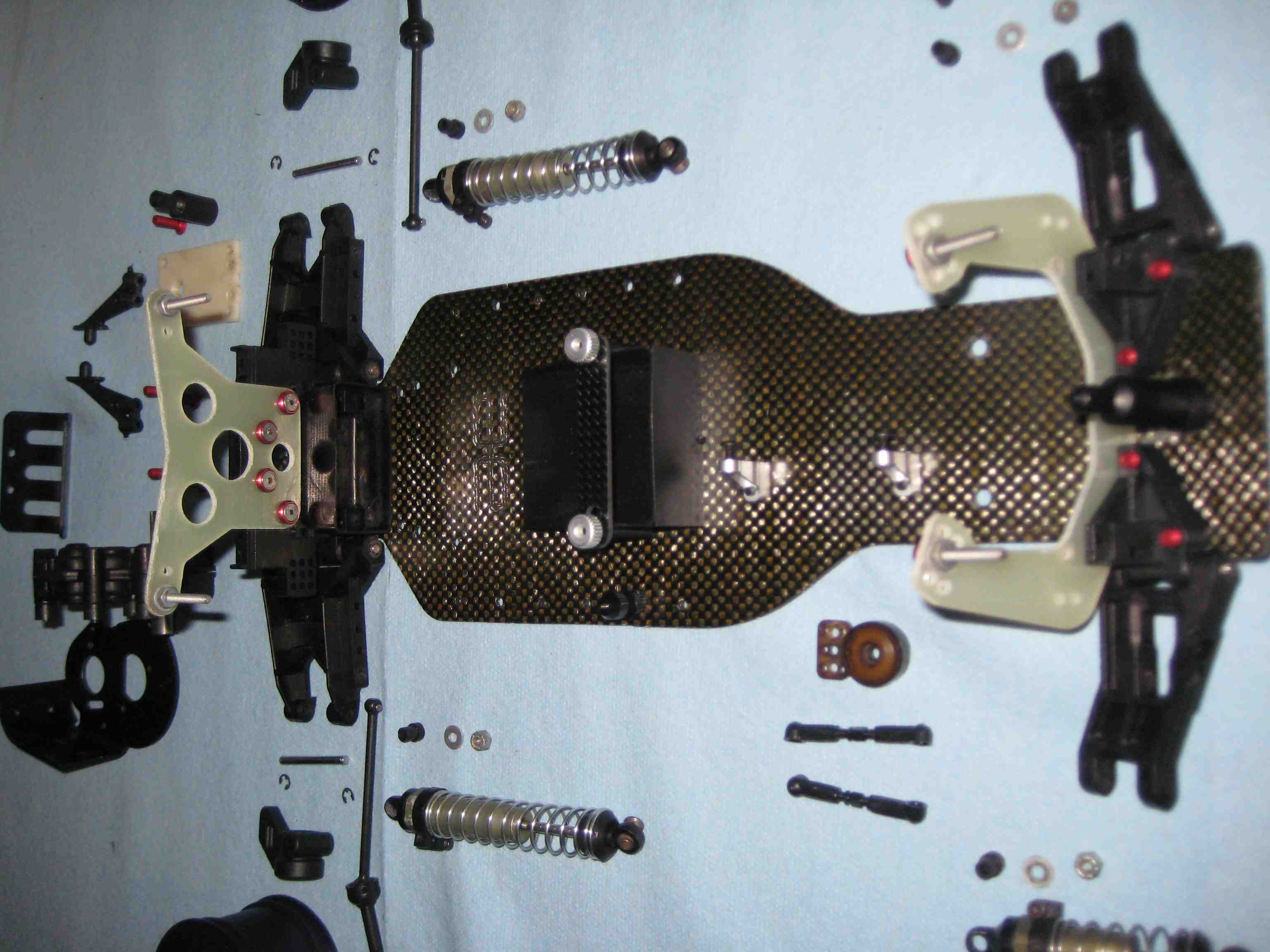

Just thought it was about time to do an update on my graphite project. Have most of the parts in-hand - just need to order up some towers & tranny brace from Atlas sometime soon, and waiting for some clean ball joints to arrive (the originals were in crappy shape, when I got them cleaned up). Slow going, but as this is my first rc10 (and I'm extraordinarily anal retentive :lol: ) I'm taking my time to get it exactly the way I want it to be.
Starting to think about a paint job (somewhere between an older PTG BMW and BAR Honda, I'm thinking).
Hey, so any suggestions on initial settings (springs, shock oil, etc...)? I figure I'll need to get on track to get it dialed in, but would like to at least start somewhere better than full on guessing!.
Some updated pics:
