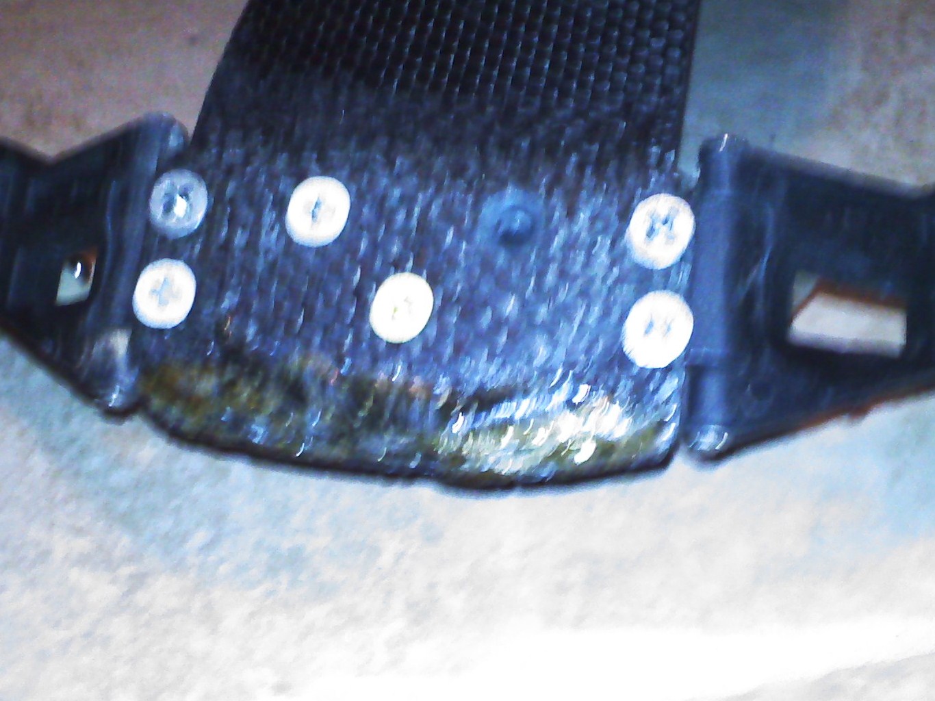

craigc8791
Posts: 158
Joined: Mon Aug 30, 2010 3:05 pm
Location: Houston, Texas
Re: Brushless System VS Graphite Buggy
Post by craigc8791 »
This dude put this epoxy on the nose of it, wondering now how to fix it

Should I cut the "bad" secction off the buggy and make a new edge

Well I cut off the "bad section" a hack saw works amazing for cutting graphite. Im rebuilding everything on it, Ill post pic of the build "Project Shadow" is the build name.

craigc8791 wrote:This dude put this epoxy on the nose of it, wondering now how to fix it
Who put epoxy on it?
Be careful with the hacksaw, the teeth can do more damage and cause further de-lamination and rip through layers rather than cut. A dremel with a good cut-off wheel is preferable.
craigc8791
Posts: 158
this dude at the track was like i know just what to do to fix it. so he coverd the end woth epoxy. Oh and I used a super FINE tooth blade on the hack saw, Im going back tomorow and cutting down to my line with the dremel. :wink:

Jay Dub wrote:hacksaw, works amazing...
if you keep the blade as parallel to the face of the CF you lesson the chances of delaming it
