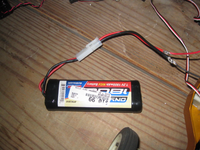

First thing I did was buy a new NiCd battery and hook it up to see if there was any hope of it still working. To my surprise, the motor fired right up. Thinking that it might be an easy fixer-upper, I bought a new Futaba radio with servos (the old transmitter had gone missing). I installed the servos and they are working fine. I attached the battery again and started fine tuning the throttle servo. However, after running for about 10 seconds this time, the motor just quit.
I was hoping you could help diagnose the problem - this is the only RC car I have ever built. Is it a miracle the motor started in the first place? Could the new battery be incompatible and something fried (the old battery had a three prong connector, the new has only two).

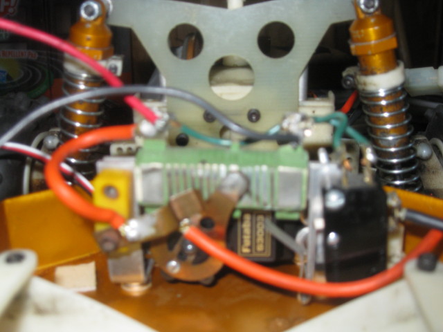

that 5th picture is worrying with non insulated wires
could be 50 things that went wrong, really. Try to isolate the issue, no need to be an rc car expert for that
Try to plug pack directly on mill. if it revs, then plug pack-speedo-mill and turn speedo by hand. if it revs then the issue is on the radio side... you get the idea.
good luck - and isolate all wires

which could have happened based on what we see in pic #5RC10resto wrote:yes, as long as your battery was not shorted outI stripped down the wires on my battery pack and touched them directly to the leads on the motor. Nothing. Theoretically, should this have worked?
