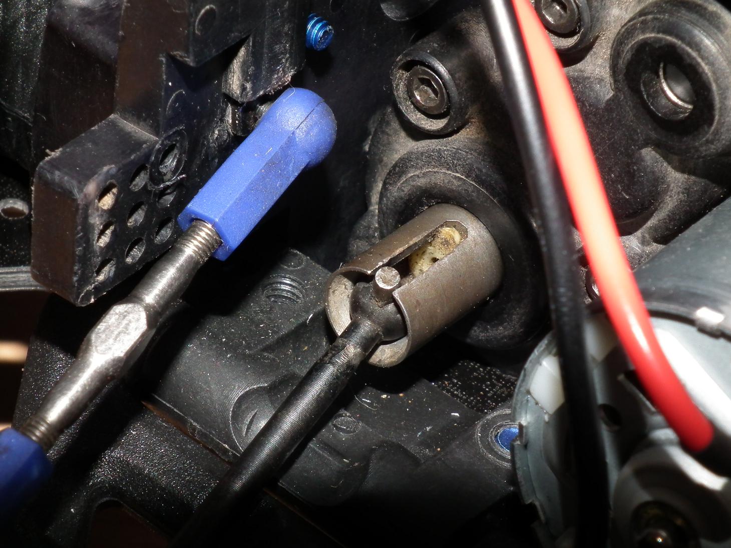

O and anyone tell me why this happens, if the rears drop anymore, it'll pop out...
I've got two shims on the inside on the hub, trying to push it back, can't fit any more on, as the pin for the wheel is as close to the bearing as possible....
confused.com.....
confused.com.....

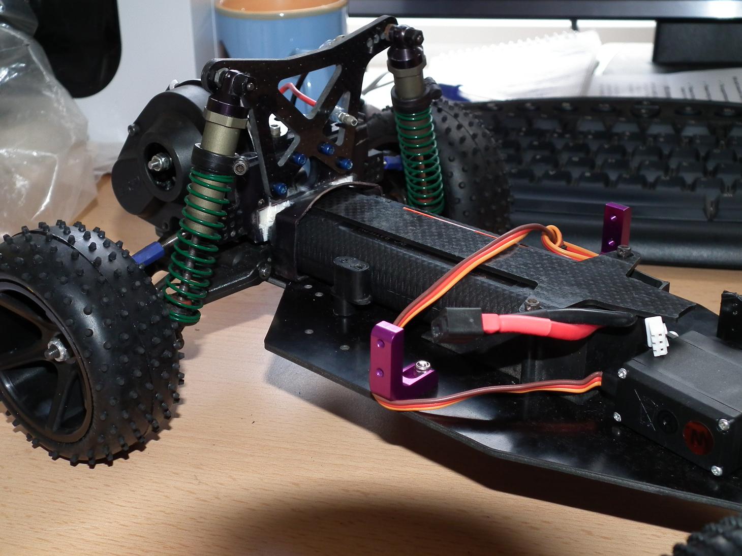

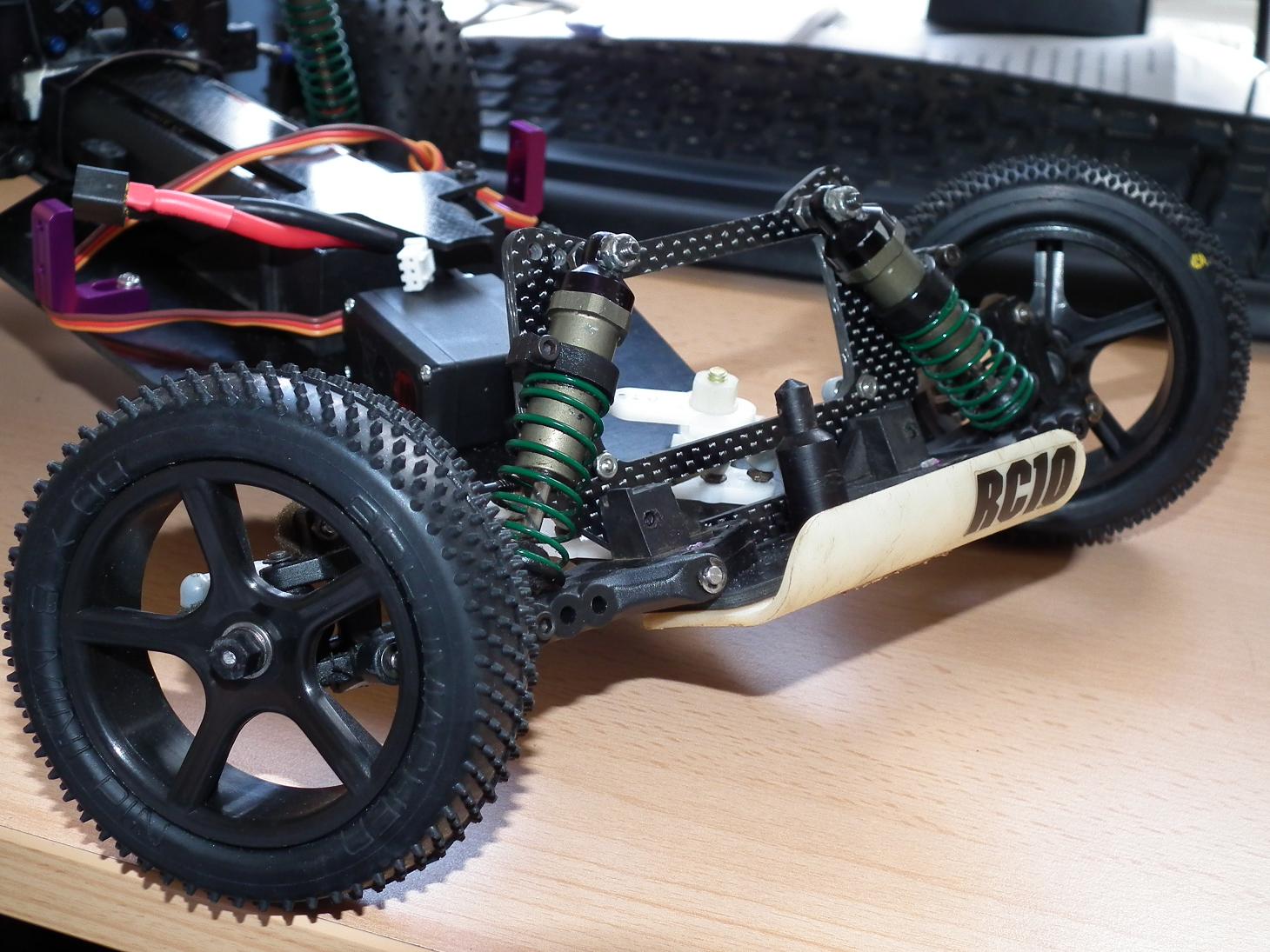

You need to put spacers in the rear shocks until you get the desired result. You should also try to move the shock position on the rear arms in the most outwards holes. I haven't forgotten about our deal, just be a littel more patient, I should be back at you in the coming days.
Nice progress on your car, but what did you do with the rear bulkhead? It seems all bent?

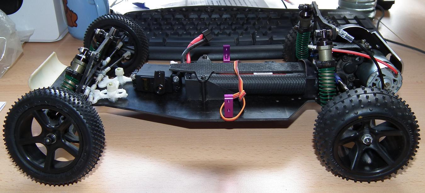

Bulkheads a test one to get the Lipo to fit, had to make more space it's about 5mm longer, so had to cut it out, the B4 carbon brace pushes the top up...
O and for the weight peeps 1206 grams, with rec and esc!!
No where near the old "slim" version
