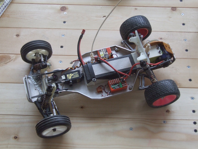

Charlie don't surf wrote:Those alloy servo mounts are Racers Edge parts on Mig's car-
thanks 8)

rpm stealth will be on it

tranny finished today :D

Sweet ride, should be fun.
Love the "period" colours!!

I like the yellow, nice touch.

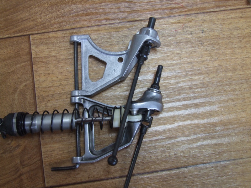

bought a few Kyosho tomahawk/scorpion arms for myself and friends. the shape, angle and dimensions are very close to each other. but I couldn't put kyosho arms on the conversion. kyosho arms are slightly narrow for A&L mounts

I have ran this beauty on the track after my race last weekend. didn't know nothing on this setup before the actual test run 'cuase it has trimmed chassis has huge roll with the semi trailing arms
it ran simply great. very sharp at the corners and stable on the straight run. it need more power on the jump slightly. but it can be controlled by gearing and myself. I'm thinking of racing with this next time
fiy, it has Jay Dub's .89 shock tower and .89 shocks with .71 shafts
redesigned rear tower for 1.18 shocks with 1.02 shafts
and A&L trailing arms as you can see
I still didn't get right setup for rear shocks. need to try different pistons and springs. but I believe I came close to it. thanks for guys who like this, and Daryl for making the arms. I love this runner

really love how this buggy looks mate, hows the new table? is it display only?
