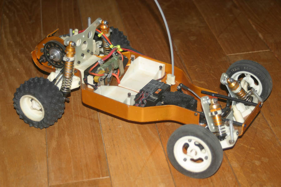

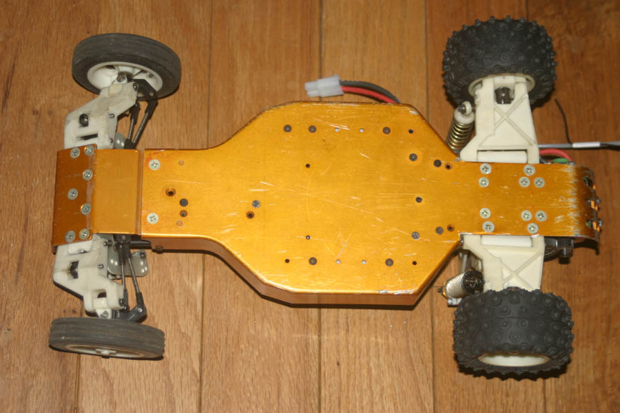

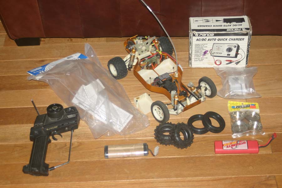

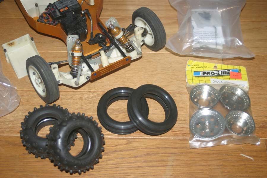

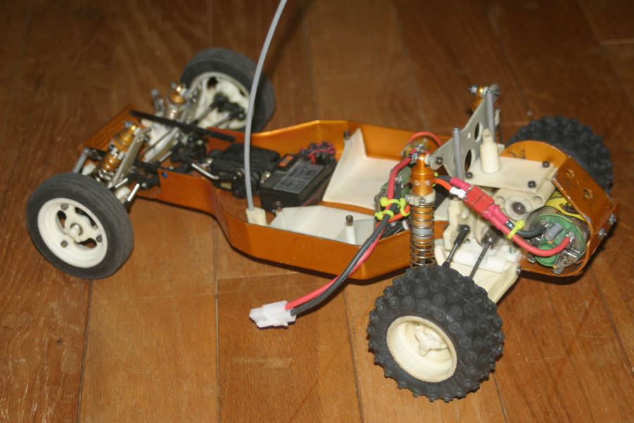

HI all
just would like to know , can i still find parts for my 1984 rc10 that i got as i got one off ebay , i used to race one when they came out back them . now i got two b4 and 1 t4 , now i would like to do the rc10 back the way as it came out back then. got some photo's to you guys . and a photo of the car that i would like to do .

that's the RC10 from mrlexan
What parts are you looking for exactly?

if your trying to make it all original, you'll need the gold nose brace tubes, white shock rod ends and spring cups, white steering knuckles, and some white servo mounts. also your car has the newer style front shock tower, so you'd need to find an original one. oh, and the white steering bellcrank and ball cups. that's it.
oh ya, welcome to the site.
i forgot about the white 32p spur gear, too.

that one is in pretty good shape, a good cleaning and will be like new
nice find

hi all
the car is from mrlexan still waiting forit to turn up , when i get the car i will check out what i need, and ask for help to track down parts to, the one thing is i like to get is the painted body in the photo i posted, and may be a new pan, thank guys for your help so far .
