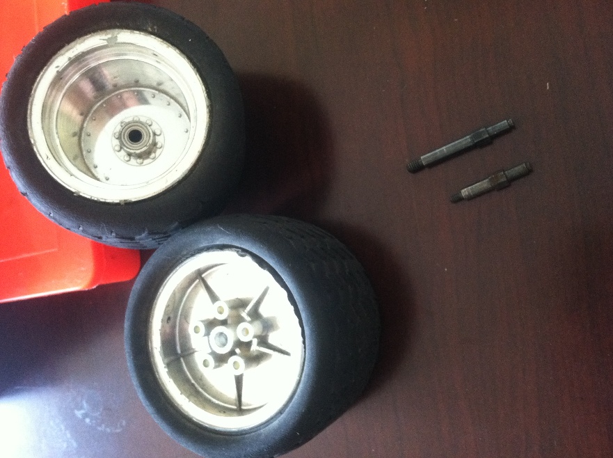

THE 10T uses the same stealth tranny it uses the 87 spur gear.I have a set of truck conversion wheels that sit out wider and have the front longer axles and front bearings.For running in the grass its the cheaper alternative to making buggy into truck rather than a 10t conversion.DON
Re: Gold pan Buggy into a truck?
Thanks - I have that kit as well, but the tires are shot, those extended axles are really great for messing around with different combos - do you know who made that kit? I'll put up pics tonight to clarify if we are talking about the same thing

Here is the axle I have next to stock, and 1 front and 1 rear wheel
Is there any modern wheels that are offset like this anymore? or better yet, tires that will fit these?
