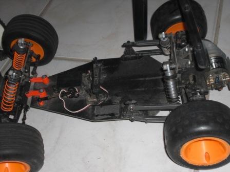

Picked up these two trucks ones a JRXT and the other I can't figure out (80 bucks shipped would like to sell one if it can be identified):

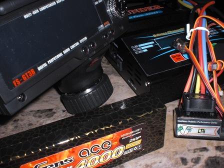

Flysky GT3B ! And i bought an extra receiver and threw it on my vintage original JRX2... took it out of for a drive ! wow incredible radio strength a full football field away and still in control !! A Gen 40c LiPo...Thunder charger full metal casing...and a Brushless hobbies LT4 (jk race put me on to them and their reviews look good) 125.00 w/shipping from Hobbypartz.com plus 68.00 for LT4 ESC :
Grand total so far $270. I'm waiting on the motor still.
You guys think I overpaid on the JRXT? can anyone help identify the 2nd truck?

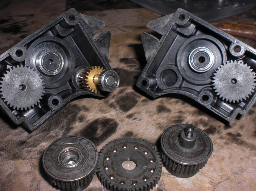

Im gonna tear down the JRXT tranny right now try to inspect I dont like the way it sounds.

need better pic's but it looks like a Duratrax to me?

agreed, looks durtrax....

I thought I saw the tires say duratrax do you know which model.
Attached some more pictures. (pix removed but run of the mill dura evader was the car)

I think they just called it Duratrax ST truck not sure? it was a cheap copy of the Losi xxt

You guys rock...with your info it turns out it is very likely a duratrax evader.....and ur right is an xxt knockoff and thats partly why I bought it ....thinking it was the xxt...no big deal maybe i can sell it later.

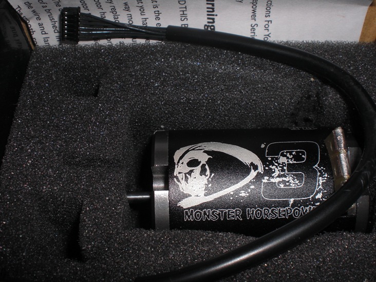

Im waiting on a trinity D3 540 can 17.5 turn. Roar approved+sensored.

There are a lot of things different between the xxt and evader.
The gearbox/mounting is completely different as well as the steering.
Front body mount is the same, though

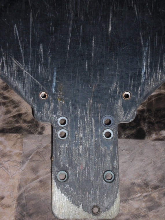

Well a nice quiet peaceful afternoon turned into a gut wrenching patience testing, pullout the drill, brainstorming clustereffing...thanks to these 2 little bastards which had stripped heads...luckily after war-ing with the motor plate bolt I was able to spinoff the entire tranny to get the other stripped head bastard off too:

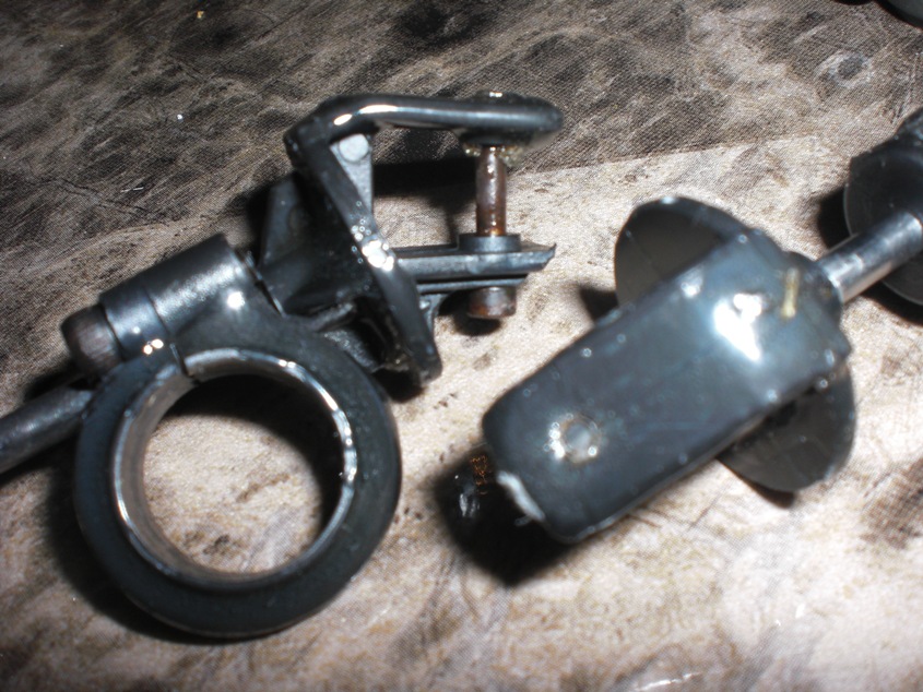

This is the rear of the chassis...not too happy but I'm trying to think of something durable and strong to build up this area to it's original dimensions again and then paint. Not the end of the world but not preffered:

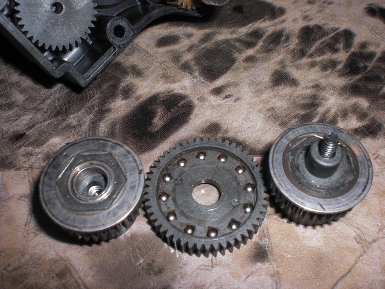

Now for some good news(i hope) it looks to me like the tranny is in good shape overall...correct me if i'm wrong:
Now I wasn't mistaken in that something didn't feel right....the diff has a ratcheting feeling to it even when assembled outside of it's box and spun by hand...I suspect the little balls either need the lube that seems to look completly dried out OR the balls need replacing altogether. It could also be that this tranny is just like that and my vintage original has a slightly diff. tranny...not sure on that tho:
The molded gears look fine to me....just have to lube or replace the diff's metal spheres maybe.
I called it a day after this....not as far as I wanted to go today...the front end and misc. still need to come off the chassis but i loosened all those up already.

Re: ILL's JRX2 modern runner / Budget build / New goodies:
a crunchy diff is usually the thrust bearings (the super small balls around the head of the screw in the brass colored washer with little tiny holes), but could be the diff bearings as well. Flip the rings, give them a good cleaning (maybe even a quick sanding) replace all the balls (both diff and thrust assembly) and put it back together.
It should be butter smooth then.
FYI - my reciepe: Black grease on the thrust assembly, Clear grease on the diff balls.

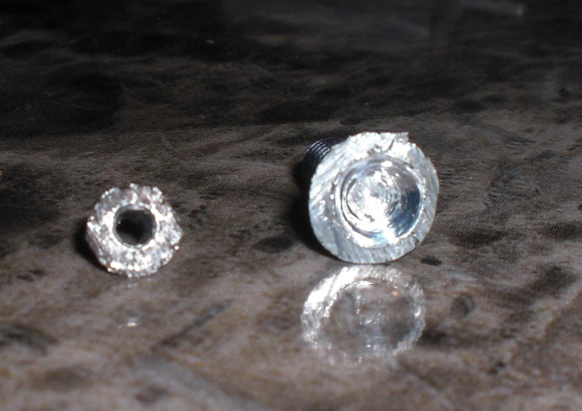

What will stick to the chassis other than maybe JB Weld or fiberglass resin. I used JB to fill holes in a chassis but never tried to skim coat it.
How much is missing?
You could just put a little paint on there. Then keep it off its rear by using some limiters on the shocks. Just some random ideas...

Trinity D3 17.5 came in today..brand spank new...55 bux. I know the D3.5 is out and i checked out its specs it looks good but this is kind of close to it and kept me halfway to 100 bux rather than more than 3/4 had I gone for the D3.5 (I can still claim to be on a budget).
I know it's not super attractive but it is somewhat of a budget build so I'm attempting to keep setup costs down...as well as "reinforcing" areas breakage prone. I don't know them all so please let me know of others to possibly target. It's not fully cured until 24 hours but it's cured enough to touch after about 2 hours . I'm happy enough with the results to say this is likely what I'll slap onto the rear of the chassis and mold it up nice then sand down if possible.
Epoxy does not get brittle or crack..it has some flex but is considered stronger and more durable than polyester type adhesives.
On paper it sounds exactly what could supplement weak areas on our hard to come by parts.
Yes yes the screws still unscrew.

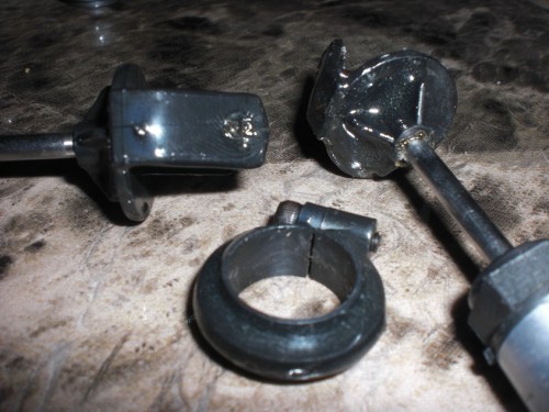

Discovered some small hairline fractures on the bottom of the rear stock perches..sucks they will need replacement....but they weren't broken all the way through just small fractures that were certain to grow until they split. So I took the opportunity to skim over the fractures and other reasonable prone to breakage areas with 2 part epoxy adhesive delayed 30 minutes to set. I'm sorry I didn't have my camera to show a before picture. It is kind of hard to tell because the epoxy is see through and well the flash goes right through it. You can see some small bubbles of aeration locked in place tho. I did the semi bad perch and the good one...I also hit both the spring retainer's on their tops and sides:I know it's not super attractive but it is somewhat of a budget build so I'm attempting to keep setup costs down...as well as "reinforcing" areas breakage prone. I don't know them all so please let me know of others to possibly target. It's not fully cured until 24 hours but it's cured enough to touch after about 2 hours . I'm happy enough with the results to say this is likely what I'll slap onto the rear of the chassis and mold it up nice then sand down if possible.
