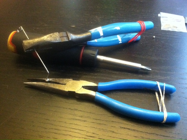

Theres gotta be an easier way :lol: (but it did work though) :lol: :lol: :lol:
how do you solder the metal ball coupler to the wire?

It's been a long time since I have built one but I remember dreading it. One problem you might have had is that your pliers were acting as heat sinks which may have slowed your progress.

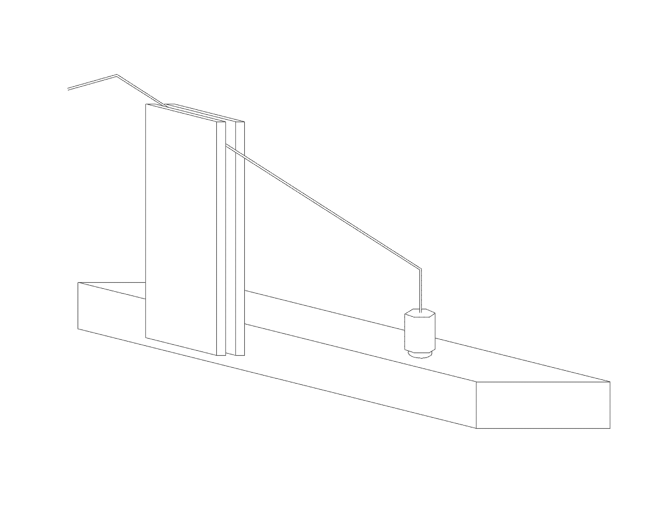

I remember drilling a hole in a piece of hardwood for the ball end and CA'ing two pieces of balsa vertically for the wire to slide between.

Heating the solder wasn't a problem, although it was not a good idea to solder on the dining room table :oops: but my only opportunity was during dinner. :lol: :lol:
Thats a great idea civilguy, can I get that sketch in .dwg format? :lol:

jon burrows wrote:Heating the solder wasn't a problem, although it was not a good idea to solder on the dining room table :oops: but my only opportunity was during dinner. :lol: :lol:
I was actually detailing a bridge survey for a client and just sketched that off to the side. Sorry I didn't save it. :wink:
