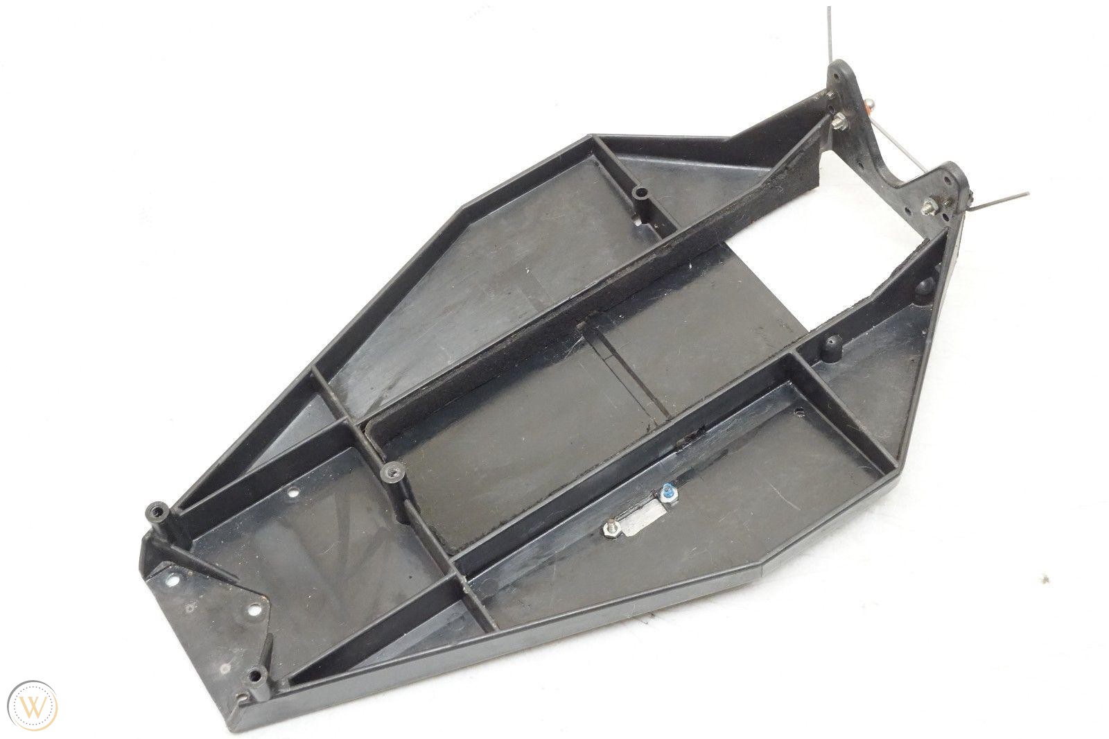

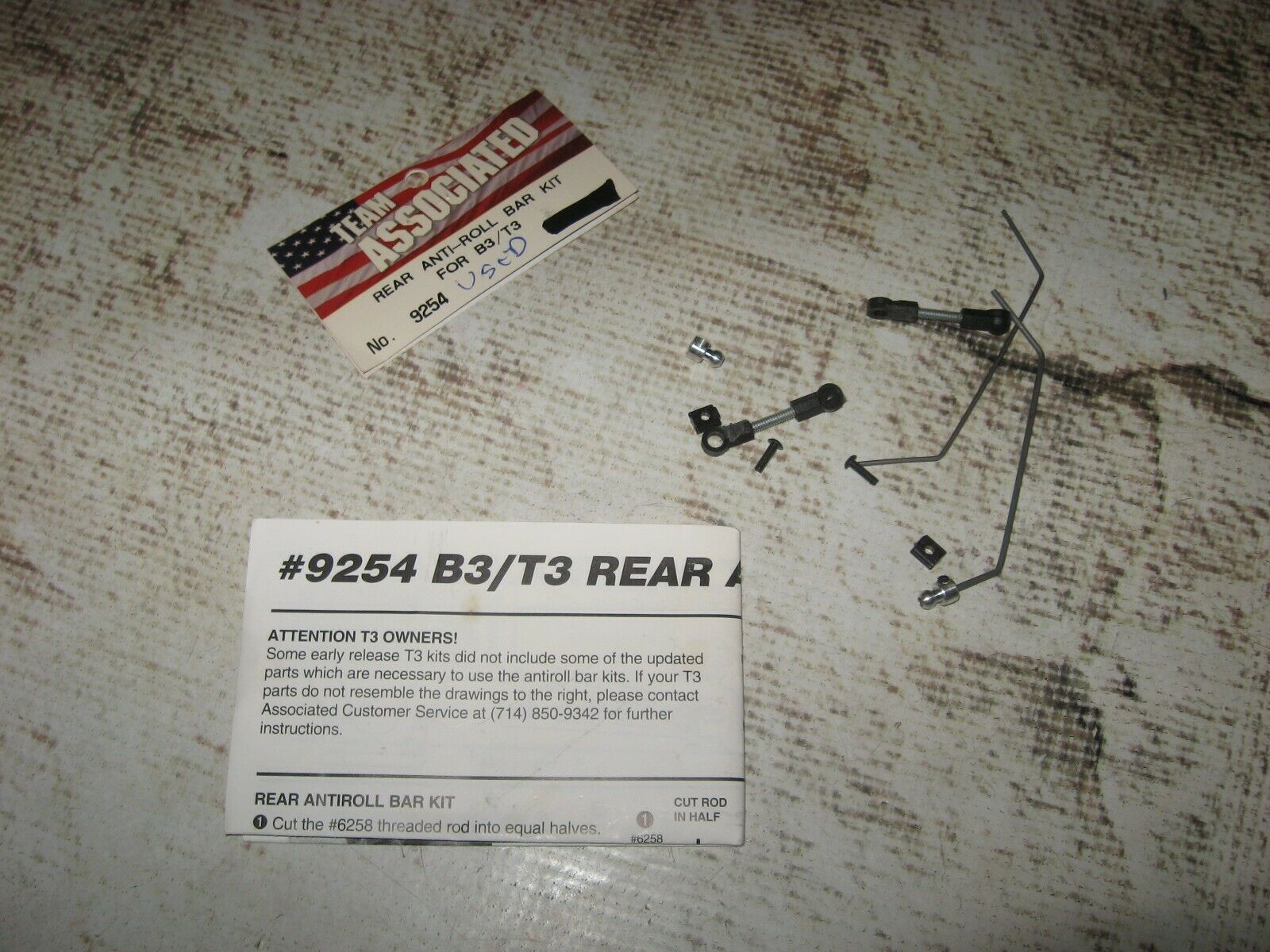

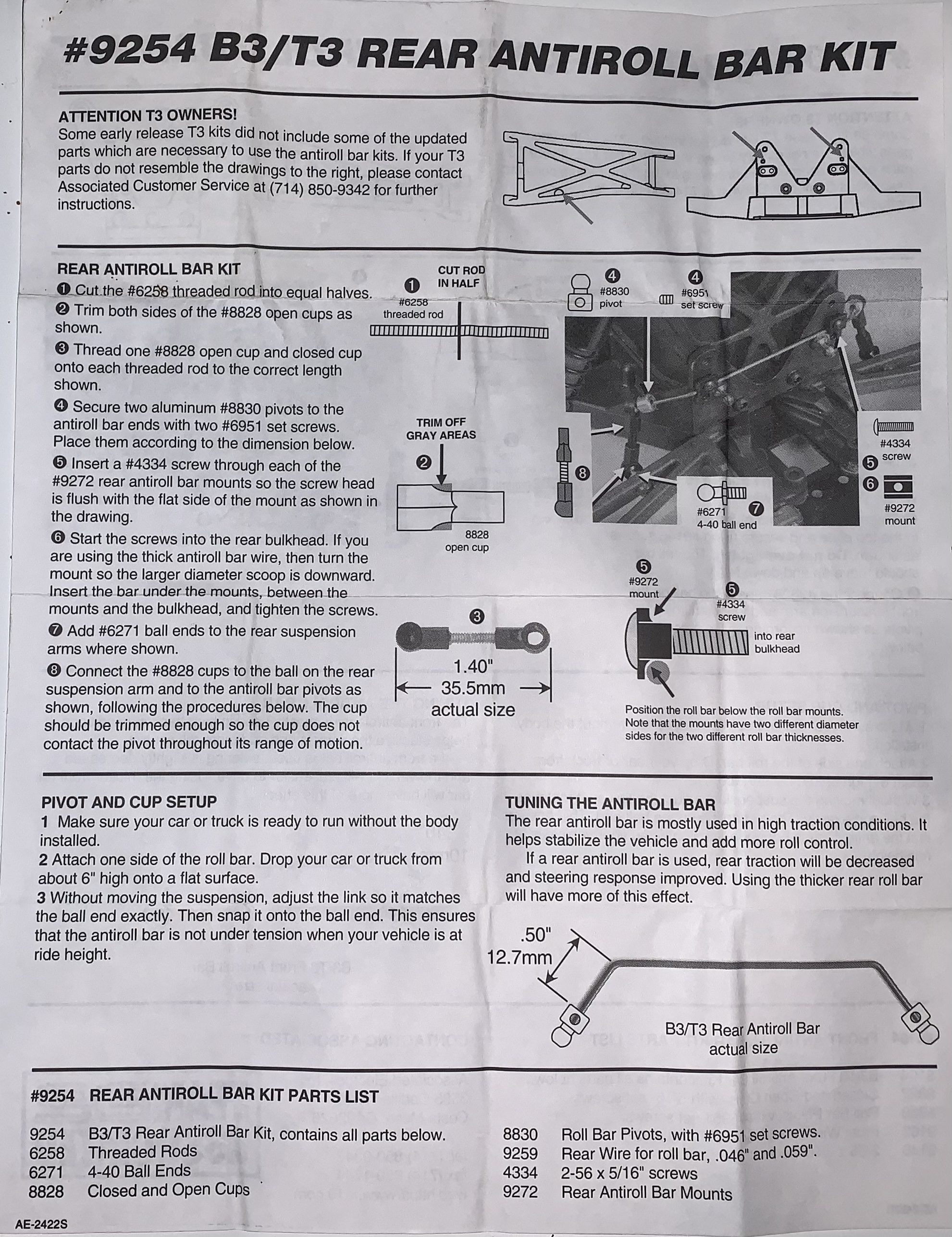

I'm racing my B3 on carpet soon and want to fit a rear rollbar. Anyone have photos/instructions of where it clamps to the chassis?

I couldn't find the manual for it, but here's some pics

Excellent! Looks simple and the clamps look like Schumacher XLS ones, which are easy to get hold of.
Many thanks.
