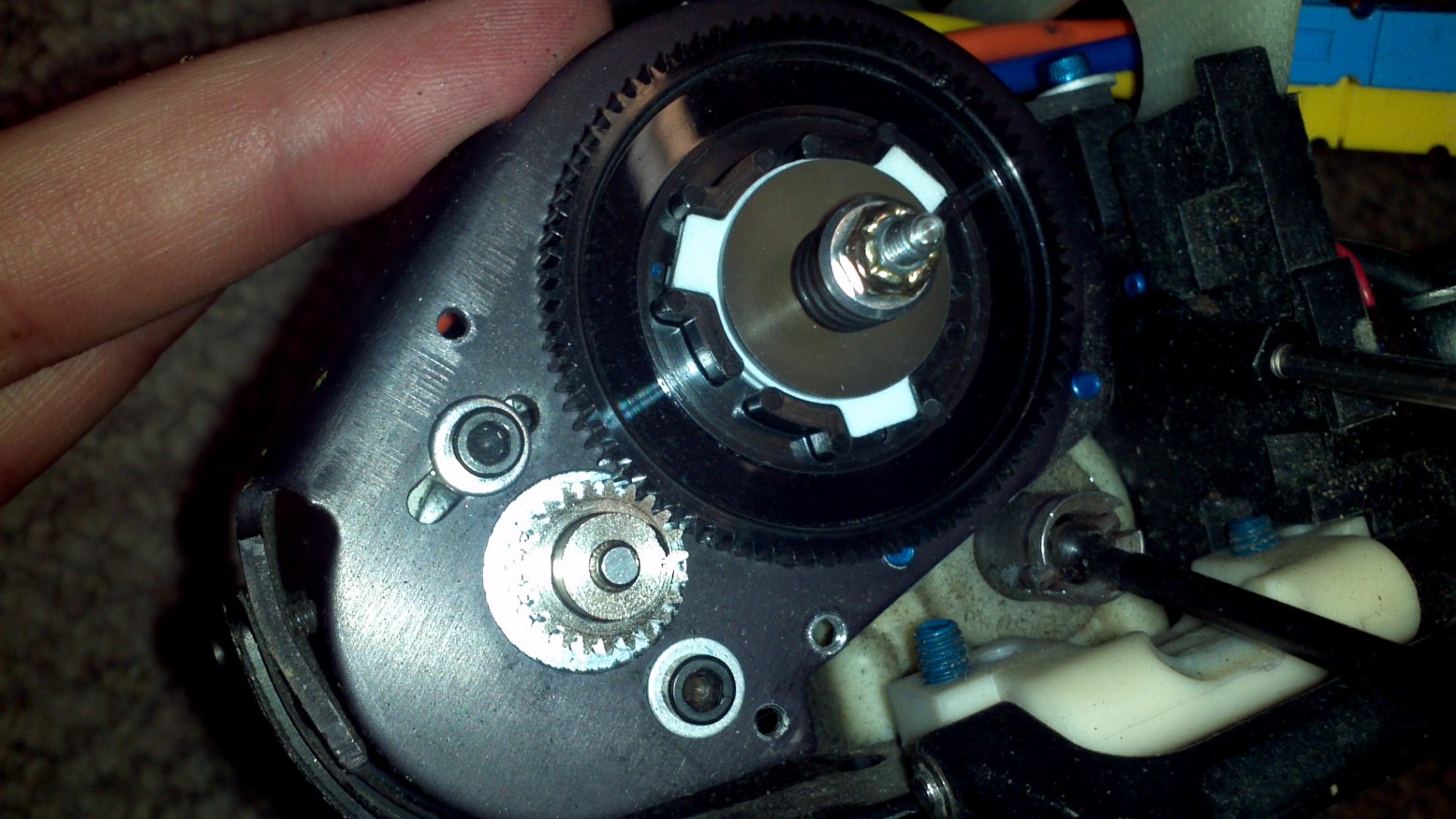

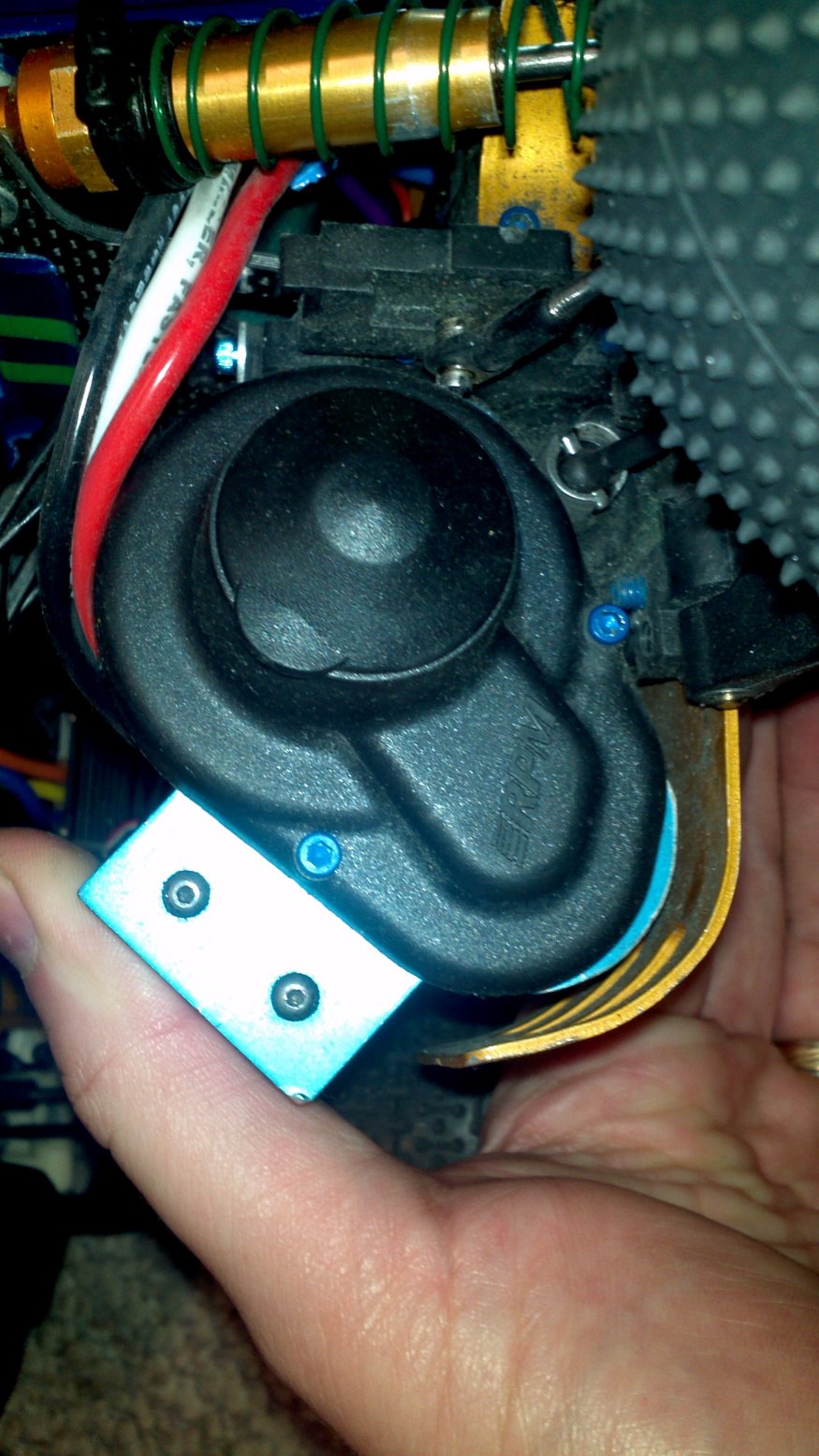

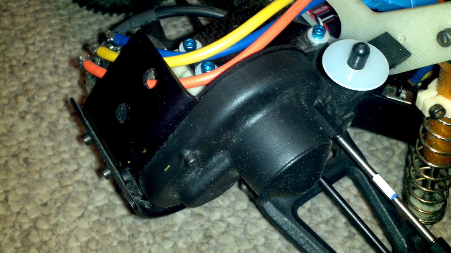

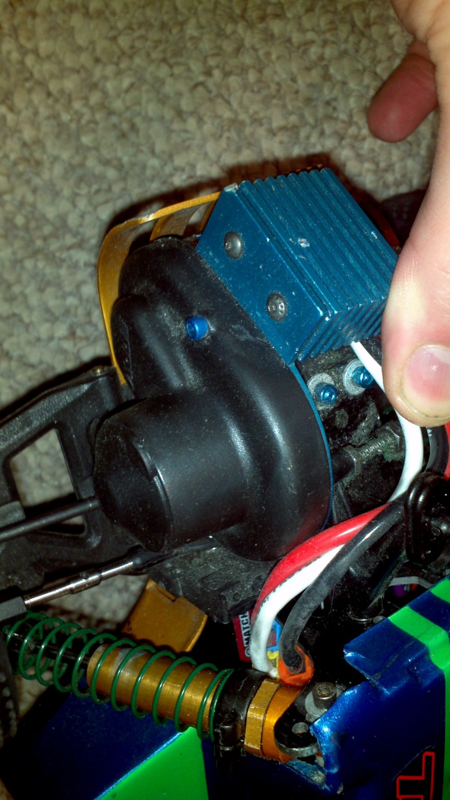

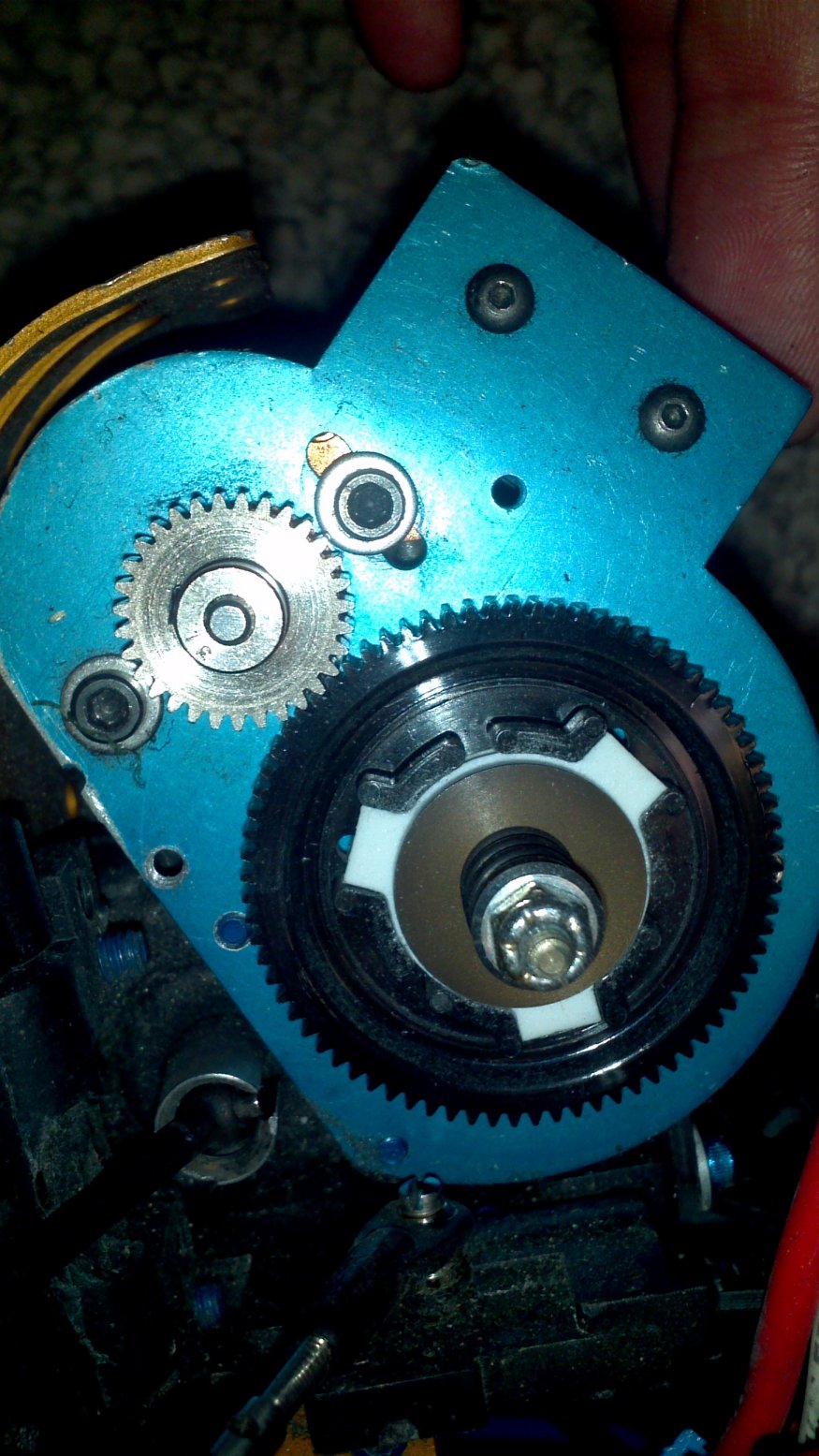

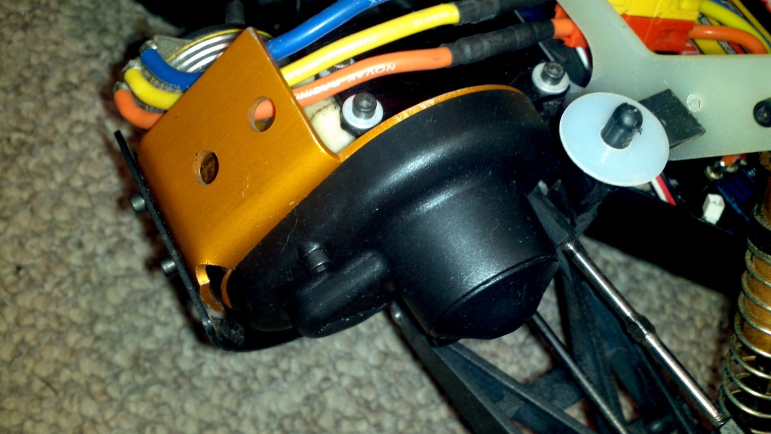

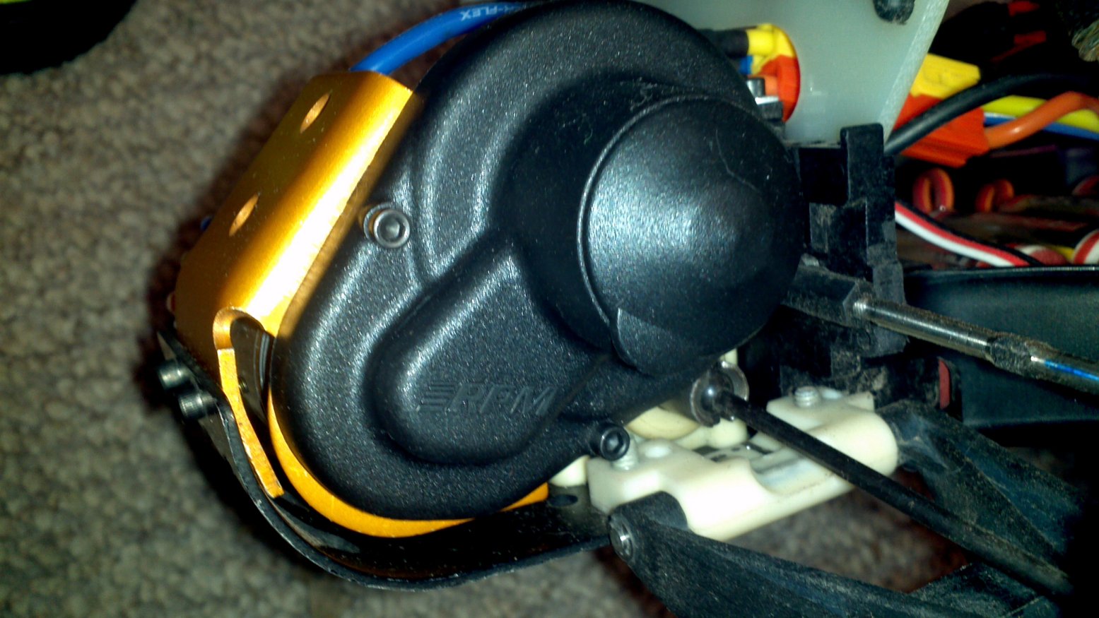

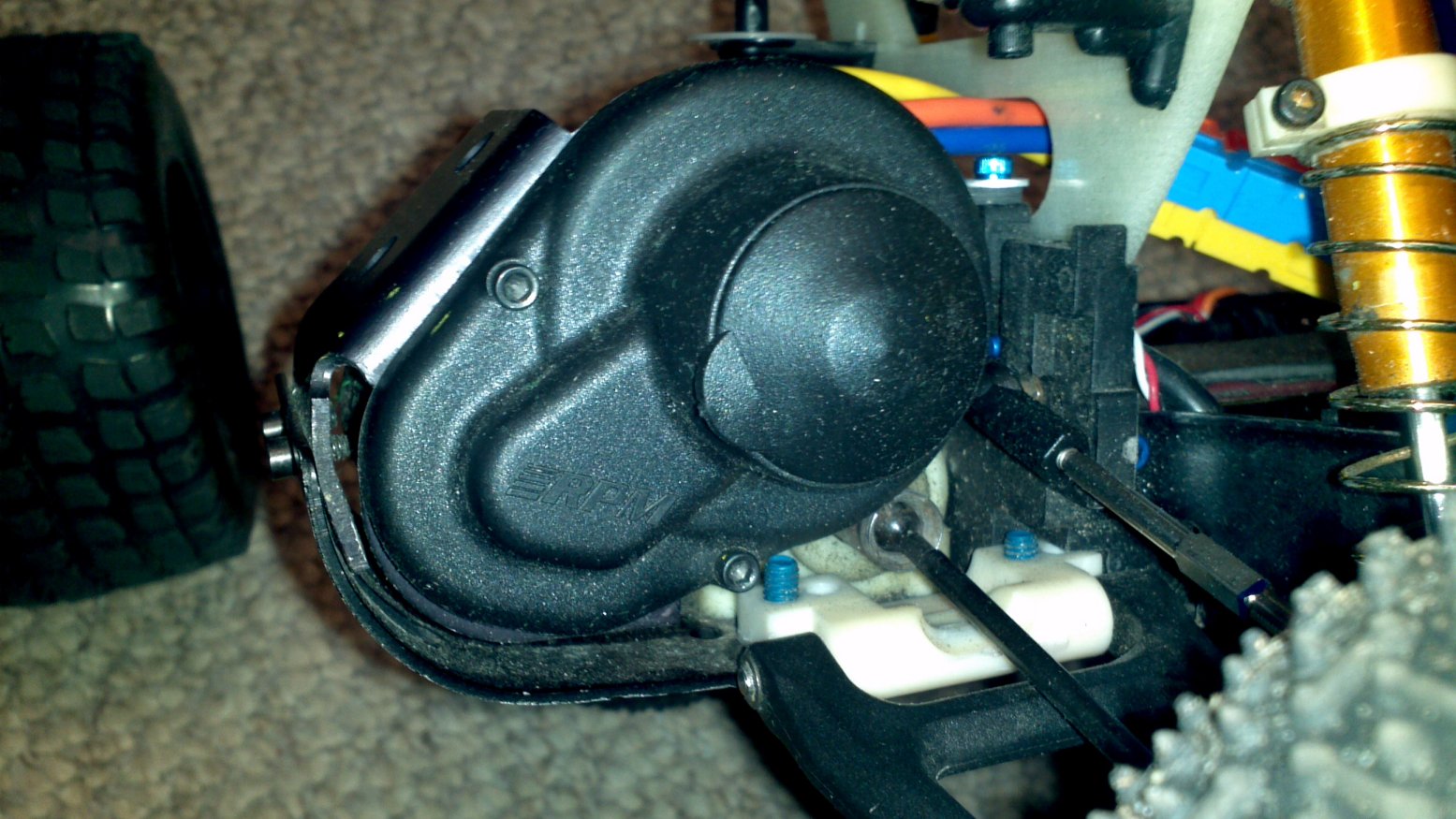

Ok, Here are some pictures from 3 of my runners. You can see how close the second hole is to the edge, but so far is working fine, and yes it does fully enclose the gears. Two of these, the blue and the black, I race weekly with against their newer brothers. The only other thing I just thought about is that these covers will not work if you have not replaced your topshaft. The original stealth slipper is too tall for these gear covers. You can also see a range of spur and pinion gears fit in these covers with no rubbing.

I figured out this little trick after I had gotten that blue litespeed heatsink motor plate off of ebay. It wasn't until after I got it that I saw some previous owner had cut off that little bit at the bottom where the normal second hole is. Adding the second hole worked so well, I just went with it for a couple of other RC10/Ts I built up.
The RPM covers also stick out far enough for the B4 top shaft which seems longer than stock. I don't have any experience with the TBG covers and if they work when you have changed out the top shaft.
Understandable about not wanting to drill a hole, I would never do it to a NIP or a lite gold plate....
