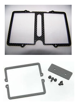

I can't speak directly for the '94, as I have yet to convert mine to lipo, but I have seen others use B44 lipo trays on vintage 4wd buggies (Schumi CATs, YZ10s etc.). You can try that. I did convert my 870c to lipo, and all I really did was take some carbon fiber bits and glue them to the chassis with my saddle packs as a template for positioning.

Those are trays from the 44.1. That also works, but you have to put the middle bit in the right spot. The 44.0 tray was a single carbon fiber tray with two open squares, connected by a bridge piece. You could get a 44.0 tray and cut across the bridge piece to make two separate trays.naushad wrote:Have a careful look at this yz10 '95 from a yokomo fan
