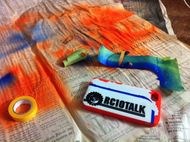

Since I have a few RC10Talk.com stickers laying around I thought I would come up with a cool idea to put them to use. I enjoy airbrushing but, I'm no professional, so I decided to give a plain white Iphone a custom look.
First attempt, epic fail!
The paint came off with the tape :cry: I think I will try a clear hard case next time. I can paint it like a RC body from the inside out and place the stickers as normal. It relates to the RC product better this way too. I just have to protect the inside from paint scraping off from inserting the phone... clear coat, maybe tape? I'm open to suggestions on this one.
I think the "talk" part of the RC10Talk is perfect for the phone 8)
The challenge isn't over yet. Maybe in the end I could do some up for other members if they are interested.

I like the idea. 8)
You should try scuffing the case with fine scotch brite or steel wool, then use an adhesion promoter, then a tac coat of primer followed by a couple more light coats.

I got bored last night while working the night shift and decided to make the best of this experiment. I pulled off the paint that didn't take to the rubber and then painted over what was there. I knew I wouldn't be able to mask it up with tape, but who cares :? :D
I decided to use the blue plastic wrap from the Team Blue Groove body I had with me. I could see through it and could see where to cut out the stripes. There was no good way to secure the plastic to the case so I pulled it tot and taped it on the other side and hoped for the best.
With the uneven surface and the fuzzy stripes it looks like a 4 year old did this. I think it works though, given the bright colours and the sticker. It almost looks like it was done with purpose and reason. With a whack of clear coats it's now on my phone :mrgreen:
I assure you though, the next case will be on a whole different level, maybe even a 10yr old level, lol
