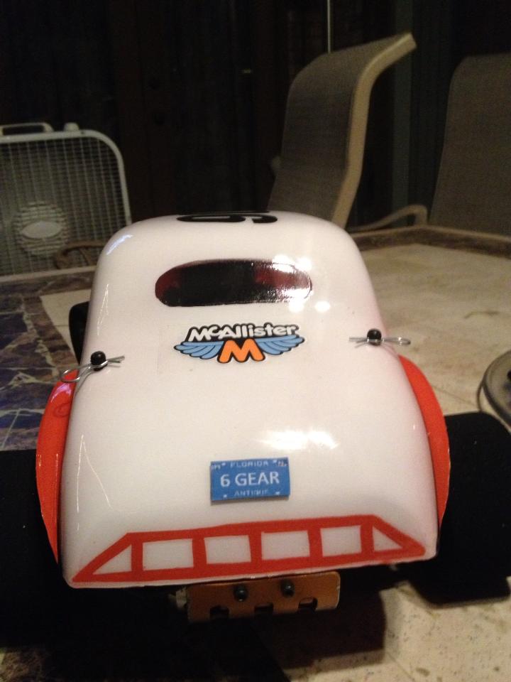

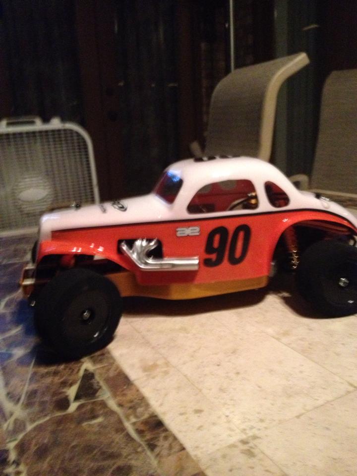

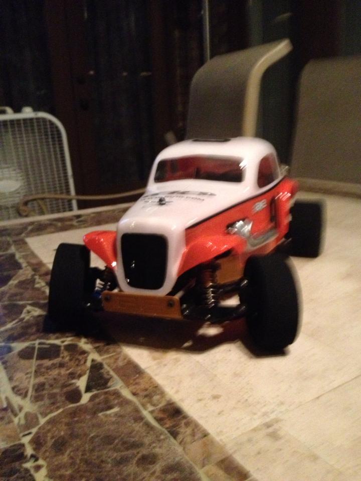

It's been a while, and since moving to short course late models, the 6gear has moved to the indoor concrete oval. The track is kind of like Martinsville...Long straights with tight, flat corners. The bomber class is alive and well here, so I put on some BSR foams, and a Mcallister mod coupe body. I had to add some weight to the left rear, and she hooks up really well.
Now if I can only get the late model "brick" to hook up, I'll be set.

Looks good Russ! I can't believe the foams hook up on the concrete. For some reason I thought the floor was polished.

They used a non-skid paint, and the concrete has just enough abrasion to grip. I use Paragon traction compound on the soft rears, and hard foams up front. Last week, I actually had to wrap the outside 1/3 of the right front with electrical tape to take away bite.
Last night, I re-coated the rears before the 3rd heat, and ran a few warm up laps. When the buzzer went off, it stood up and wheelied from a standing start all the way down the front straight. For the first half of the run, it was pulling the front wheels coming off the corners. :P
