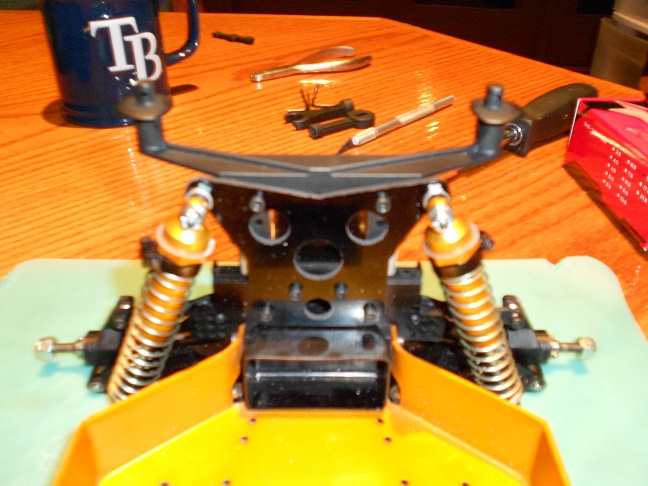

The new local track is open and running....and I've been bitten by the racing bug, yet again. The street stock / bomber class is running 2wd buggy chassis, 13.5 motors, and coupe/legend type bodies.
I've decided to take the plunge and get myself updated since I'm about 20 years in the past. The car is in great shape, except for some minor details, but I've been aquiring all the running necessities. Here's the start. Updates as they happen.

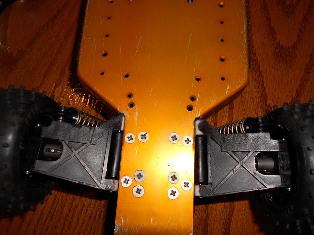

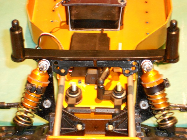

Some initial work on the suspension. I trimmed the inner mounts to align the axles by using the 2nd set of holes. Also rounded the arms and notched the chassis to improve suspension travel. The rear arms will hang straight down, instead of stopping against the chassis. I drilled new mounting holes 1/4" in from the original mount holes in the rear tower, as well.

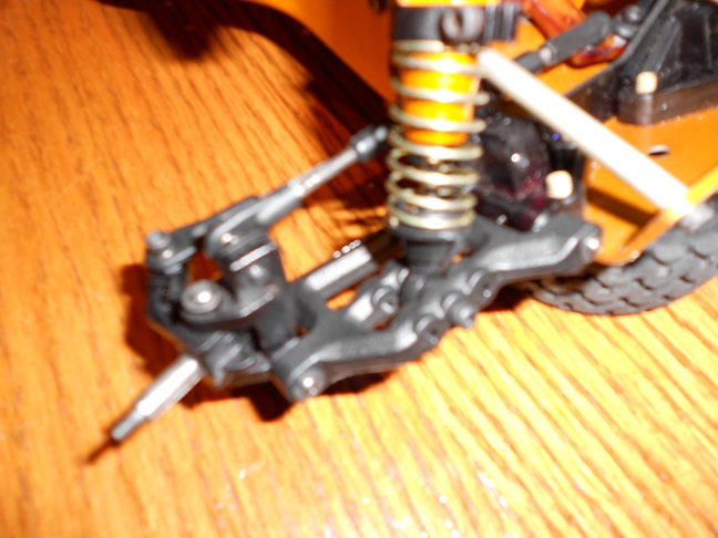

The front arms are RPM, and all the ball links have been replaced with the Dubro screw-on type. So far, so good.

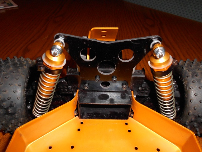

The front will line up with the shock mounts, but the rear may need a couple of holes drilled in the shock tower...I'm looking for an alternative to that.

One good thing is that shock towers are a dime a dozen, so drilling may be the best bet. This car started as a simple restoration (except for the dye job), but since I've decided to race it, I started doing little things that I did in the 80's. I figure going in circles on dirt today is the same as it was back then.

Take a look at my worlds runner build the rear tower has multiple mount points..tower is RC Carbon Works....JohnnySrRuss Winn wrote:One good thing is that shock towers are a dime a dozen, so drilling may be the best bet. This car started as a simple restoration (except for the dye job), but since I've decided to race it, I started doing little things that I did in the 80's. I figure going in circles on dirt today is the same as it was back then.

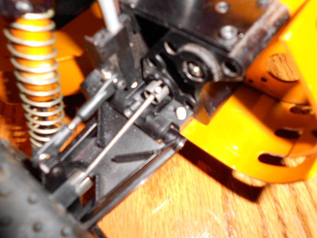

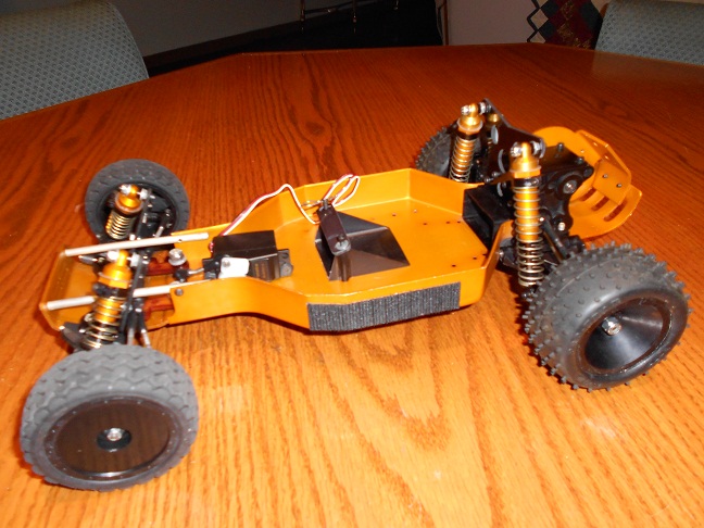

Thanks for the tip Johnny. I'll have to check it out. Right now, I'm trying to figure out the worlds bell crank. I got 1 flanged bushing, and 3 non-flanged. There's some slop in it, vertically on the screws.
Rem, I'm not sure how many times you can get away with removing the diff tube. I've done it twice with no problems, but I won't chance any more than that, unless the bearing explodes. BTW, I decided to drill the shock tower for the mounts, since I re-drilled the upper shock mount holes anyway.

OK...Worlds bell crank is in...I think there was supposed to be 2 flanged bushings, but a little creative washer placement fixed that.

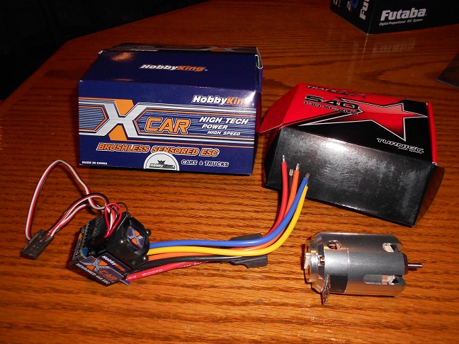

No work tomorrow, so I think I'll tackle the electronics tonight....weeeeee!
