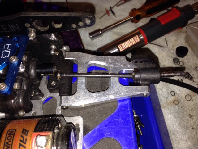

9mm longer than a b4 bone, but is probably more than you want.

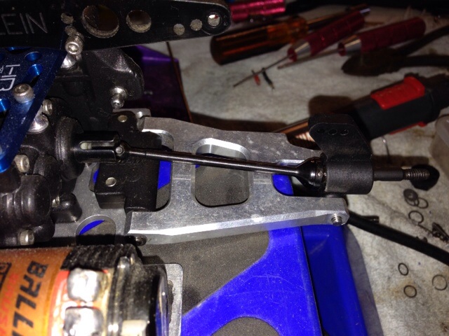

Here it is one pic is with a b4 cvd and one pic is with a b44 cva... Are the newer b/t4 outdrives any longer maybe? I need aomething about 5-6 mm longer than a b4 i think
