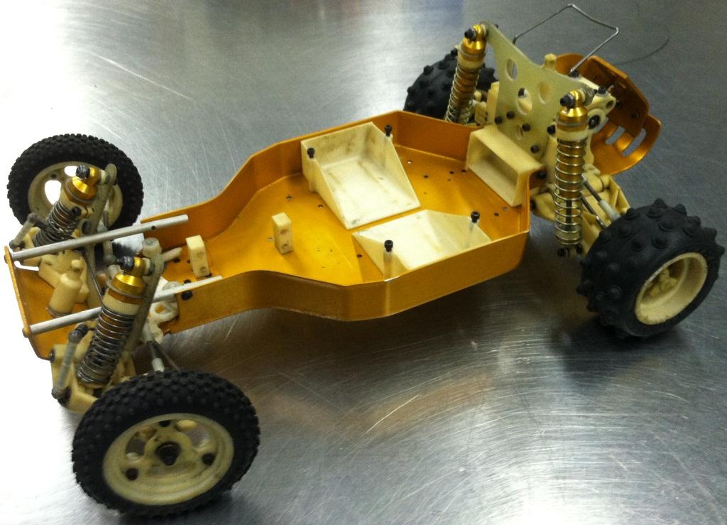

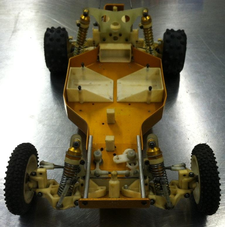

So here it is in all of its dusty, yellowed glory. Hopefully I will do it justice and bring it back to a proper retro racer. It started out as a bushing car but I will replace all of them with bearings. Overall the car is in pretty good shape. All of the aluminum is straight! It has obvious signs of use, but it's gonna hit the track when I'm done, so no need for a full resto. I hope to keep a tally of overall cost as well. Hopefully give some of you guys motivation to get an oldie up and ready for next year!

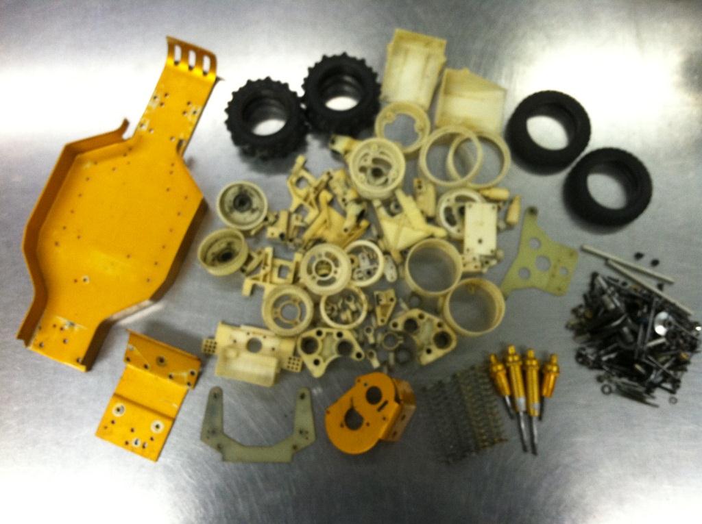

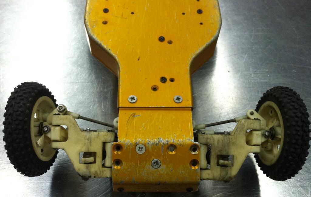

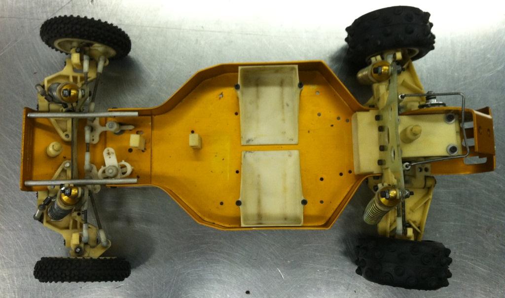

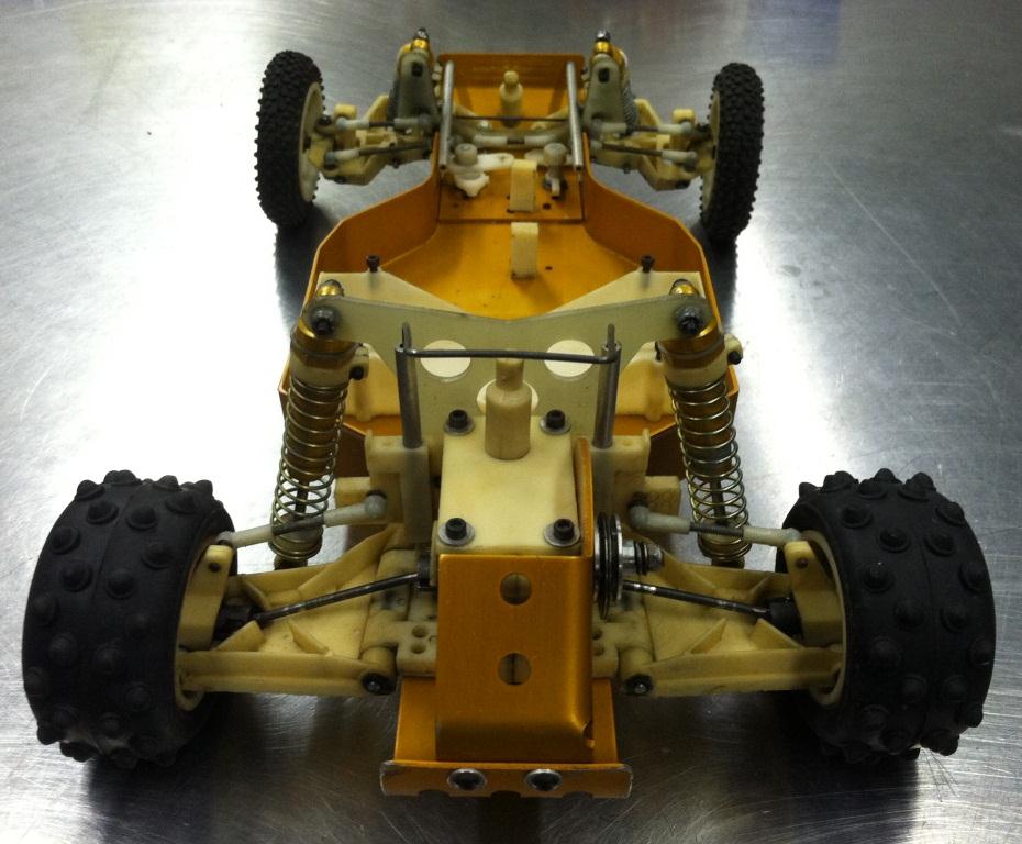

Upon disassembly, I found the front suspension to be totally bound up. Whoever built the car evidently didn't have any repsect for plastic being softer than metal. The top locknuts on the shock mounts were so tight, I will not even be able to reuse the squashed plastic shock bushings. They also found it cool to sandwich in long springs on the short shocks.
None of the shocks hold oil.
Every bushing on the car is toast. Tranny as well. Luckily the gears didn't take too much abuse from the excessive play. The front axles will need replacement as they were wore down from friction. Rear axles had a lot of wear in the dogbone slots, one was cracked with a 1/4" gap where there is usually 1/16".
The steering draglink and steering links were completely assembled wrong.
The only damaged parts I found (besides wear from bushings) was the rear axles and the front arm mount on one side had a crack in the front mounting screw hole.
On a positive note, the thing doesn't smell like a mouse house or cat pee.
Off to soak in simple green.

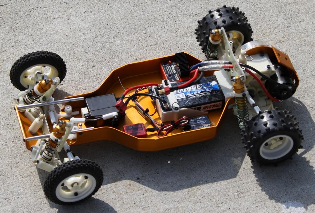

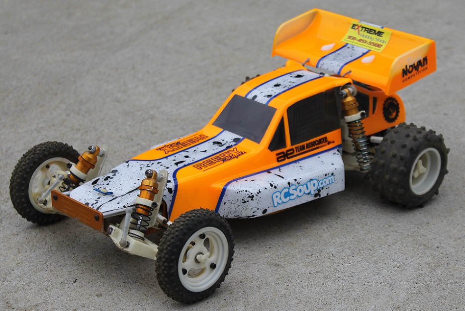

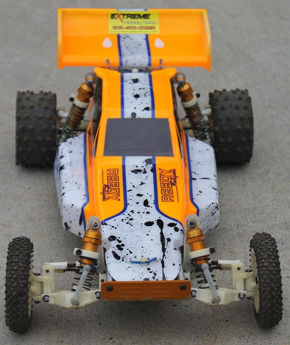

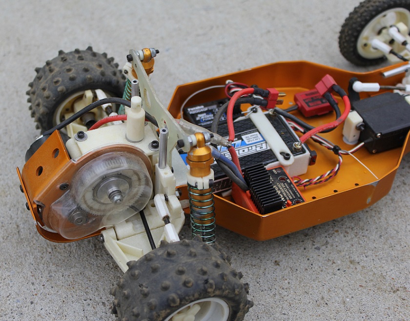

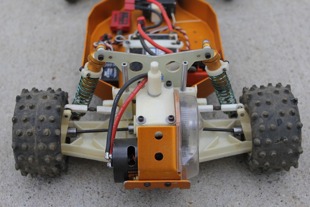

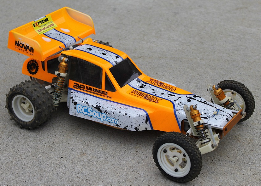

OK time for an update....
Got my parts cleaned up, purchased what I needed to get the repairs done, and it sat in a zillion pieces in a large ziplock bag until the end of august.

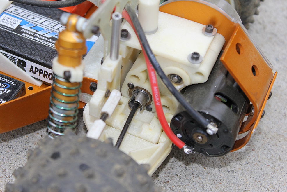

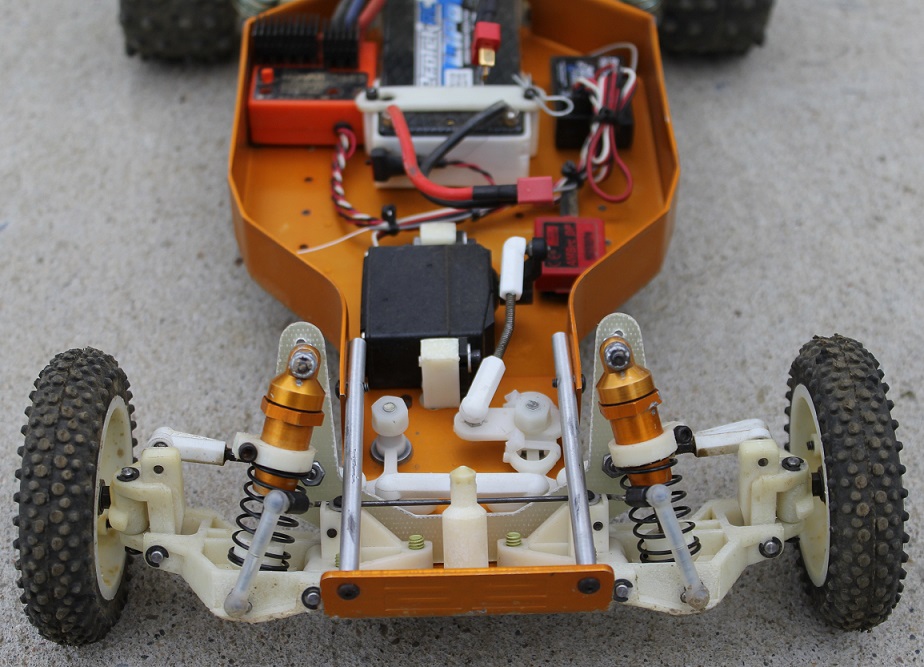

With the vonats right around the corner I figured I'd better get it together. Everything went together pretty well. Nothing out of the ordinary. Ended up using a new set of #1 AE pistons with 30 wt in the rear, 35 wt in the front. Used AE black springs up front, greens in the rear. Borrowed my shorty pack from my X6, battery cup held down with the gray 3M tape. I tossed the spur gear, it was toast. Had an extra 48 pitch spur, 81 tooth. Pinion was a 21 tooth. Guessed at the gearing, but with the Tamiya sport tuned motor, it worked out pretty well. It was slightly warm after the 6 minute qualifiers, pack only needed about 1000mah to charge back up.
All bushings were replaced with bearings.
No breakage all weekend long. Tranny held up just fine. Ran good with exception of a lack of rear traction. But that was to be expected with the old rear tires. Couldn't do much with the guys running the Tamiyas with new rubber. It didnt take much throttle to get myself in trouble. Qualified 3rd in the A main, finished 4th.
Overall, minus the electronics I already had, it cost me about $100 to purchase this car and buy everything to get it repaired and ready for action. Lots of fun wheelin this old '10 around the track, that's for sure!

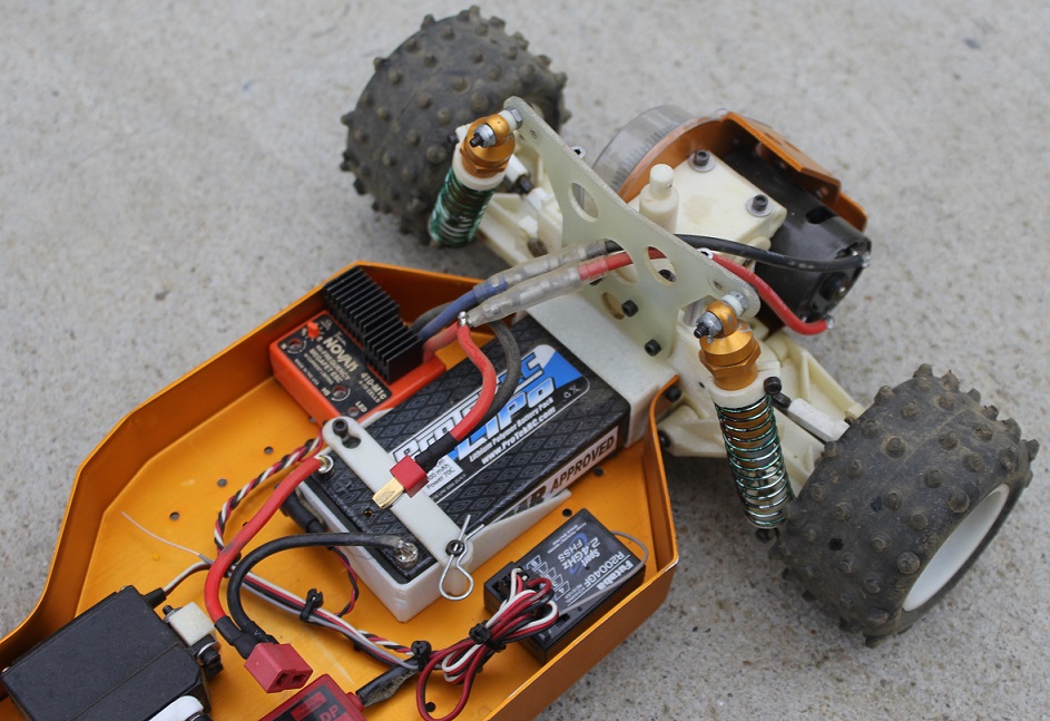

This pic is of the car after finishing the build. Amazing what a little simple green and a peroxide bath can do.
I will get some more post race photos up shortly.
