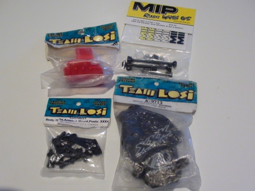

got thes nice old bits . just need a few more bits . to get going on #2 .
hopefully next month get going on the build

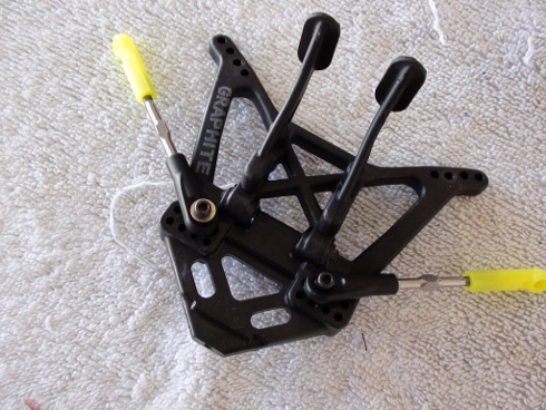

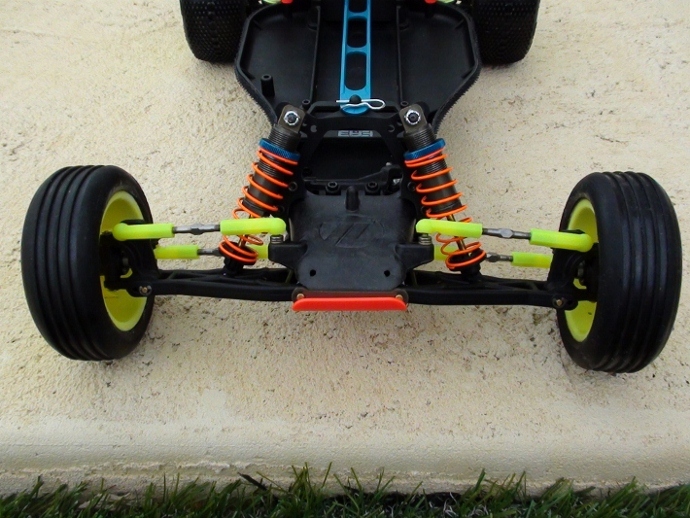

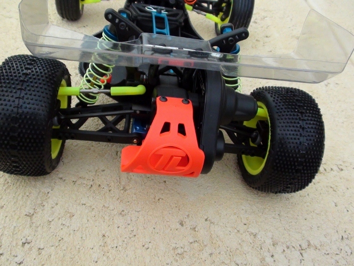

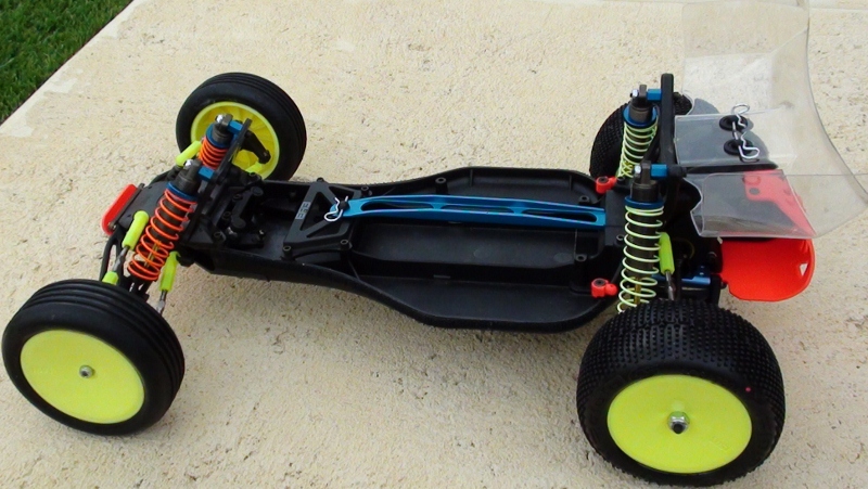

i had some parts turn up last friday for my #2 shelf queen
and done some work on the buggy today .
had to do some . mod work . as the older trinity motor plate has only 2 holes in it for the older gear cover . so drilled and tapped the third hole to take the xxxcr gear cover . i did a ok job .
allso the rear inner camber links break the ball stud so i use a ball link end with a longer screw . not planing on racing this buggy but you never know so i got it ready as if i wanted to race it . allso put some weight in the front bulk head . 20grams .
shes about 95% new .
one day i will get the bodys painted up . and add the xxxcr stickers , cant wait .
i should get this finished this week . the bodys i leave until later .
enjoy the pics .
