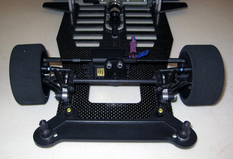

This past weekend at RCX I met a gentlemen from Associated and chatted up mostly pan car stuff. Don mentioned that Hyperdrive had in fact developed front bulkheads that enabled one to utilize the R5 front suspension on the older Associated pan cars that used the 8-32 hardware. On Monday I contacted the good people at Hyperdrive and they confirmed that they were available and they pointed me to a local distributor. I still loyal to Associated's dynamic front suspension, but with the adjust-ability of the newer R5 suspension, you can't beat it...
R_
rooster
Posts: 80
Joined: Mon Nov 30, 2009 3:08 pm
Location: Surf City, USA
Re: RC10L Chassis...
Post by rooster »

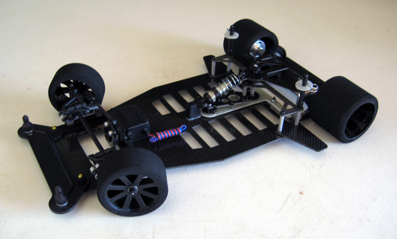

I finally got a chance to assemble a 10L with a R5 front suspension.
As a front brace, I ended up using one from a RC10L2, it fit with out any modification.
I completed the build with HPI components that had purchased throughout last year.
R_

WOW! that is saweeeet! :shock:
unclemikey1978
Posts: 201
Joined: Mon Jul 25, 2011 1:12 am
Location: Atlanta, GA
Post by unclemikey1978 »
Sexy!
Klaus69
Posts: 4
Joined: Fri Jul 23, 2010 2:17 pm
Location: Germany;- near Hanau
Post by Klaus69 »
Incredible work!
Do you use this one or is it just a shelf queen?
If you use it i would like to read something how the car handles...
Thanks in advance:
Klaus from germany

I ended up building another 10R5 front end and installing on a older RC10L, instead of a graphite version, but a G-10 glass version. Surprising the car handled very well and easy kept up with the newer pan cars. I did have to purchase shims and dial in the front end as if it was a newer 10R5 car.
After several attempts, I was able to tweak the front end enough so I was able to be very competitive with the local racers.
One of the local racers saw what I did and installed a similar kit on a RC10L2 and after shimming was also able to compete with the newer cars.
Good Luck!
~R
