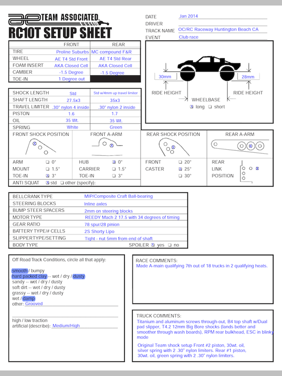

Here is a setup I have been using for a couple months now and really like.

How's the feel with the front shocks so upright?

It runs pretty good, but now that you pointed that out I noticed that I forgot to mention I'm now running the T2 front shock tower. The shocks are a little more at an angle now but i really like how it handles for me.

I just saw that in your thread. The late FRP tower on that sheet is at least one hole wider at the top, maybe more.

Yea it's wider and slightly taller. If I was using the original I would be using the middle hole but felt the T2 tower was a good compromise, plus I like carbon fiber.
