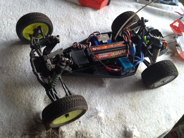

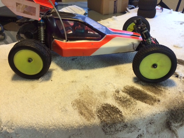

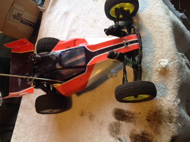

Re: B3 Upgrades
Not much to see but here you go. The electronics are not ideal, I have my esc to receiver wire running over the battery instead of under and there is way too much wire on the esc that I have not trimmed down. The back rims were give aways from a bin at the RC shop that I modified to fit. Basically just took it off the shelf and got it running again, still novice to restoring my b3.

Re: B3 Upgrades
Looks good
If you need wheels, you can use Thunder Tiger Phoenix buggy wheels, they are essentially the same minus the plastic itself.
I'm surprised they let you run a Reedy 3300 in 17.5, I was under the impression it was more like a 13.5?

Re: B3 Upgrades
+1 on the Thunder Tiger wheels. Those look like b4 wheels in the back, whatever they are they don't have enough offset. Your rear track is too narrow.

Re: B3 Upgrades
Funny, I also thought the Reedy 3300kv was equivalent to a 13.5 turn. After smoking all the B4s with my CE and a Reedy 3300kv in the bomber class, I was told the motor was banned as it actually specs out closer to a 10.5teman wrote:I'm surprised they let you run a Reedy 3300 in 17.5, I was under the impression it was more like a 13.5?

Re: B3 Upgrades
Good call on the rims I will get those switched asap. The motor is actually a 3900KV guess I'm running hotter than I thought.
