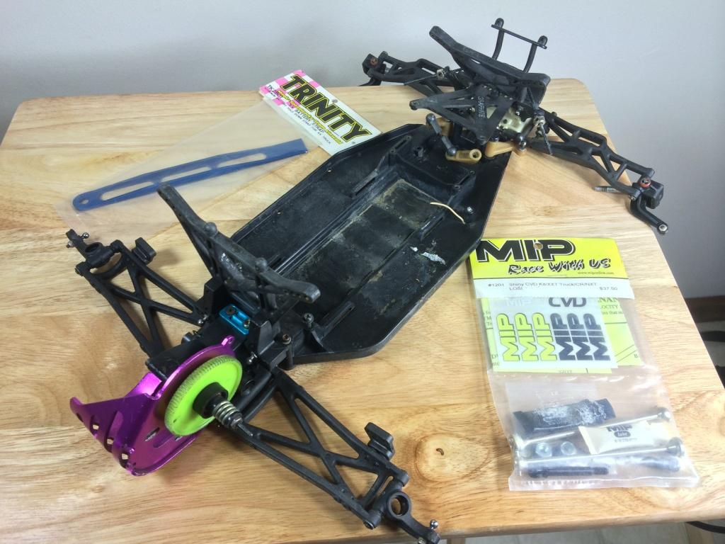

Here's the project I picked up along with a couple of goodies I've found already. I couldn't resist that purple motor plate! Anybody know if those were factory? The chassis is a little rough, it has a lot of old glue and junk on it including some nasty old foam glued in the battery tray. This will probably be a real slow build as I collect parts and finish up my RC10 projects. Anyone know some solvents that are safe on this plastic that will help me clean off the the old glue and junk? Many of the parts are the 'Graphite' versions.

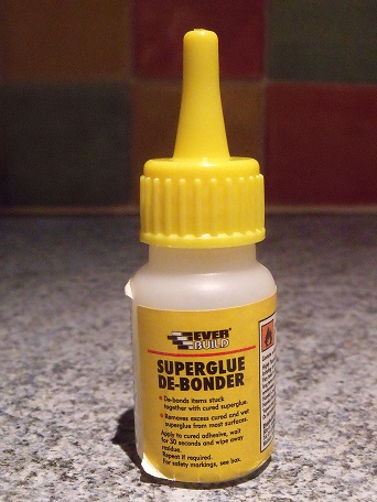

MAC10 wrote:The chassis is a little rough, it has a lot of old glue and junk on it including some nasty old foam glued in the battery tray....... Anyone know some solvents that are safe on this plastic that will help me clean off the the old glue and junk?
If it's just servo-tape type foam glue residue then WD-40 and any automotive disc brake/ clutch cleaner is what I use with 100% success. However, if there is also the remains of old super-glue then I use a super-glue debonder such as this:
Ever Build Superglue Debonder
De-bonder 005c.jpg (109.24 KiB) Viewed 2543 times
The above brand of debonder contains Heptane and nitromethane and works quickly to soften old superglue deposits which can then simply be wiped away. Just bear in mind that thicker deposits take longer but can again be removed with 100% success.
