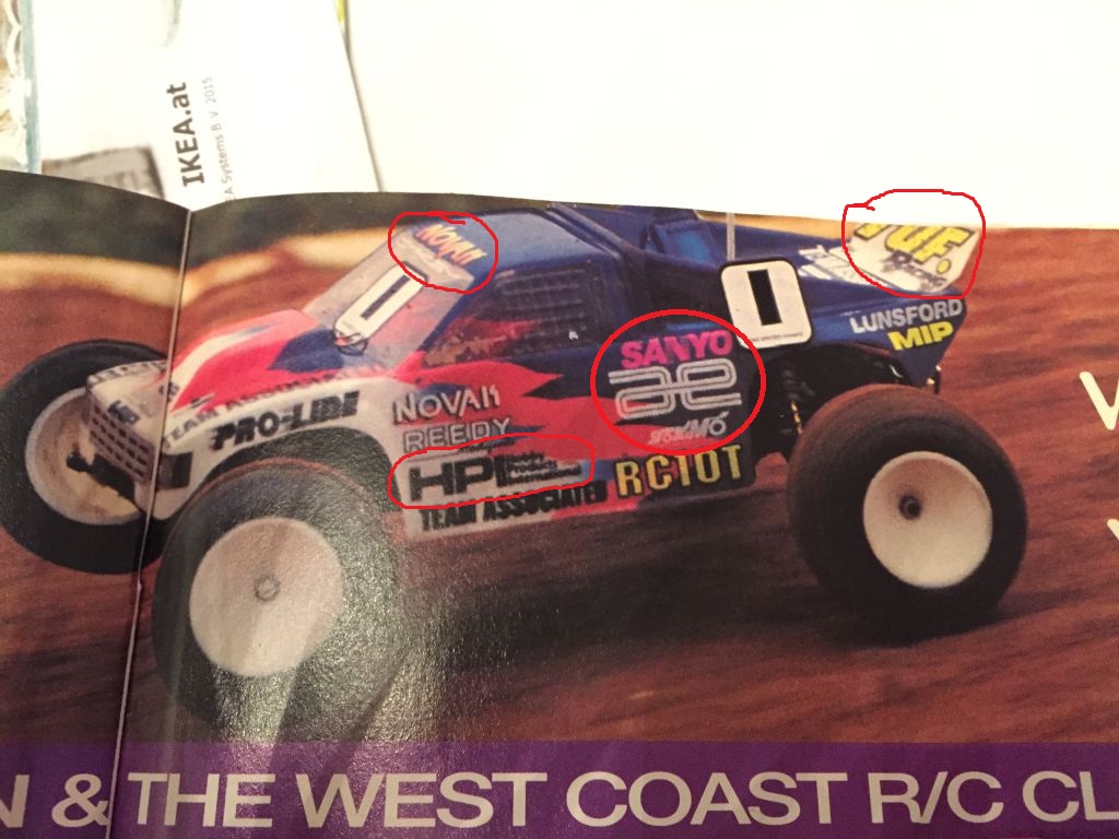

Before I start I want to ask you if you have some more pictures/informations about Marks 10T he drove at the 1994 Florida Winter Champs. I have the 1994 RCCA where his car is pictured and the 1995 RCCA with setup and electronic informations.

This is a nice choice to build. Not sure why you circled sections of the truck in red. I assume you are looking for those decals.
The TUF Racing decal is from dirtbikes back in the day, TUF made parts and were a factory team. I think they are UFO now? The other decal should be easy to find. The Oakley decal looks like the same one on the rere worlds car.

Look forward to watching this build. I think the "Team Associated" on the hood may be hard to find if you haven't found it. I don't think I've seen a thin font like that before.

You`re correct with the assumption about the circles around the decals. These are the decals I`m looking for, which are still missing. Now I have to add the Team Associated decals mentioned by romulus22. Thank you very much at this point to you romulus22 for this Information!

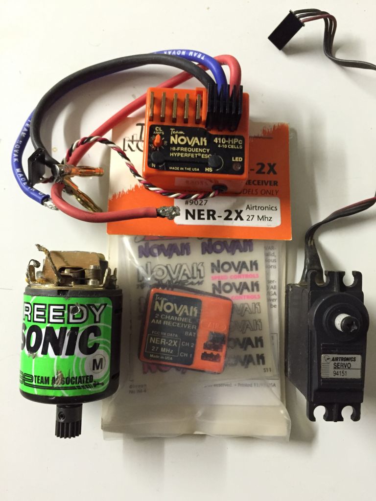

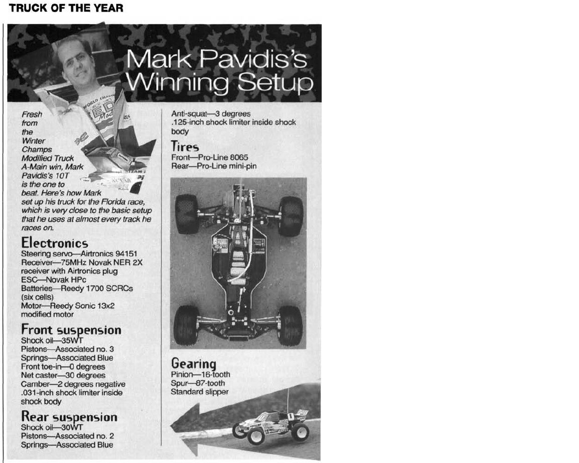

I`ve done some more research and here is a scan from the RCCA 09.94. Plenty informations about Marks car are included but at least one is wrong because he didn`t use a Novak NER-2x receiver. He used a NER-3FM receiver because the crystal is at the top of the receiver. At first I was extremely happy because I`ve a brand new NER-2x but after a closer look I noticed that it was a wrong information. So back to start for a Novak NER-3FM receiver in 75 Mhz. I have also a HPc-410 which I`ve bought some time ago but now noticed that it has no switch and FET wire. Did Novak deliver the HPc also in such a configuration? Motor and servo is fixed.
I`ve also a question about the front tower. Do you think it is the later version with 3 shock mounting holes or the earlier version with only two holes?

I think it would be the 3 hole tower, as the two hole type is thinner.
