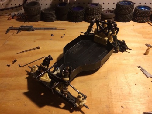

I got this World's Car when I was 14. I was working at the local hobby shop at the time and when it came out I had to have it. I drove it a LOT. Almost daily for years. Then when I went off to college it got stuck in the closet. Now over 15 years later I, like many others, have dug it out of my old closet at my parents house and want to modernize it. I was surprised one of the batteries still held a charge, though only for about 4 minutes. I've been playing with it for a few days and my 2 year old daughter absolutely LOVES seeing it fly up and down the street. I thought about keeping it all old school but the range of the Airtronics CS2P just isn't what I want and if I plan on keeping it for another 20 years I may as well keep up with the times and go LiPo and Brushless.
So I know I need a new Radio and receiver, ESC, Motor, and Battery. Is there anything else I should upgrade? From what I've read, the Stealth Transmission should be fine for all this and I still have some brand new tires so I should be good there for a while. I was curious about all the nylon pieces, I've seen new options in I think Titanium or Aluminum, should I change all that too?
I've read most of the threads about this but most of it seems several years old. I did get ideas for most of what I think I will need to do get it up to par but any suggestions are GREATLY appreciated.

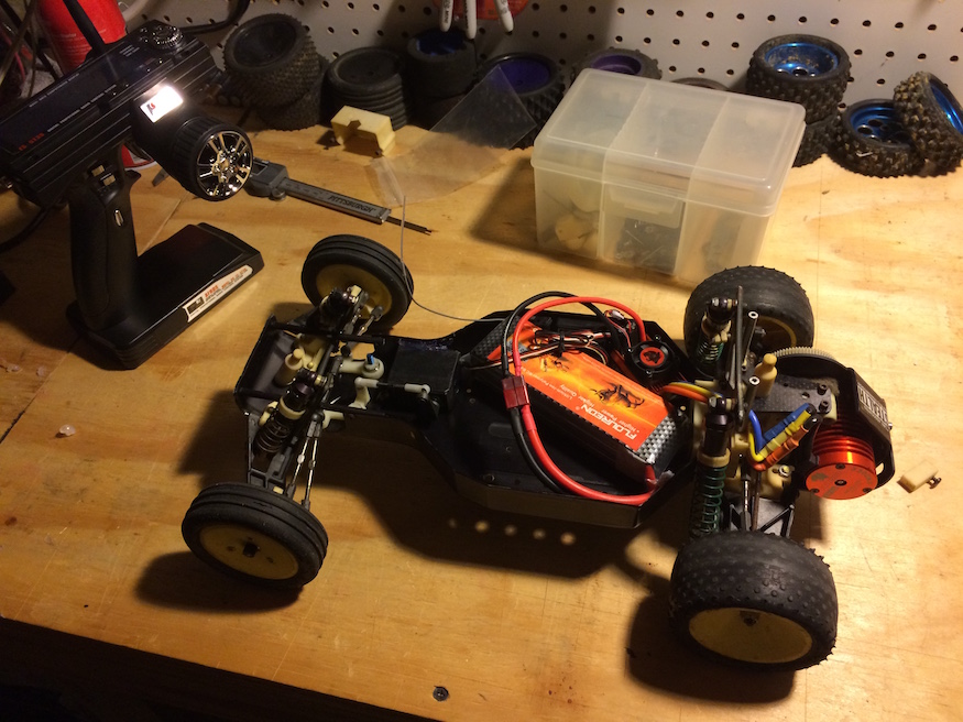

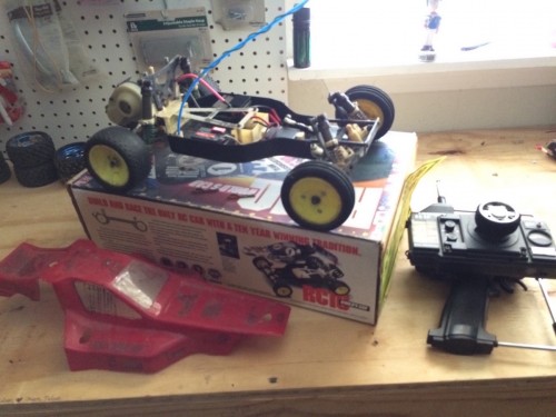

Here is what she looks like right now, dirty and needs some love but all original, for now, an with the box and all te paperwork, not pictured.

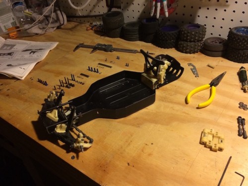

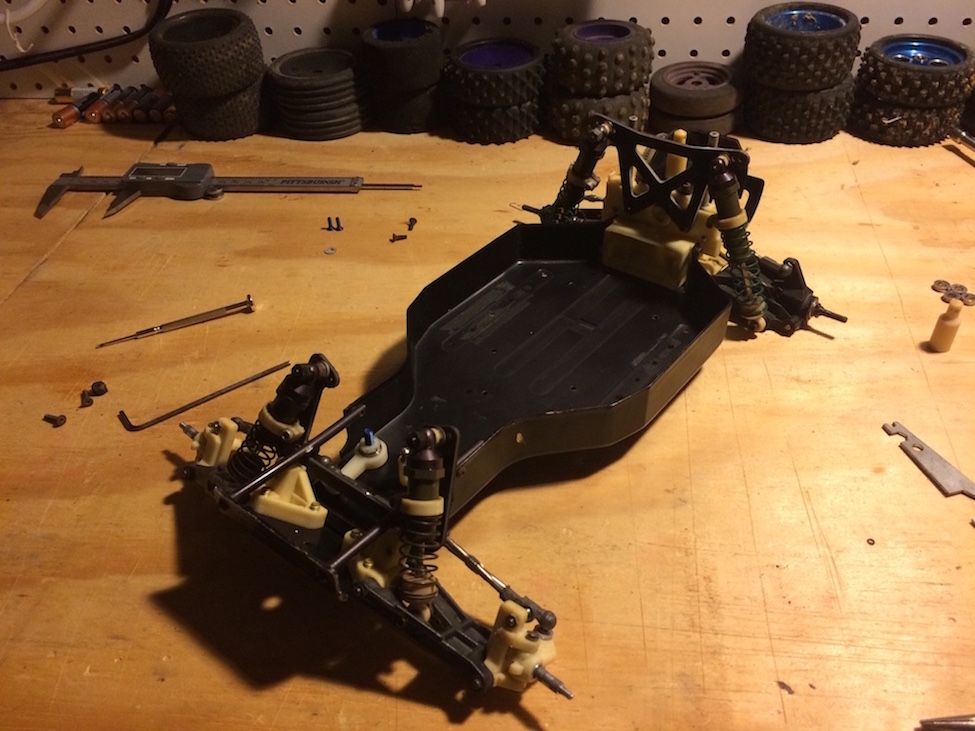

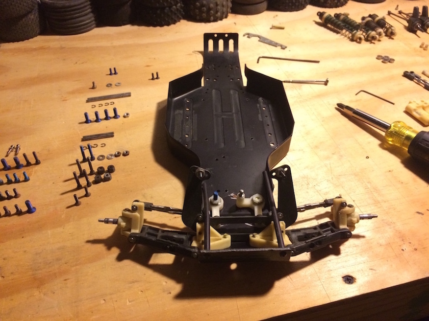

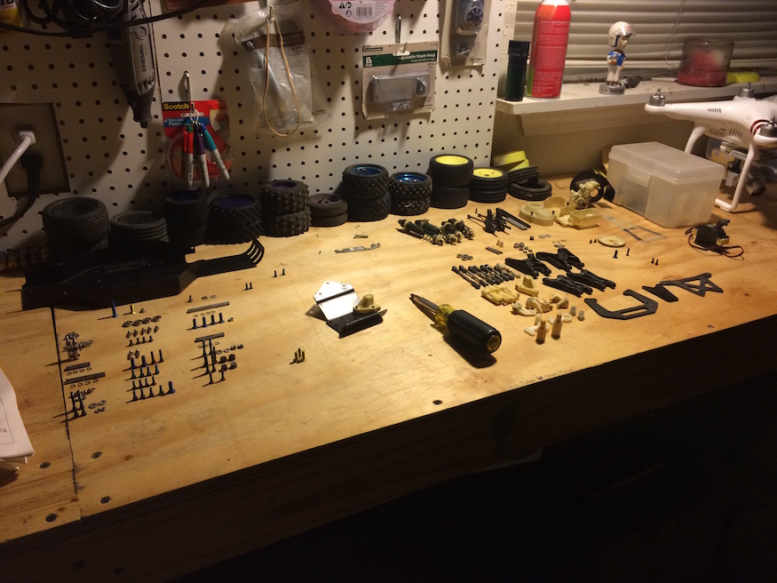

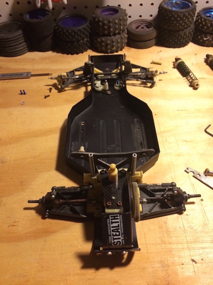

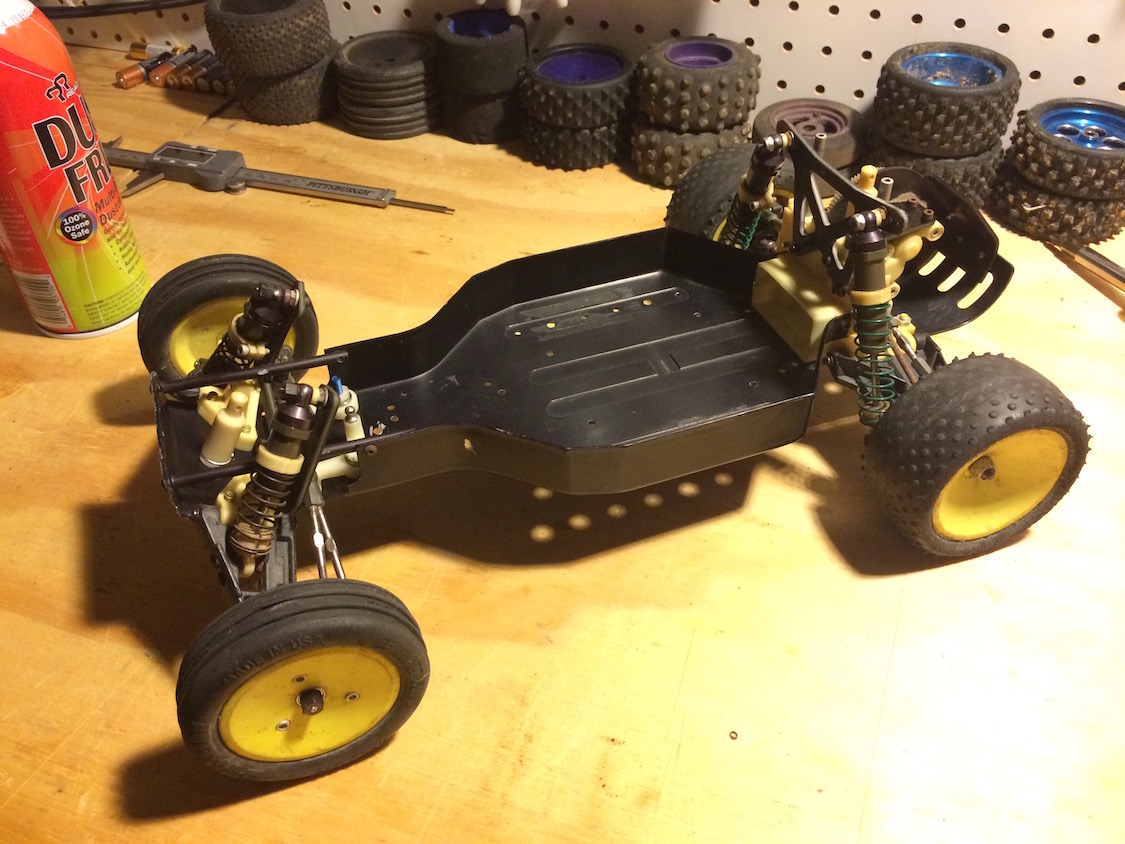

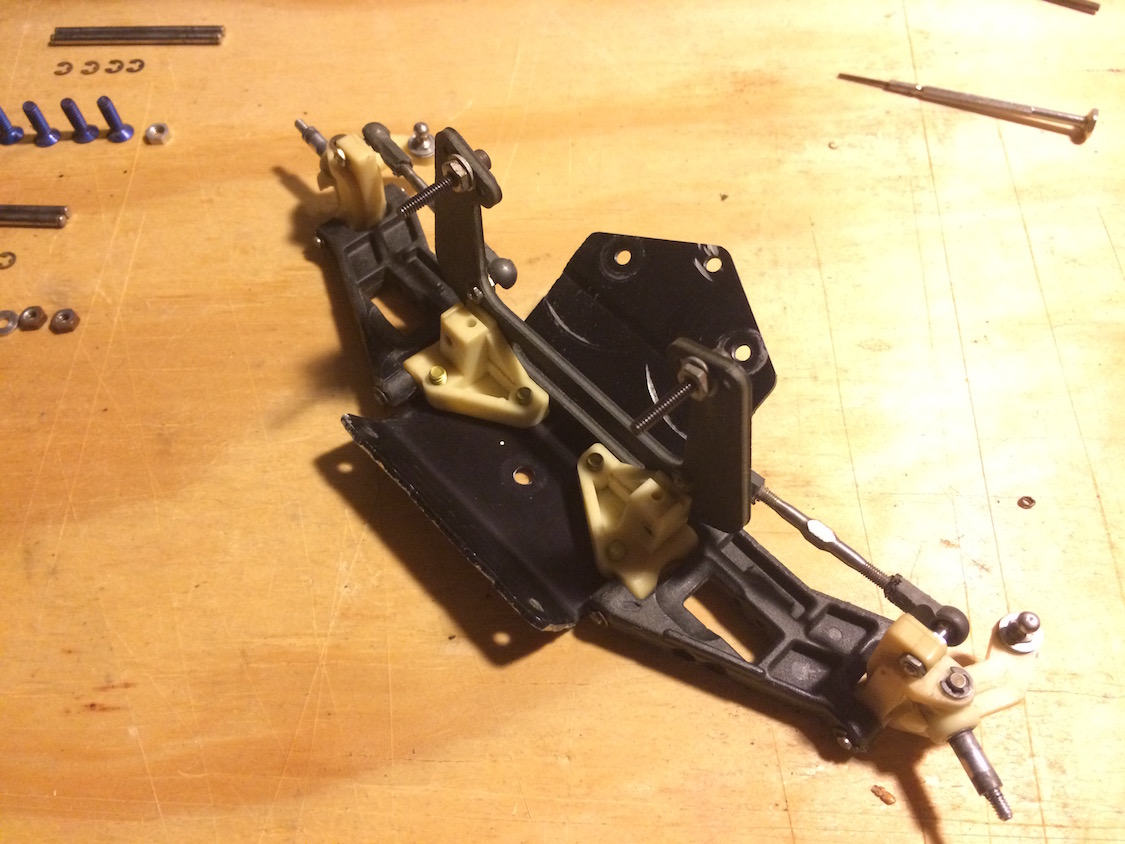

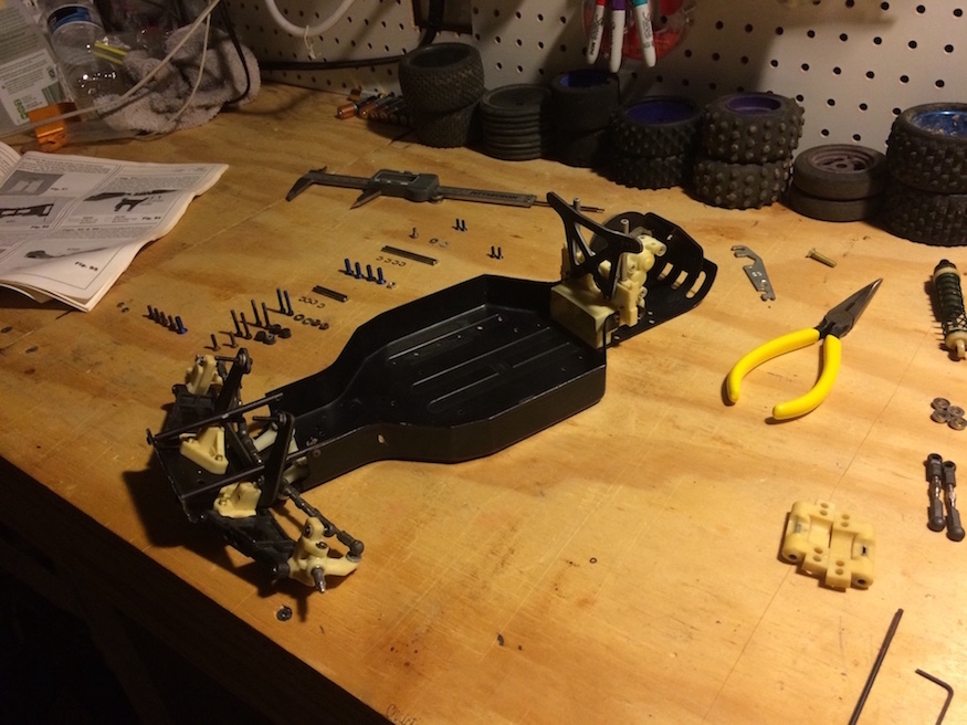

I got in all the parts. When I try to charge the battery, the charger says "Connection Break" I charged some old NiCads with it so I'm pretty sure it's not the charger. I just need to find a hobby shop nearby and see if I can try the batteries on another charger before I get them swapped out. Oh the joys of building. I did manage to get the car completely torn down, cleaned, put (mostly) back together. I need to do something about wheels and tires going forward but I have plenty of old ones to use for the time being.
Ready to start. Front end. Front end attached. Transmission attached. Rear end attached. Shocks attached. Wheels attached. Need to replace the tires before I take her out. Now I just need to install the motor, ESC and servo. Then figure out the battery thing.

Finally figured out that I needed to have BOTH outputs from the charger connected to the battery. All is well. Got the motor and ESC installed. The airtronics servo that I had wouldn't work so I found a Futaba that works great. Te only problem is that the tabs were cut off so I had to hot glue it until I get a new case and rebuild the servo.
Not only is the distance improved from the 2.4 gHz radio, but these new motors and batteries make this thing fly! I had to turn down the timing in the ESC all the way just to control it until I get used to it. It even works well in the grass but I think I'll build an RC10T next for that.
