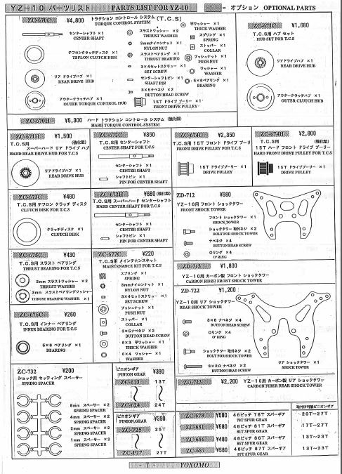

Guys,
Probobly been posted before (I searched, I failed).
Can someone please provide a full parts breakdown for the TCS..
so far I have;
ZC-670 TCS (Torque control system)
ZC-671 TCS hub set
ZC-672 Center shaft for TCS
ZC-673 TCS Teflon Cluchdisk (AS.6585 also compatible)
ZC-674 Front drive pulley (for Ctr shaft)
ZC-675C TCS Thrust bearing
ZC-676C Inner bearing for TCS
ZC-677C TCS Maintennace kit
Outer bearing and outer plate (Attached to spur gear) seem to be missng.
Thanks in advance,
Z

Hi Z,
here is a copy of my Parts cataloge, so you can see all parts listed! ;o)
I think, the AS6585 are different in diameter, i can check that at the evening and may post a Picture too...
mike
mike
Re: TCS parts list..
Ok, i had a look for the slipper discs, i was wrong, i do have the one for the B2/B3, they do have a different number and have larger diameter.
BR
Mike
BR
Mike

Ok, Thanks! It just adds confusion to my trying to keep up with Yokomo design changes. Ive been trying to nail down shock tower differences, and if thats a 94 manual, then Im still confused. Dont want to hijack this thread,,Thanks for the info!
- Posts: 578
- Joined: Tue Feb 25, 2014 3:55 am
- Location: Nottingham, UK
- Been thanked: 3 times
Yeah there the 94 towers from the factoryrccars4sal wrote:Ok, Thanks! It just adds confusion to my trying to keep up with Yokomo design changes. Ive been trying to nail down shock tower differences, and if thats a 94 manual, then Im still confused. Dont want to hijack this thread,,Thanks for the info!
