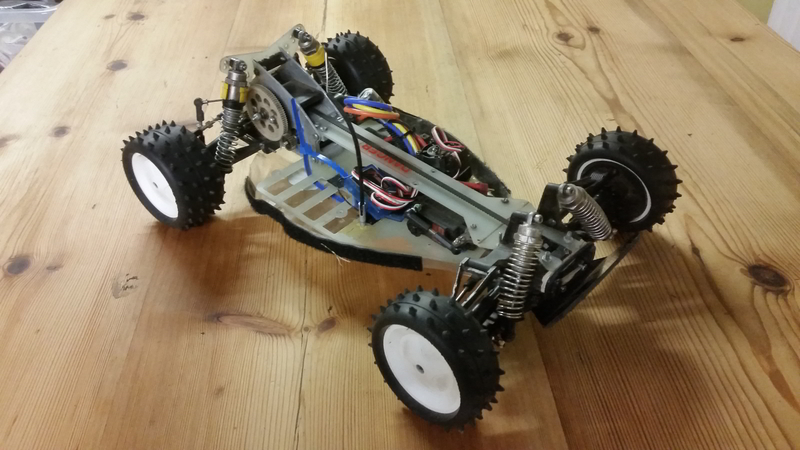

Progress report :D
I have have decided to go with the standard Super Diff for now. I want to use my Alloy Rear Diff but it requires a bit more work to get it going. I discovered the steel washers were just glued to the washer carrier, no friction paper in sight, and the join has failed. I tried using some spare alloy washer carriers but I will need to find a bearing that will sit inside of it and support it properly on the axle.
So for now here is my rear transmission assembly. With a nice picture of my alloy inner transmission housing, I don't no why but it is my favorite part of the car. 8)

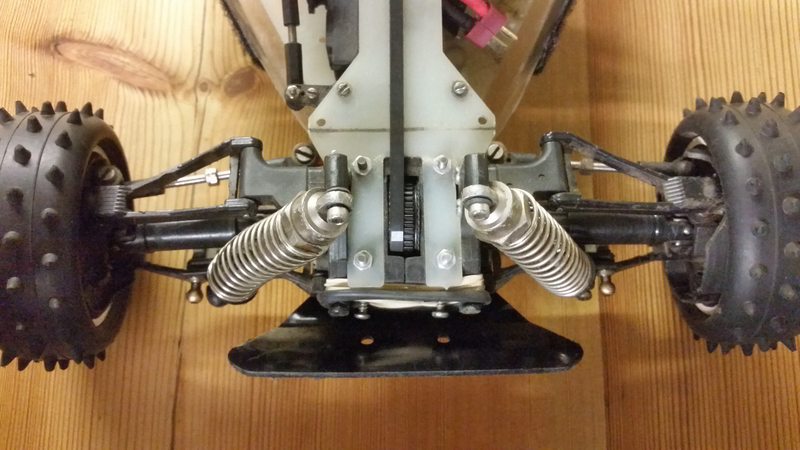

I made some progress on the car over Christmas.
Still plenty to do but I should have all done in time for the Brett Davis Vintage GP :)
The chassis had hard deposits of glue in several places but it cleaned up well with a fine grade sandpaper and solvents.
I picked up of few carbon goodies for the rear suspension and steering assembly.
The front hub carriers look to be original ProCat cut down to look like BossCat ones and I have used BossCat rear hub carriers and modern turnbuckles to complete the rear suspension and steering.
A ProCat I bought for spares came with Kyosho Gold Shocks, they are in good condition and a nice period upgrade over my original shocks, I just need to work out what grade shock oil and spring rate to use.
I am using a brushless system and lipo saddle packs to power the car so had to work out how to mount the batteries and settled on using mounts from an SX3, I had to drill four new holes in the chassis to fit them, but I think its worth the sacrifice.
I would like to get peoples opinions on using modern parts like turnbuckles to complete a car entering a vintage race is it OK? If its OK to use modern electrics surely modern turnbuckles are fine. :?

Based on my experience of The Iconic revival and other such events, modern turnbuckles will not be a problem - rules are generally relaxed towards upgrades in the interests of reliabilty or availabilty - for instance, you regularly see modern shocks and 3D printed parts used, so long as the buggy maintains the spirit and DNA of the original
CVRrc
Posts: 28
Joined: Thu Oct 27, 2016 2:22 pm
Location: Southampton, UK
Re: ProCat - Restoring to Race
Post by CVRrc »
Danf1275 wrote:Based on my experience of The Iconic revival and other such events, modern turnbuckles will not be a problem - rules are generally relaxed towards upgrades in the interests of reliabilty or availabilty - for instance, you regularly see modern shocks and 3D printed parts used, so long as the buggy maintains the spirit and DNA of the original
Thanks that puts my mind at ease.

The body and wing are painted and fitted :D Its a very fiddly job getting the shell cut and holes in the right place for the undertray but now it done incredibly satisfying. There are a few small jobs to do before race day but I couldn't resist taking a few pics.

Great result - good luck racing
