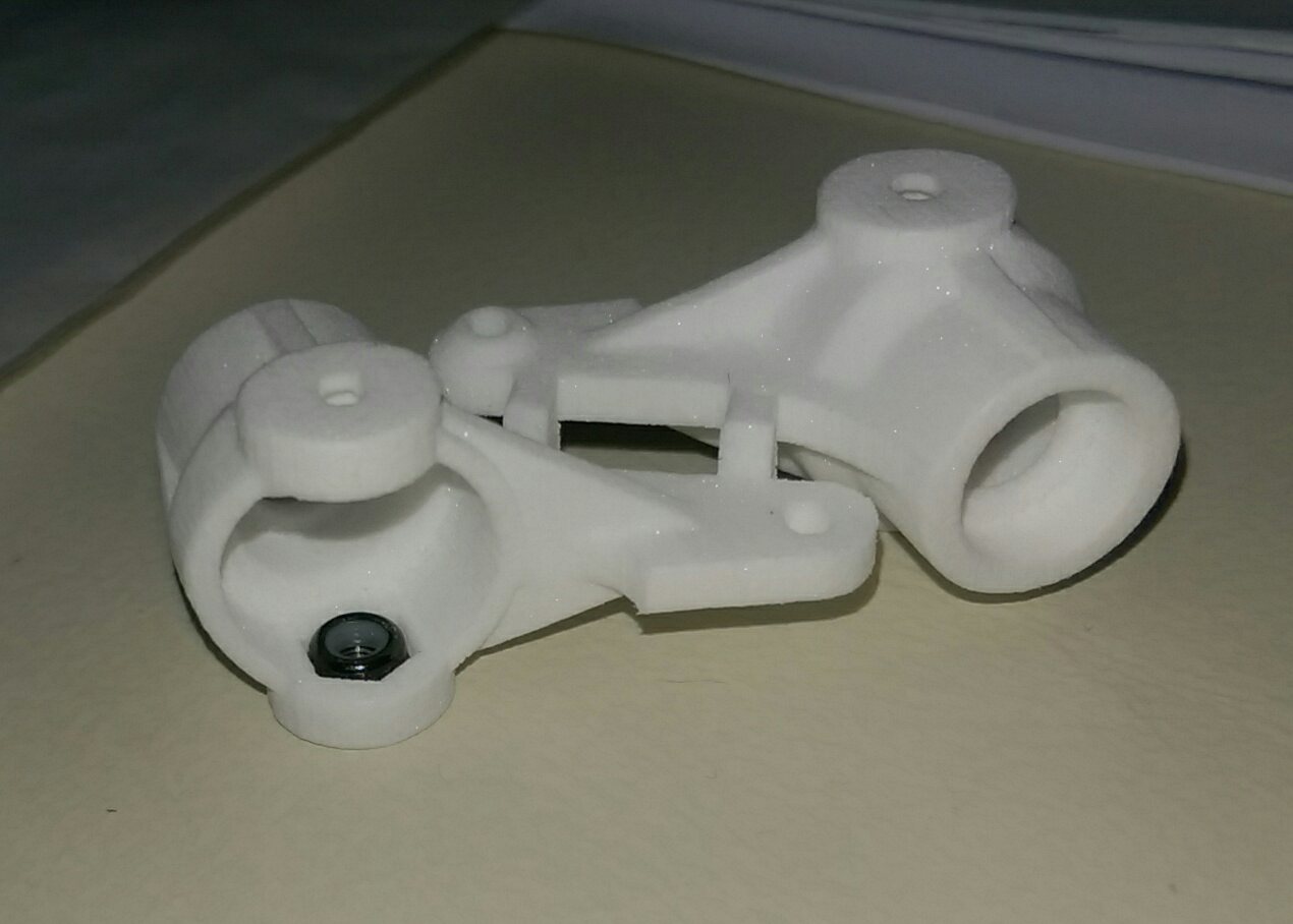

Also redesigned the knuckle arms and will be testing but believe its designed correctly, just need to test the strength. Thanks to Niki for doing this and is on Shapeways now.
