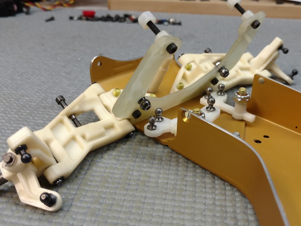

So I decided, just because I want it done, to continue on the path I was taking. Stick with the parts I have on it and dig up the rest of the stuff I need..... hopefully in similar condition. So I think I have enough usable full hex ball cups, I have more than enough shock hardware, found a pair of 25* castor blocks, inline knuckles with hex axle, nose brace and wing tubes, steering bellcrank parts, hinge pins, etc. Also, looking at the pics of the actual car, It seemed to me that Cliff used Yokomo ball studs on the suspension parts. You can see they are black, and slightly longer than the short AE ball studs. I happened to have a package of them so that's what I used.

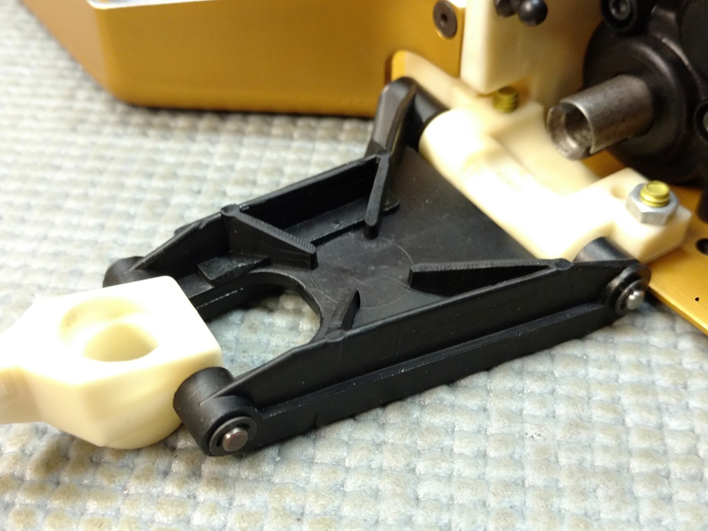

I also noticed that Cliff tapered the ribs on the top of the rear arms. So I did that quick and threw the arms back in the black dye.

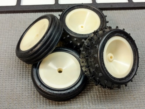

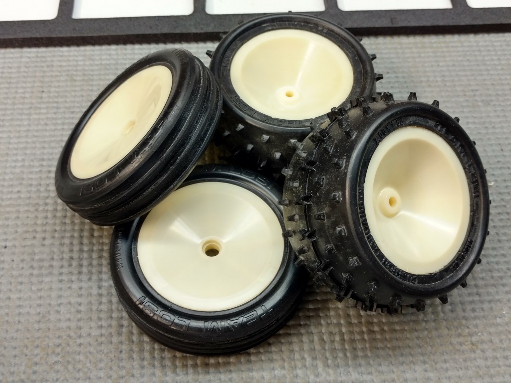

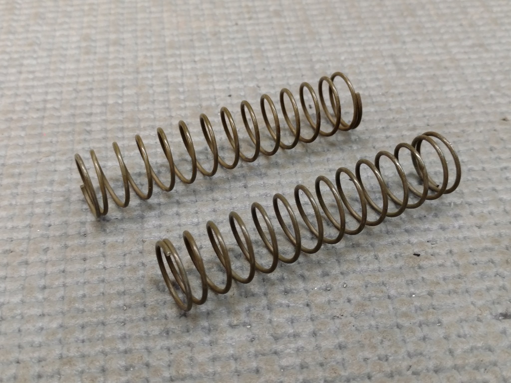

I've had a single olive drab AE spring forever waiting to find it's mate. I didn't go to the track today, so I ended up doing some clean-up on and around my main workbench. Looking through boxes i haven't opened in awhile, putting stuff that's been sitting out into boxes...... stuff like that. Well in doing so, I found it's long lost love.
Now I just have to find a pair for the front.
And I dug out the tires and cleaned up a set of wheels. I need to spend a bit more time trying to get that mold release crap off of the tires.

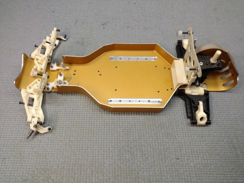

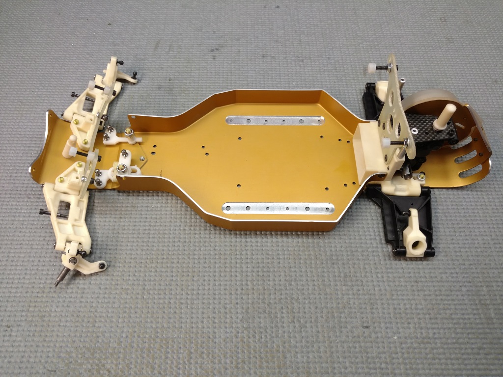

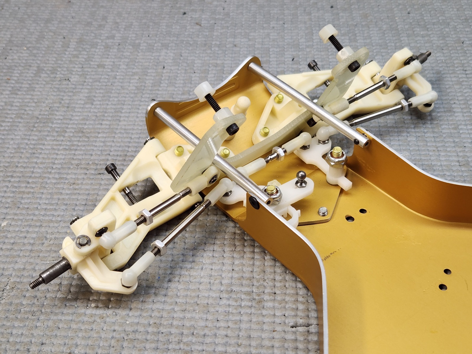

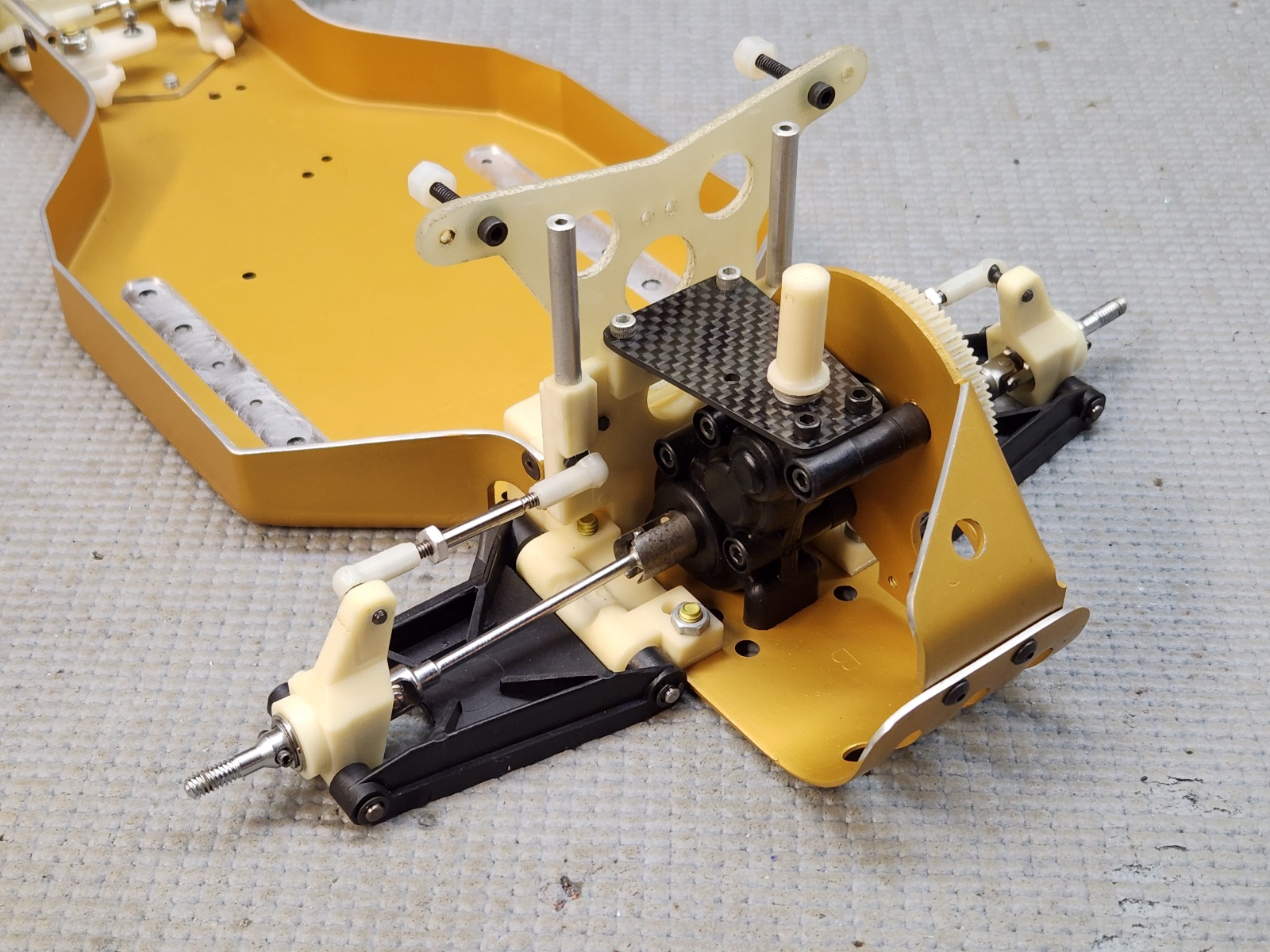

I realized tonight that I did actually move this build along since the last chassis pics. Turnbuckles and ball cups are on. I also had a pair of AE universals chrome plated and installed. Oh, and the nose tubes.
