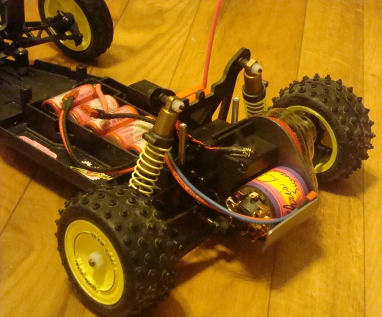

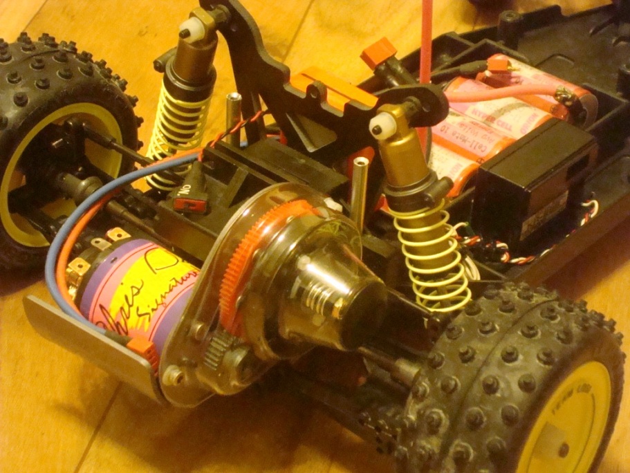

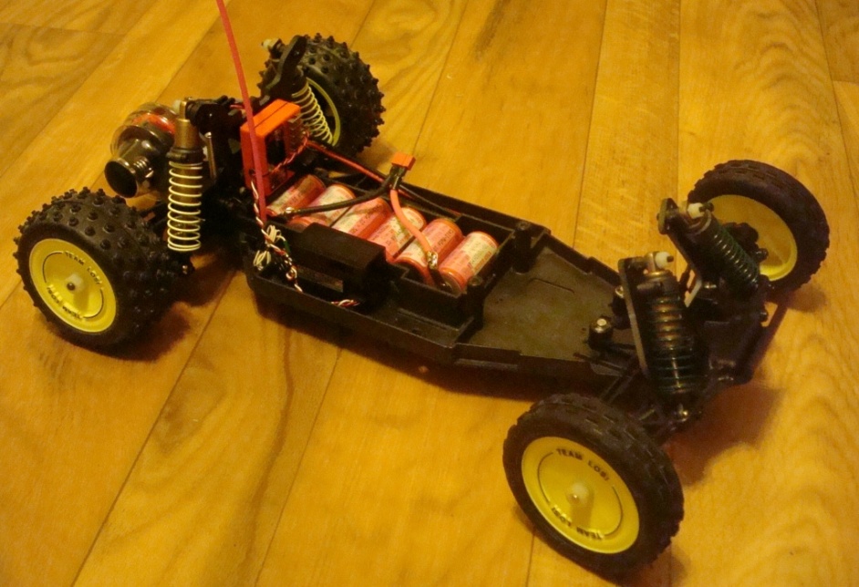

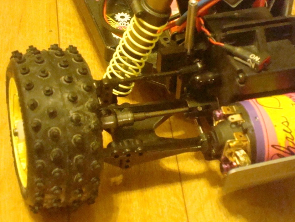

I haven't seen this one attempted yet, and I have a spare Pro SE gathering dust, so what the heck. I will probably be pulling from a lot of you guys here for help on finishing up the details.

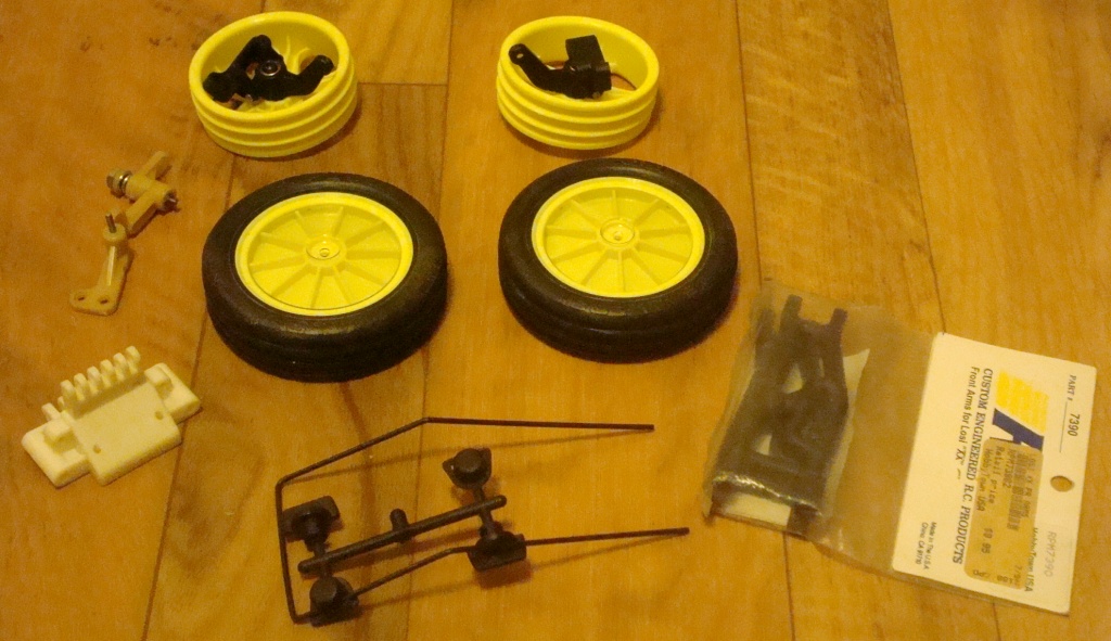

I am trying to keep close to the car that Kyle drove, but I'm not going to kill myself too much on the details. Like the motor for instance... He ran a Trinity Chris Doseck mod motor, which this car has, but is a later model with a different decal. The front end on this car will be the biggest task, as they incorporated the XX front end onto this Pro SE. I plan on grafting a XX chassis onto this one to get the same effect. I do not have what I need to make my own arms, maybe I could get dynotech to pop something out for me. Until then, RPM will have to do.
I guess I will have to paint my own front springs, as I don't believe Losi ever offered a set of fronts in that color?
Does anybody have a used XX chassis and upper brace they would like to get rid of?

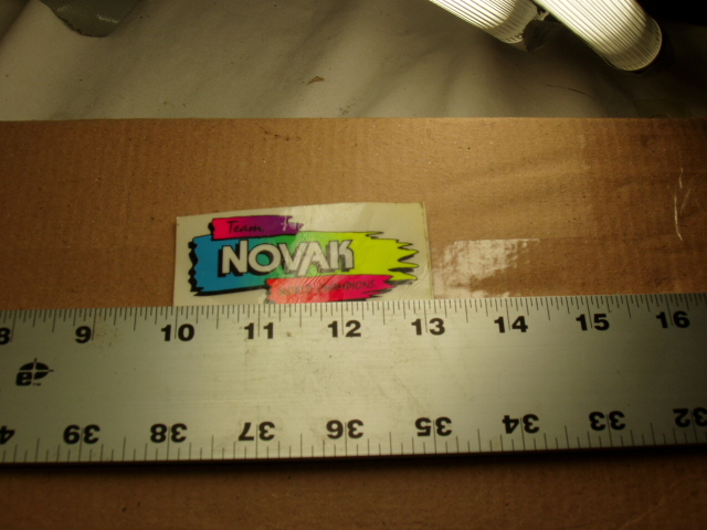

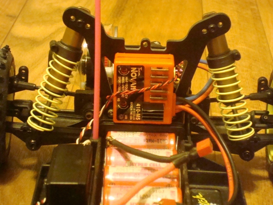

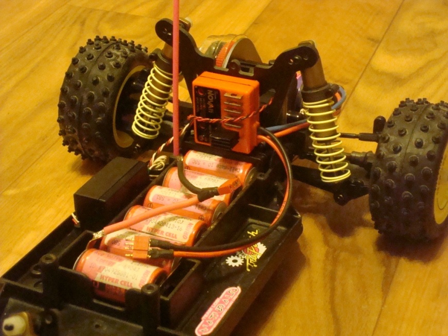

I also need a white "Team Novak" decal for the top of the receiver.
And a JG mini front bumper for a XX.....

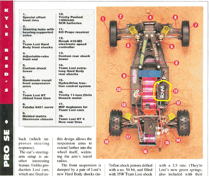

The springs, both front and rear, that Kyle and rest of the team used during this period, were from Team Losi's special "spring box". There were more than twice as much springs to choose from than there were publicly available. The RCCA text said that the fronts were standard green, but with yellow paint, but they look different. Standard greens did have more turns than those on Kyle's car. The rears might be standard reds, but with yellow paint on them.Brandon G wrote: I guess I will have to paint my own front springs, as I don't believe Losi ever offered a set of fronts in that color?
Shock towers have more shock mounting positions, 5? in rear and 4? in front plus four huge holes to make them lighter. Rear shock tower is also something like 1,5*thicker than stock Pro SE.

Reading the article it says the springs were the soon to be released red's. I think the front shocktower is an LXT that had been cut down and drilled. The rear I believe is a composite craft. I think I remember them having more mounting holes.

i say just drill a couple more holes in the rear tower you have and call it done. atleast one more on the inside. other than the holes, the one you have looks damn close.
i looked though my decals and didn't find a white novak decal like that. just an orange one. sorry.

I think I will do just that with the rear bulkhead. Like I said, I will like to get it close, but I'm not gonna get too hung up on it.
The paint is the big thing. Next is the front end of the chassis. Then getting the motor plate anodized blue and then "lightened" on the Bridgeport.
Thanks for looking thru your decals Jay. I did the same, but my Novak sheet that would have had it was the only one missing. Figures.

i was thinking epoxy paint also brandon.. i have the novak decal for you but the word "team"
is written in black and wont show up on the chassis. up to you dude.

My plan: Get a XX chassis and upper brace. (I already have the front bulkhead)
Mill off the front of the SE chassis and also mill 1/2 the thickness off the front. Mill off the back of the XX chassis and then 1/2 the thickness of it in effect to make a lap joint. Superglue the 2 together.
The upper brace will be the same way, except I plan on using some kydex as my upper brace. Then cutting the kydex to the desired shape.
Doing this will allow me to use the XX steering and front end. Hopefully it will work.

I would use automotive panel glue not super glue. that suff is so strong it will hold a real car together. it would do great on the chassis. I would feel fine about running it with that glue. not so much on the Super glue? just my 2centsBrandon G wrote:My plan: Get a XX chassis and upper brace. (I already have the front bulkhead)

i just picked up about 5 pounds of BITD decals of the bay im sure it will be in there is it the one on the bat hold down just plain white novak inch and 5/8 by 5/8

Its the one on the top of the receiver. It says team novak, all in white. See pic.

the one i have......... the "team" is white, but the "novak" is orange. it's the correct style/size, just that half of it's the wrong color.
