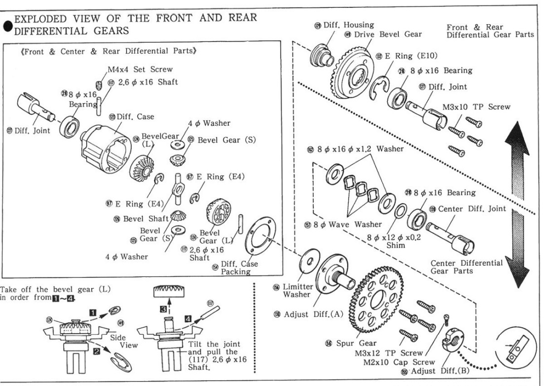

I'm rebuilding a Nitro USA-1, did some research to beef up the diffs and came up with the essentials (BSW1, BSW2, and BS41)
https://www.flickr.com/gp/157316281@N05/3p20U8
My question is, being that I couldn't exactly find the best description online on how to properly build the diff with these *new* parts, is:
Am I missing something that is supposed to hold BS41 together to the rest of the diff? It almost looks as if there should be an o-ring or some sort of washer around the indentation?
https://www.flickr.com/gp/157316281@N05/f06j6L
This is the gear that came off of the diff compared to the new steel unit
https://www.flickr.com/gp/157316281@N05/133ZVK
Also, for anyone who has run one of these Nitro USA-1's, any benefits to using silicone diff fluid in them or do you just stick with grease? (I have plenty of cowRC grease)
Thank you

Re: help needed with Kyosho diff
Not experienced with these myself, but a quick check of the Turbo Burns manual online gave forth this:
http://www.competitionx.com/pdf/vehicle-manuals/kyosho/kyosho-turbo-burns-4wd-manual.pdf
Hope that's helpful in some way.... may not be the same as in the USA-1, but then again, it might be!
Based on the picture posted you can clearly see it needs a giant E-ring which I have plenty of spares if you need some let me know, It comes in a packaged of 10 clips. Aluminum gear can be machined to have that piece integrated but not possible for case hardened steel. I believe the BS-14 may not be needed also (Gianrt E-ring) might have also been integrated into the design, sorry been awhile. Yes do a build thread here.
