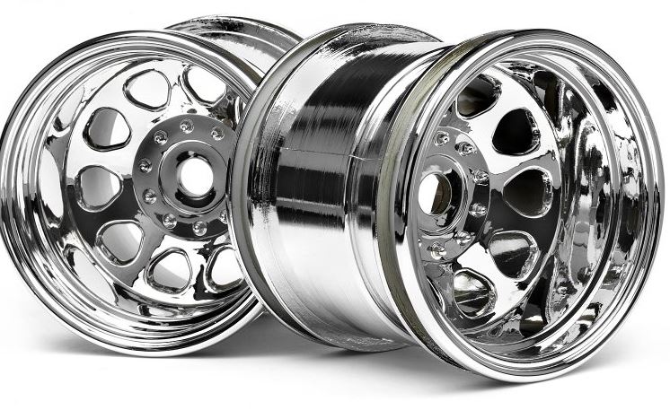

I haven't received a reply from HPI regarding the offset but I've confirmed through other sources that they do fit 12mm hex. Here's the list of vehicles they will fit from the HPI site:
THIS PART FITS THE FOLLOWING KITS / PARTS:
E-Firestorm 10T
Firestorm 10T 3.0
Wheely King 4x4
E-Firestorm 10T Flux
I'll check the offset once they've arrive and are fitted to the truck. If the offset isn't exactly perfect, I feel pretty confident that I can make adjustments via alternate hex drive thickness or maybe trim the back of the wheel if necessary. Based upon the photos I've seen, they appear to fit. I'll post an update later.

Anyway, for the TF2, I went ahead and ordered a full set of 2.2" HPI 3062 wheels with 12mm hex drive and should fit the truck just fine (I hope). They look similar to the Tamiya Bruiser wheels but don't require that funky 3-screw hub to mount them.

A little update: the HPI wheels have arrived and they look just like the photo I'd posted earlier -- chrome plating and overall quality are first rate! The fronts lightly interfere with the TF2's steering links so I'll switch to the thicker 5.5mm hexes that were also included with the TF2 kit. With the thicker hexes, there is no interference.
I can now go ahead and order the Pro-Line Trencher tires and finish the truck (it's been sitting in a box for 4 years :oops: ). Thanks everyone!!! :D
