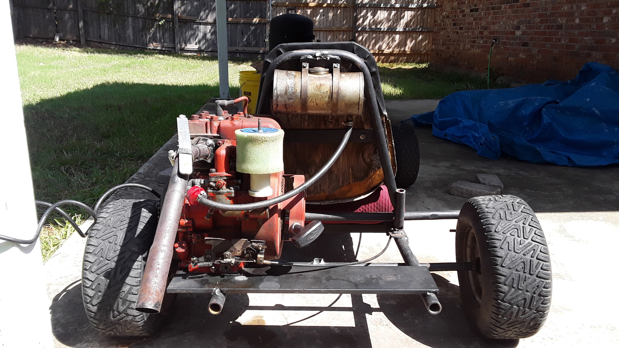

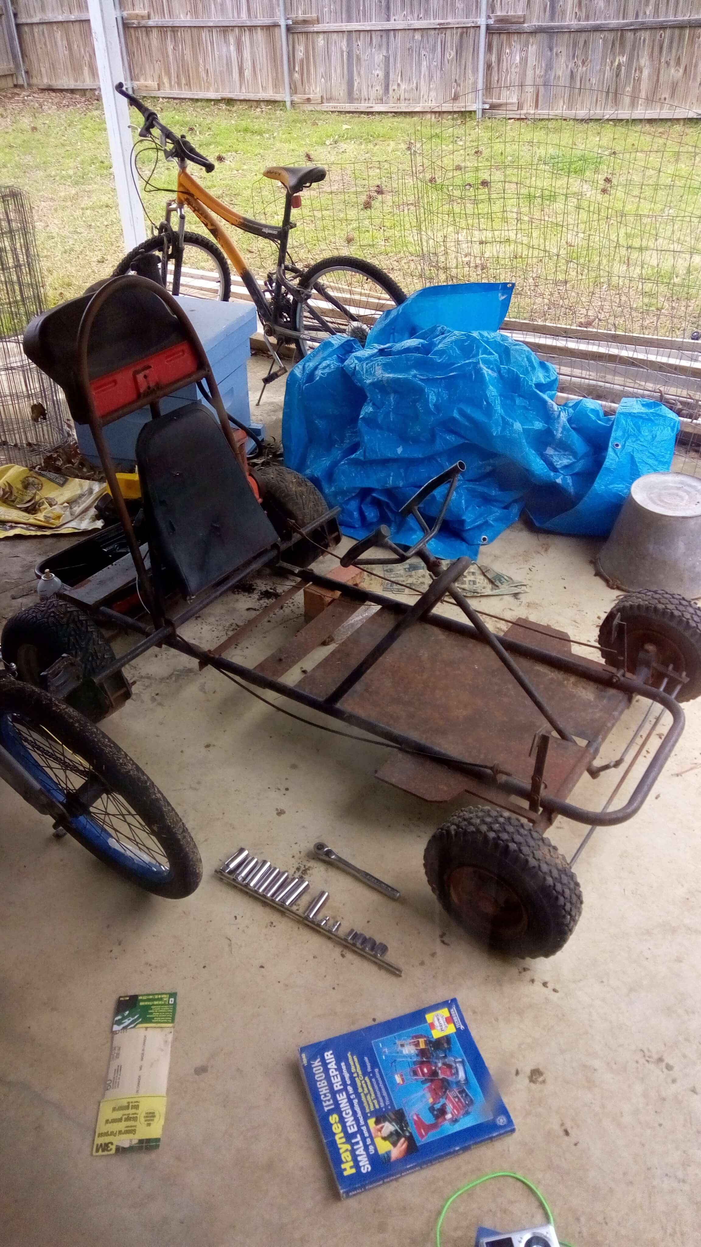

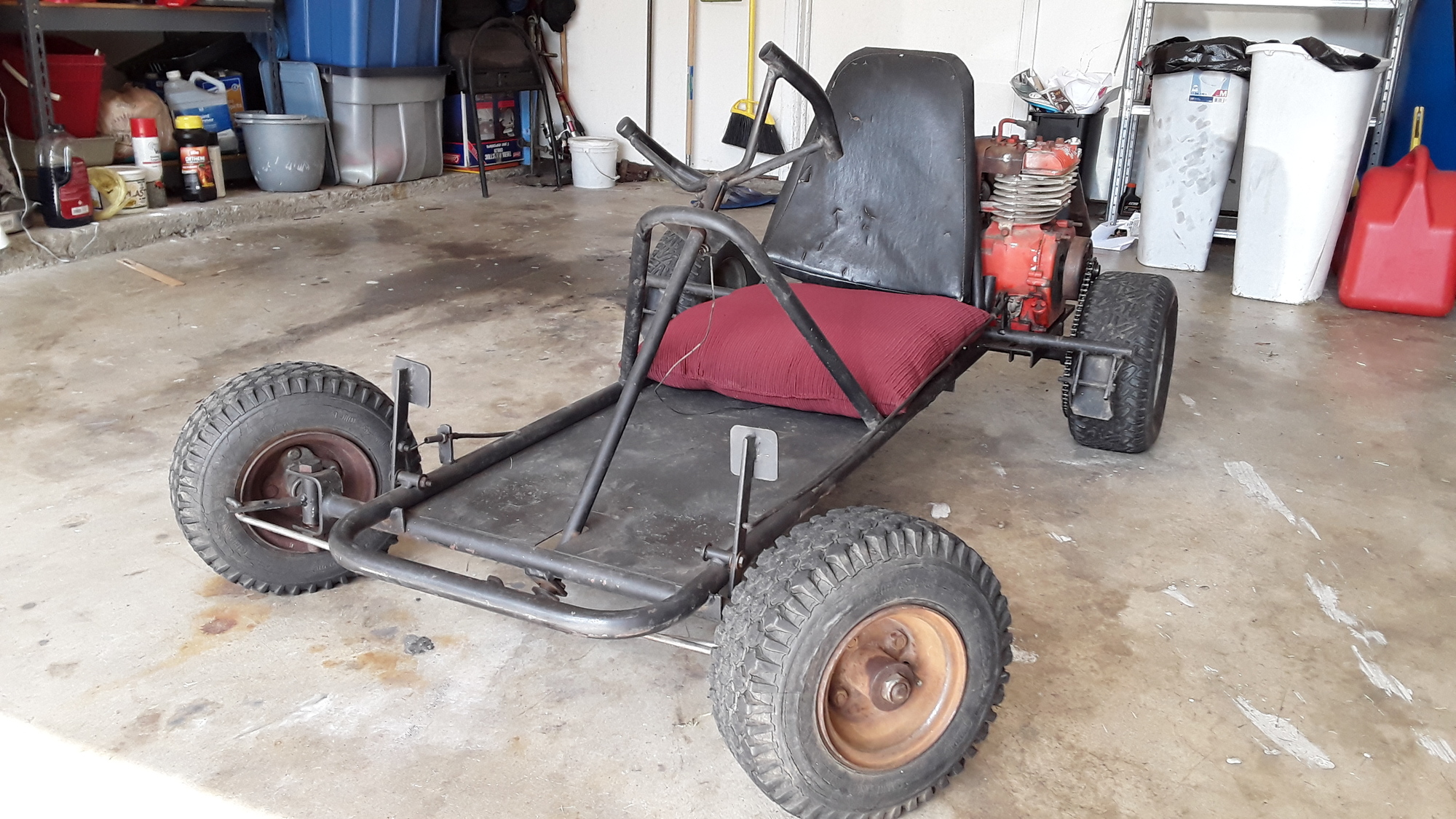

So I thought I'd share my precious go kart project with you guys. More info can be found at the DIY Go Karts forum here:http://www.diygokarts.com/vb/showthread.php?p=535987#post535987
I got this thing off Craigslist for $60 on New Year's Day this year, not really knowing much about go karts, and so with what little I knew, I got to work.
Whenever I looked up a question I had, the search engine would always direct me to DIY Go Karts, so I eventually joined, and that was an excellent choice.
It's a 70s Bird Engineering Starbird, a real classic in the world of go karts. It still has the factory original front wheels, tires, and seat back!!! 8)
It's powered by a 1985 Briggs and Stratton 5 HP flathead 4 stroke engine, that I hopped up with a racing header, and am currently upgrading with a racing connecting rod(so I can remove the governor and increase max RPM).
I sanded off most of the rust and redid the black paint in flat black. The previous owner modified it horrendously by doing stuff like adding a terribly ugly roll hoop(which I removed), so it feels good to give this classic a better shot at life.
First pic is the condition I got it in, and the others are the latest glam pics I took.
I have a series of videos on my Youtube channel that can tell the story much better than words alone.https://www.youtube.com/channel/UCQZBmyTrZ9dxpA2uFfEdDog
Enjoy. :D
