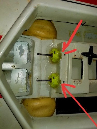

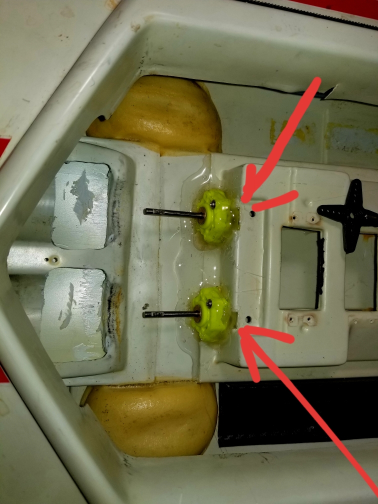

new direction. going old school .15 nitro with rc10gt clutch and gear setup to belt drive....this is the start...
bushing supports i made for the belt pulling the shafts together out of some ole monster truck planetaries i had laying around

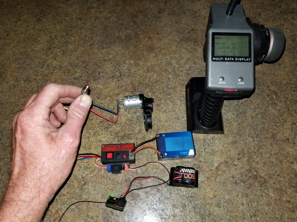

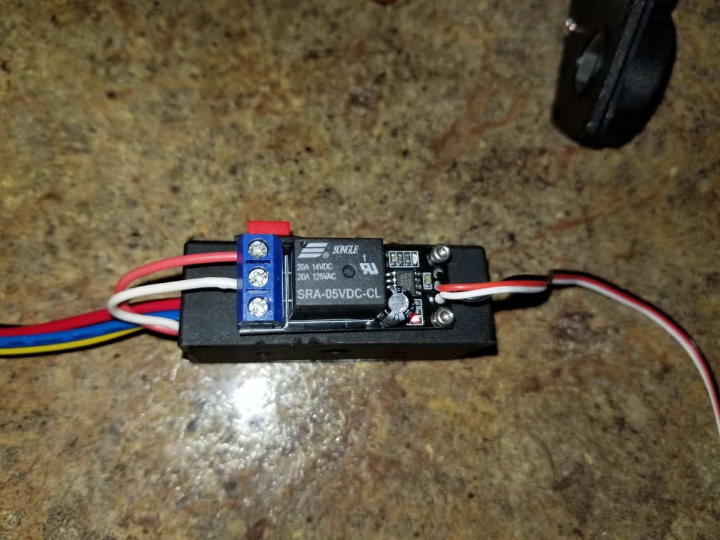

wired a remote receiver control switch to a Traxxas EZ Start control box
I have a vintage conversion kit comin from ebay that supposdely allows any vintage O.S. .12-.18 engine to accept the EZStart...but its not here yet
Now i can start the engine and light the glow plug from a flip of a switch on the transmitter as seen in pic below. (3rd channel)

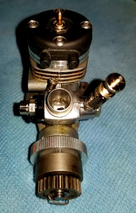

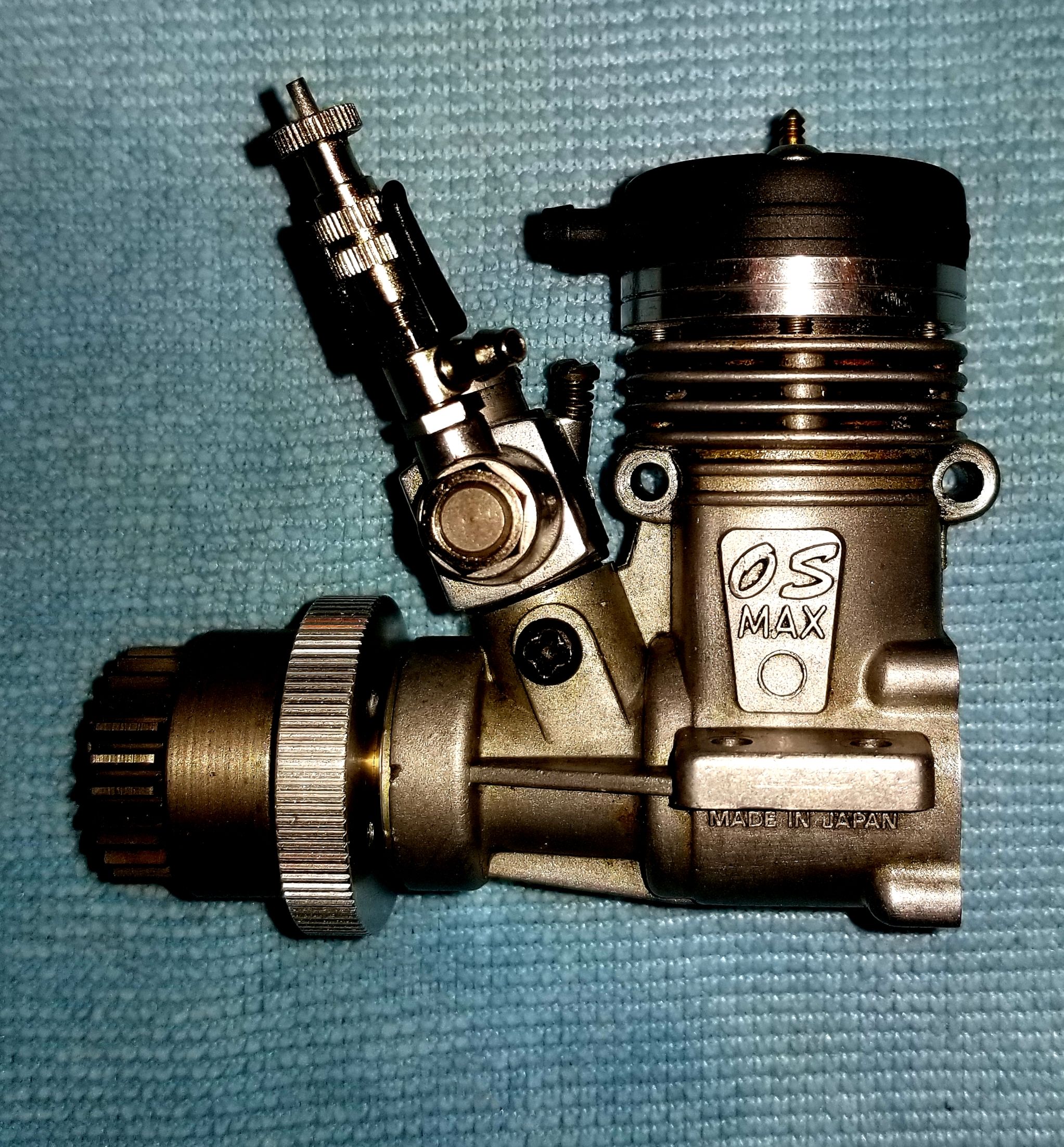

converted the vintage O.S. CZ-2 to marine duty....wasnt easy either. bought a .18 OS water cooled head but the button was about 3 mm too big to go onto the sleeve. i dont have a lathe or anything so i used a drill press to turn it down to fit. real tight compression! electric starter comin soon...waitn on parts
running and rc10gt 4 shoe clutch on this setup...i want the boat to sit in the water and not move while idling...i hate boats when the prop never stops turning. gonna dead hook this thing from a standing stop!
