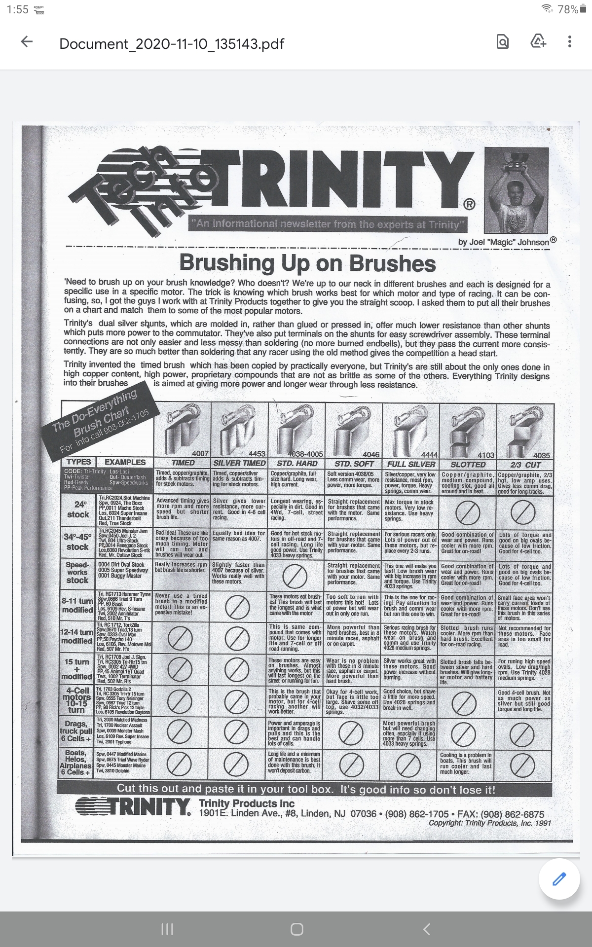

Here is a old Trinity brush chart. While you might not be able to find these exact brushes, it should serve as a good guide

juicedcoupe and matt1ptkn, thank you for responding—this is very helpful and I really appreciate it! Just ordered some medium tension Trinity springs and will look into brushes.
juicedcoupe, thank you for posting that reference from Trinity! Looks like the standard and slotted copper brushes will work for what I need (since I don't race). And as you mentioned perhaps serrated if I can find one.
