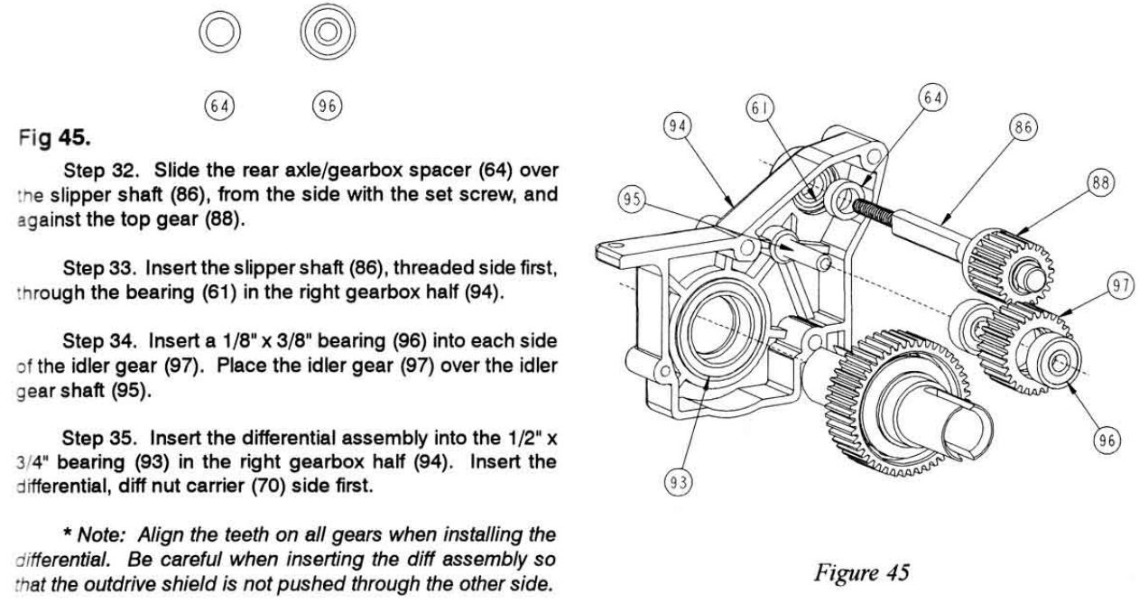

When I had my rc10t ( that went “missing” after the wife cleaned) I was going through my old pit box. I found my old hydra drive that was offered for the 10t. If memory serves, I didn’t like it and or didn’t know how to use it. Well, I have all the parts for it to make it complete. Think I used it just a couple runs. So I’m restoring a xxt, I’m pretty sure I can use it on the xxt right. The 10t needed an extended slipper shaft/ gear to make it work. What do I need to make it work on a xxt?

Hello Rlayman
The easiest and best source of information for Losi is Dan, AKA OldRC.com, SabulaTech and mytimac.
Again Dan is a business member here on RC10 talk and an awesome source of both knowledge and parts for Losi as well as other models.
I get most of my bodies from him as well as numerous parts.
The XXT owners manual with hydradrive instructions and part numbers are located on one of his sites.
That site is http://vintagelosi.com/Manuals_files/xxtmanual.pdf
