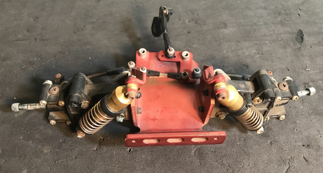

Post by BattleTrak »
Front end removed..
Note the increased rear track width and spacers..
Rear end assembly removed..funny how this massive structure was only fastened down by (4) 4-40 screws!
-Brad
