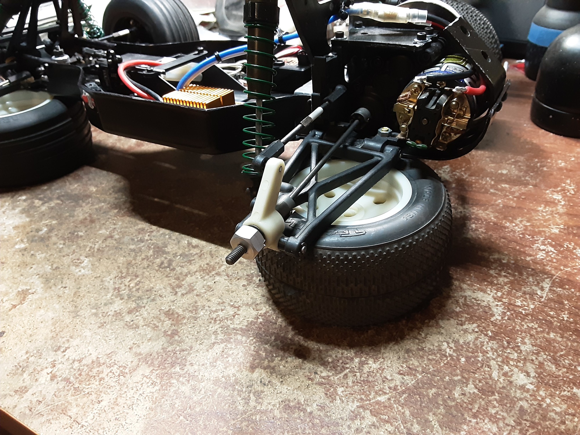

Looking at some of my other trucks, I decided to do a little parts swapping.
I swapped the wheels and steering assembly for the hex conversion on my white arm truck. I also took the opportunity to replace some of the turnbuckles and get rid of the yellow ball cups.
The front parts are from a Traxxas Stampede, with a little material removed from the caster blocks. The rear is Factory Works aluminum hexes for the 1/4" axles. I have used this setup for years on the other truck and plan to use the same parts on another.

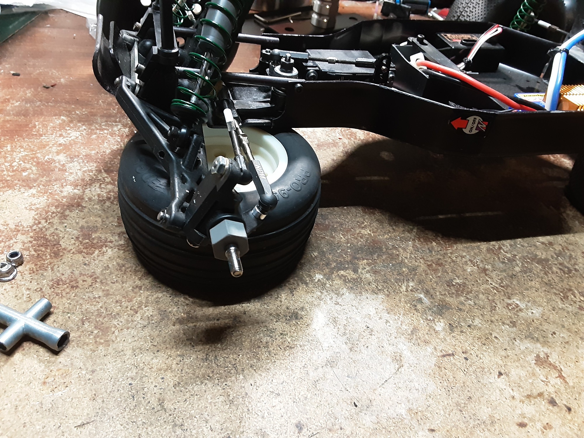

Just a quick update.
I decided against the JConcepts Mono wheels, I just couldn't bring myself to putting a modern looking wheel on a vintage truck. I chose a set of RPM Revolvers instead. I opted for the wide offset, 82063's.
Like all RPM wheels I've used, they are thick. With the Factory Works rear hexes, they don't leave near enough thread for a locknut. I'll be using a serrated nut with a little Locktite. I'm using M4 nut, opened up to 8-32.

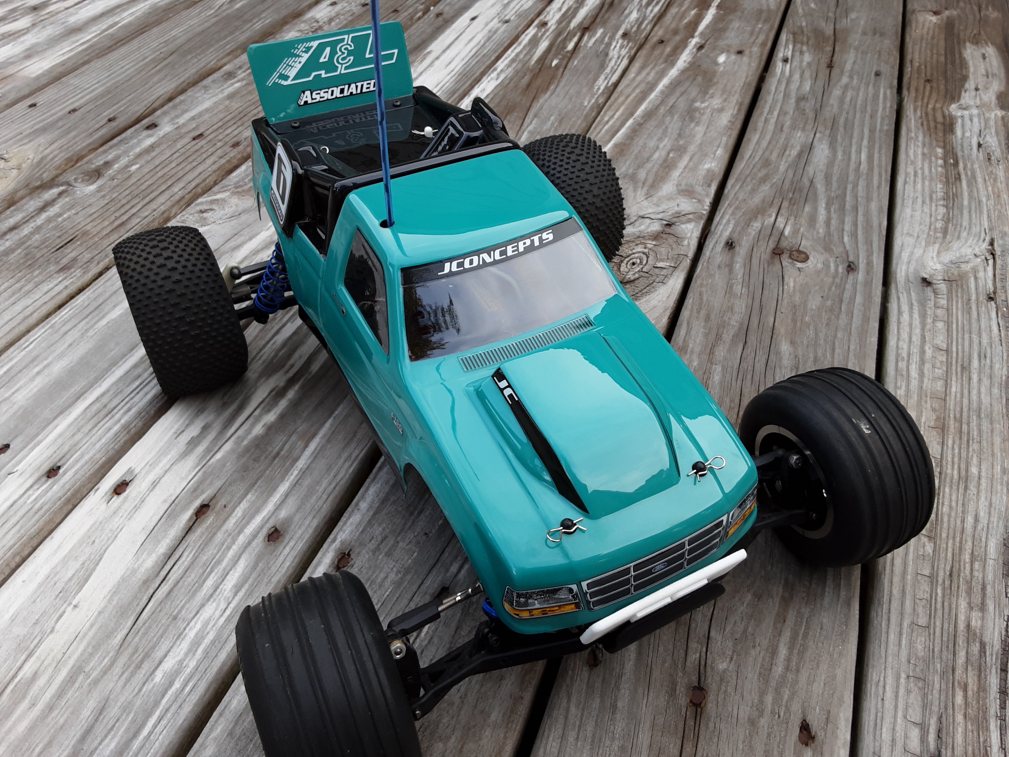

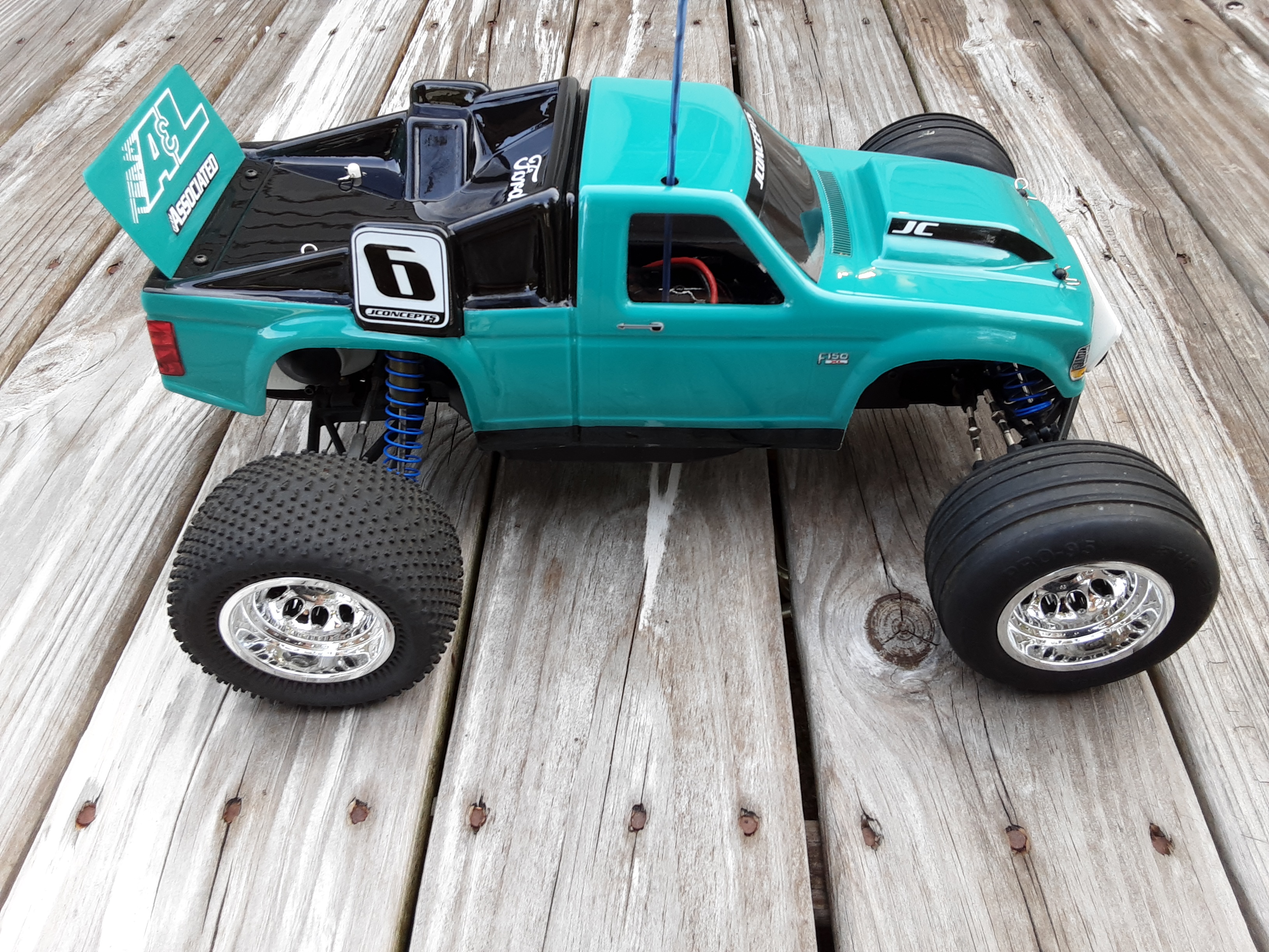

Finally got around to throwing some paint on this thing. It has been sitting with a clear body for a while.
The body is a JConcepts F-150. I chose the Tamiya cobalt green because I had a similar colored F-150 many years ago, the wheels were even similar.
I still kinda miss that truck. We got rid of it after hurricane Katrina, when gas was over $5/gal, and the truck got horrible mileage. Someone once asked me why it had two gas tanks, my reply was that it needs them.
