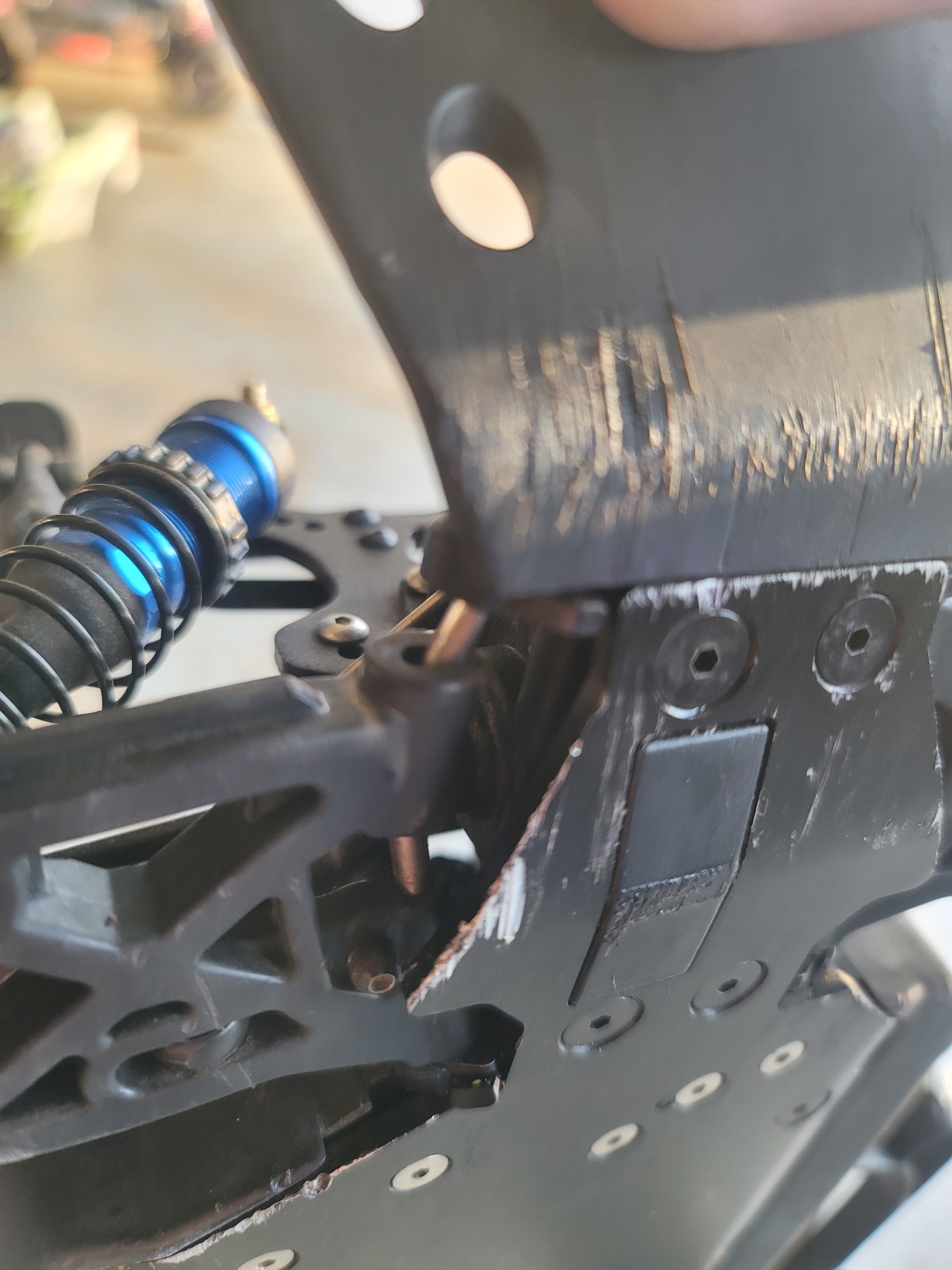

I got a practically brand new losi ten t scte nitro yesterday..
Ross. Everything.
I literally jumped it up my curb and bent my hinge pin and my chassis and threw everything outta wack..
Not what I expected for Quality when it comes from Losi but that's neither here nor there. My main question is what parts are compatible as far as arms and things like that go?
Thanks guys
Pics for reference and misery 😂😂😭😭

Search A Main or fleabay for Ten T arms. Identical.
Do the Traxxas EZ Start conversion. The final drive gear will strip in the Losi system.
You have to dremel a little off the crank button, I'll pull my truck down and shoot photos, if you want. There used to be a youtube video on how to do it, but I couldn't find it, just now.
RPM arms are a good upgrade, the rear bumper, too, just get the one for a Ten SCTE 3.0 or a 22SCT 3.0.
Such fun trucks, I am never selling mine!

You literally just answered every question I had..
Thanks man!

If you could do that with your truck, I'd greatly appreciate it!
I have 4 traxxas as well so plenty of parts for the ez start!
