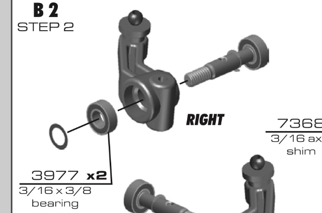

Visual comparison

With the dogbone cup removed, it would basically look like a 3/16 version of a Traxxas axle. FWIW, Traxxas vehicles don't use crush tubes on the axles. You just can't run the endplay as tight. Also, the bearings on a Traxxas (5X11X4) are much more substantial.
