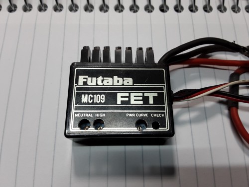

I did the normal Google searches and didn't find much.
Anyone know anything about it? Possibly a manual?

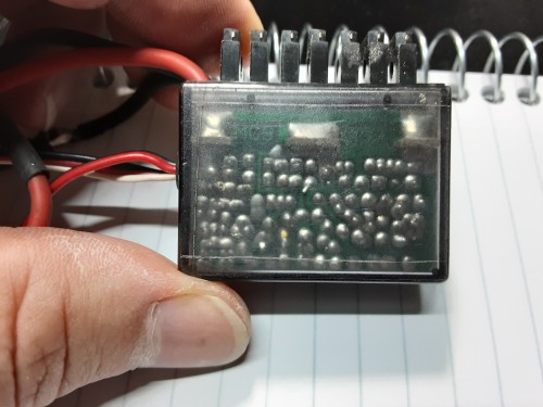

It came with a recent purchase and looks to be in good condition. Through the opaque case, I don't see any signs of damage.
Being a three wire esc, I know that its foreword only. But that's about all.

Nice esc & not easy to come by.
Released 1987, 150A/450A & rated at an 18T limit. 3 wire fwd & Brake.
I did have a copy of an MC110 manual, which is similar, on my laptop but lost it due to a knackered hard drive although they're straightforward to set up.

I figure that the neural and high set like my other older esc's. I assume that the power curve is a torque limiter.

Yeah, you have the setup pretty much sussed if you have other old esc's, setup is much the same as Novak/Tekin.

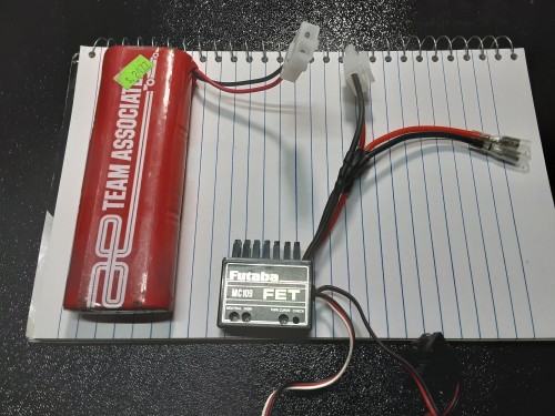

Fixed the wiring and replaced all the connectors. Wired it up and sure enough, it works. I didn't even have to adjust it. I don't know how well it will actually perform but I don't expect it to have a strenuous life.
I also put a new connector on the AE/ Sanyo 1200 SCR pack that I received at the same time. I don't expect much from it but it should look at home in a gold pan.
